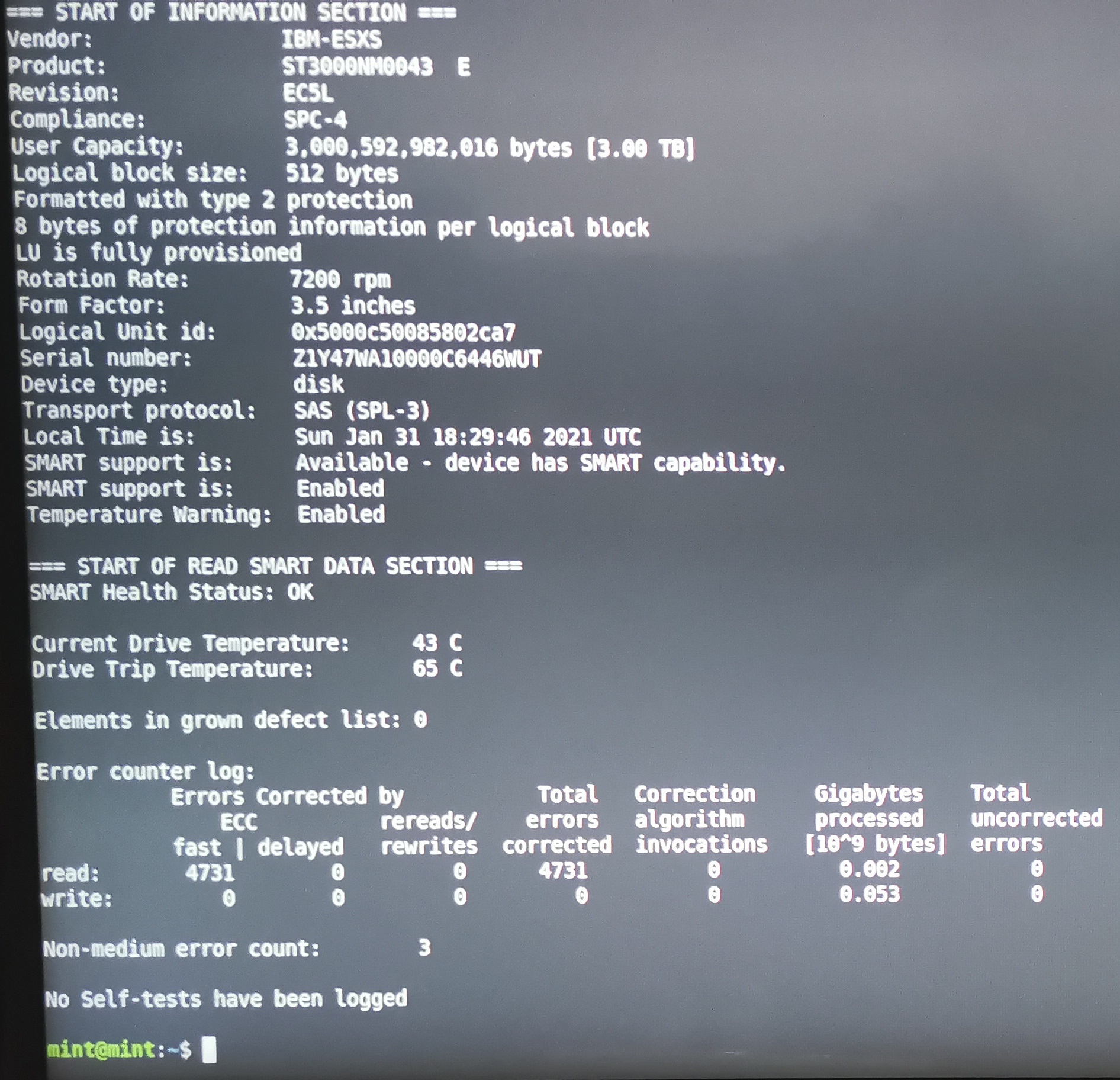

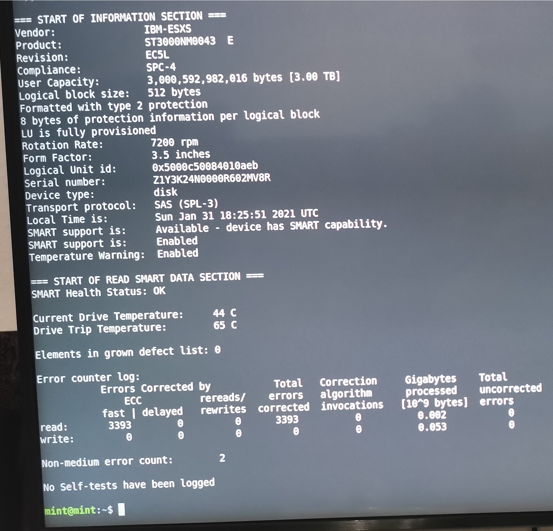

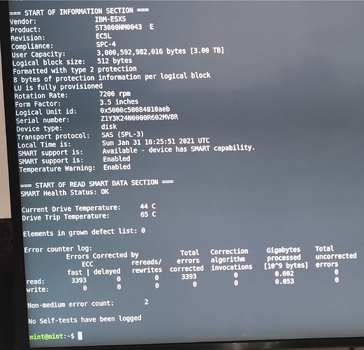

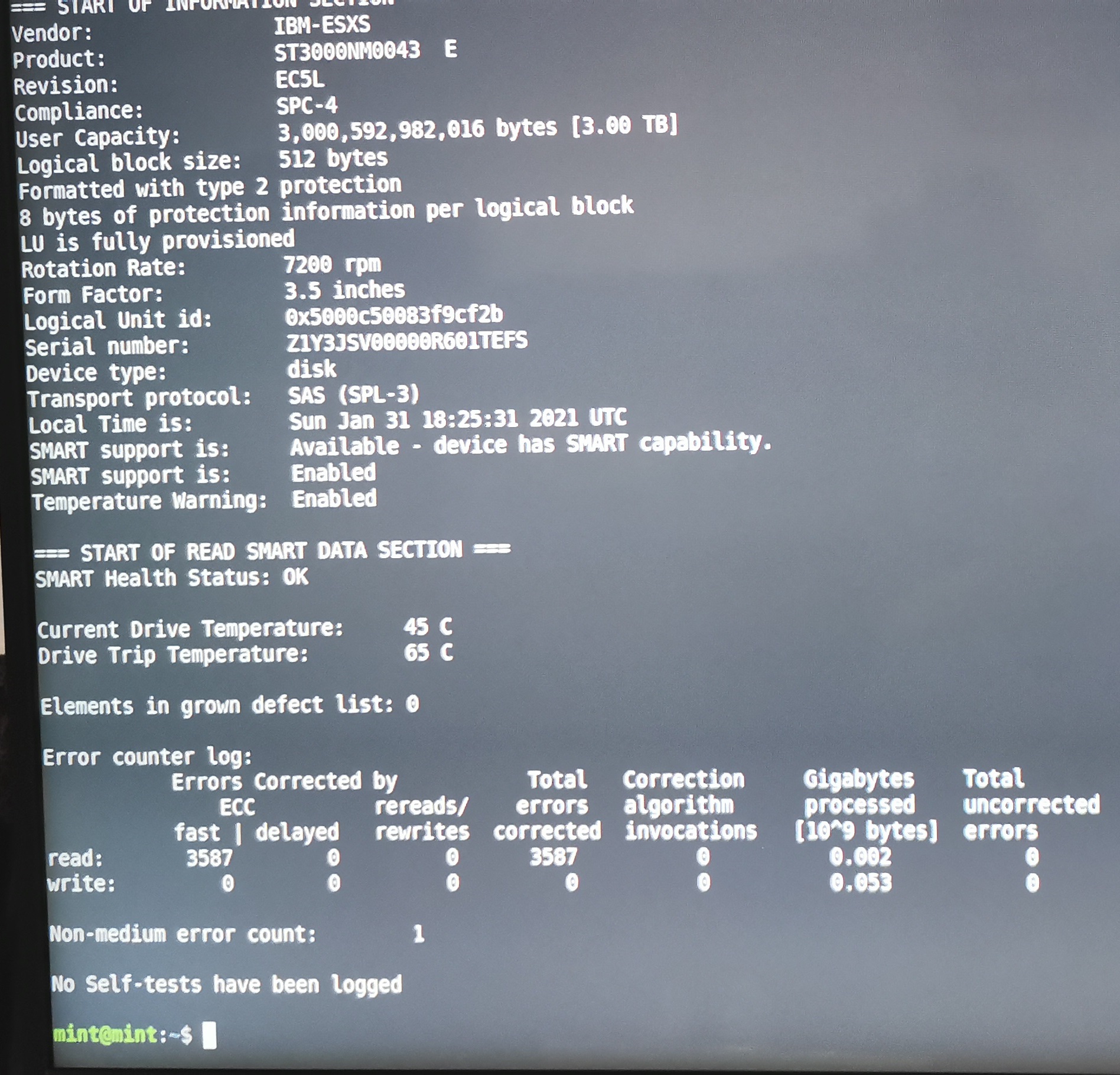

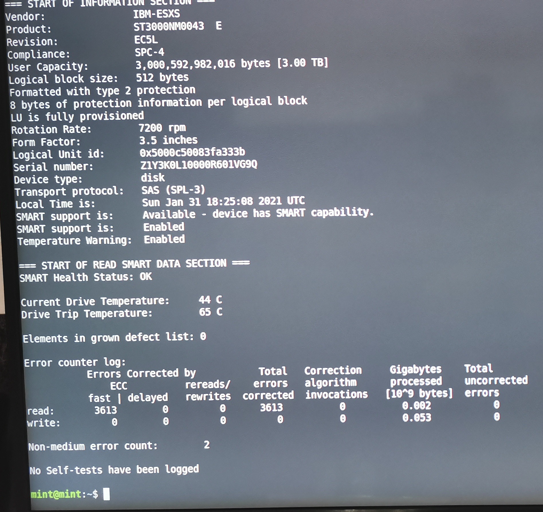

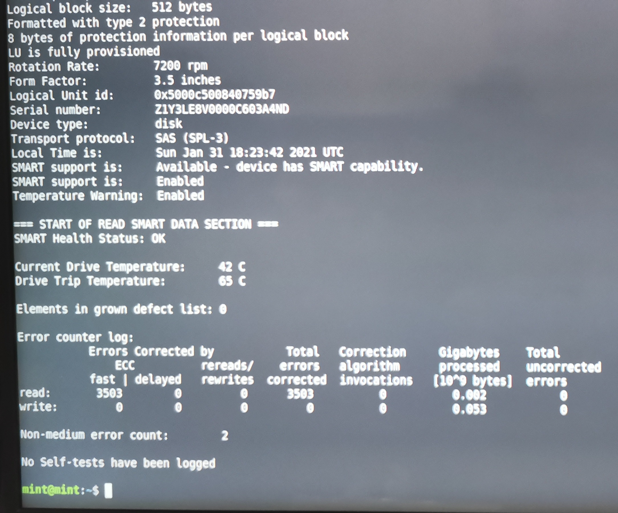

Was able to do some testing today. Unfortunately I wasn’t able to capture these logs as screenshots, so here they come as photos instead.
S.M.A.R.T. Values of Disk 1:
Image source: Metatr0n
S.M.A.R.T. Values of Disk 2:

S.M.A.R.T. Values of Disk 3:

S.M.A.R.T. Values of Disk 4:

S.M.A.R.T. Values of Disk 5:

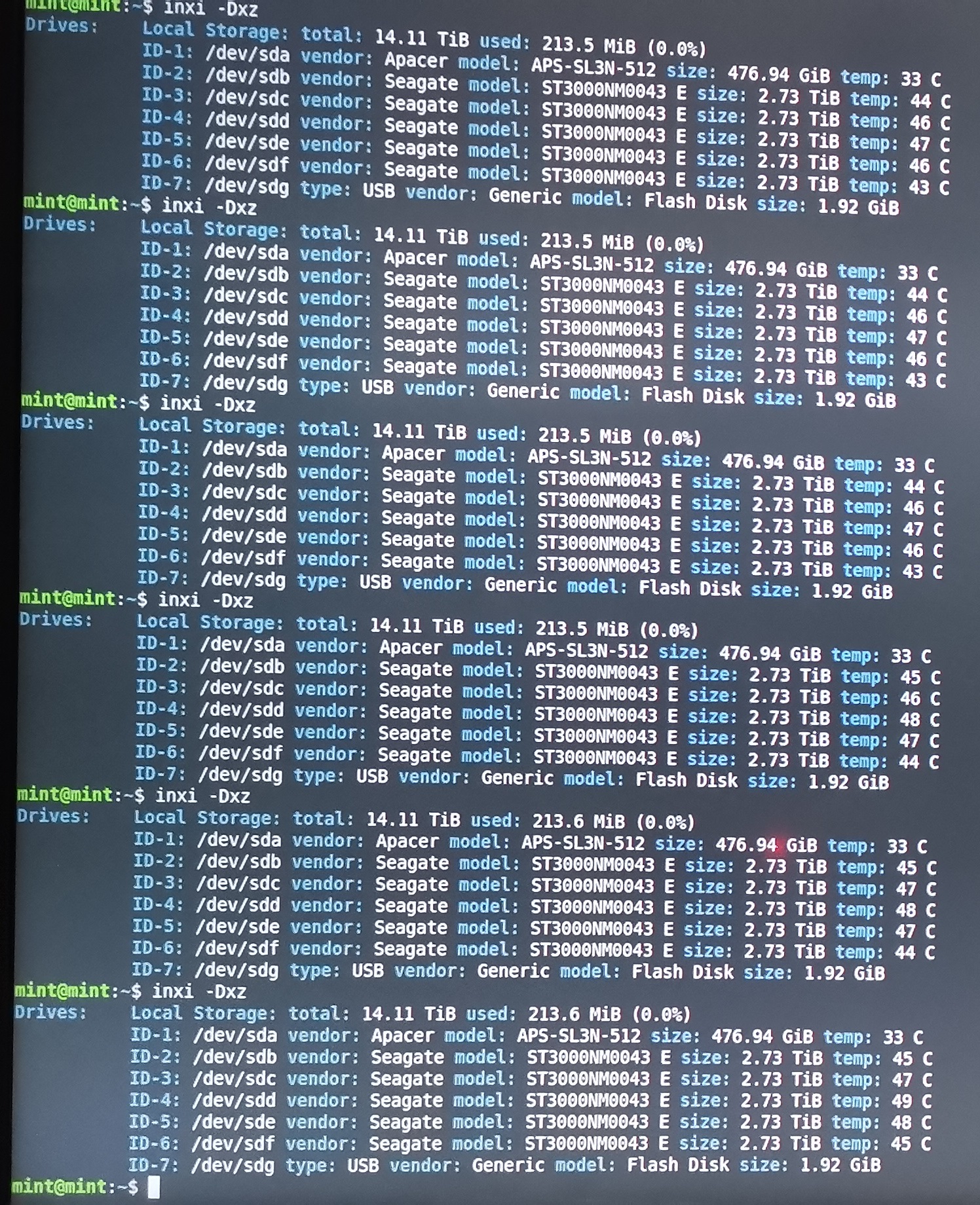

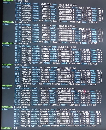

These are the temperatures after 15 minutes of heat soaking in 3-minute-intervals:
As you can see, disk 3 which physically is sandwiched between 2 and 4 almost reached 50°C.
Checked the BIOS fan-settings of the mainboard, manually set all fans to 100%, removed the dust filter from the front intake and was able to bring the disks down to 40°C.
I conclude that the intake fan doesn’t cut it and despite wanting a silent system, I have to compromise lower temps with louder fan-noise.
By the way, the clicking of the HDD heads ceased after idling for about 20 Minutes. It still returns on reboot but it doesn’t take 20 minutes anymore for it to stop.
Edit: Formatting
Those temps are totally within normal operating specs.
My unraid warning temps are around 54C and alert temps are at 58C.
Thank you very much for your support.
Up till now I always only worked with SATA drives which are attached to the MB onboard SATA controller and drive temps always were between 27°C and 32°C, depending on room temperature and load.
As long as self-encrypting SAS drives are in their comfort zone between 40°C and 50°C I will just leave it as it is. The datasheet of the ST3000NM0043 states that the drive’s AFR shall be reached at nominal case temperatures of 40°C and that the drives internal tripping point is set to 65°C drive temperature.
I will have to see where the temps end up on normal read loads.
