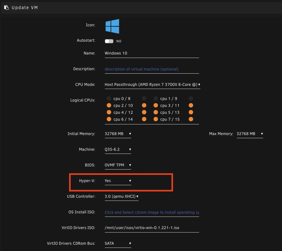

Here’s another example. As you can see, there is (maybe since 6.9 or 6.10) a simple option for Hyper-V.
Is this enough or should I use your replacement-code above instead?

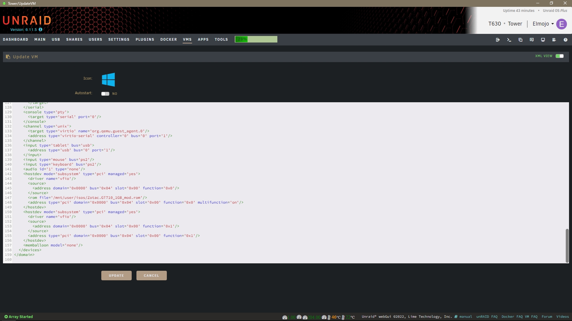

When I run through the guide, following it as best as I can, when I launch the VM, it just ignores the GPU completely. I don’t seem to be getting any passthrough at all. I can access it via RDP just fine, but device manager doesn’t show any nvidia devices. I have a GT710 installed, BTW.
Here’s my XML, do you see any issues?
