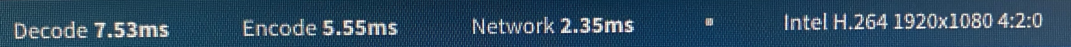

What does the parsec application say when you click on the button?
It should give you stats.
oh, ok, I’ll test it out later. You mean the Parsec logo on screen? While gaming? On the client?
Yep! That should show you those stats.
This without actually playing.

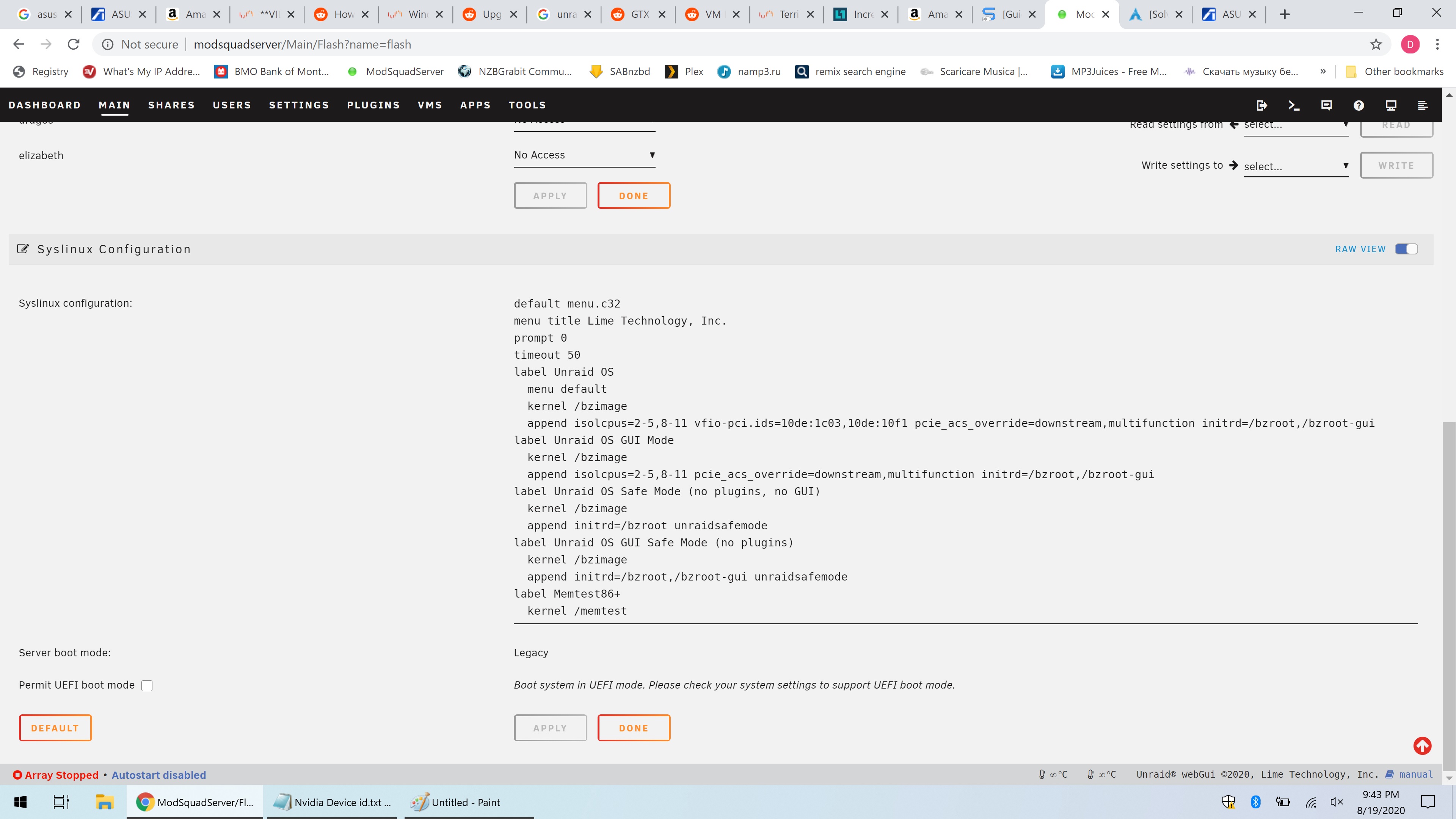

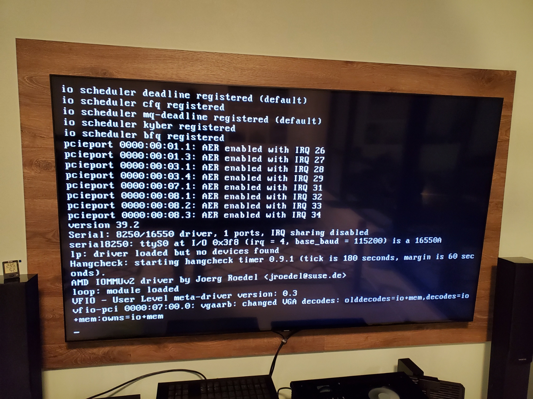

hoping someone can help. Ive followed it up until I edited the syslinux.cfg and rebooted the server and it would throw this error while Unraid was loading.

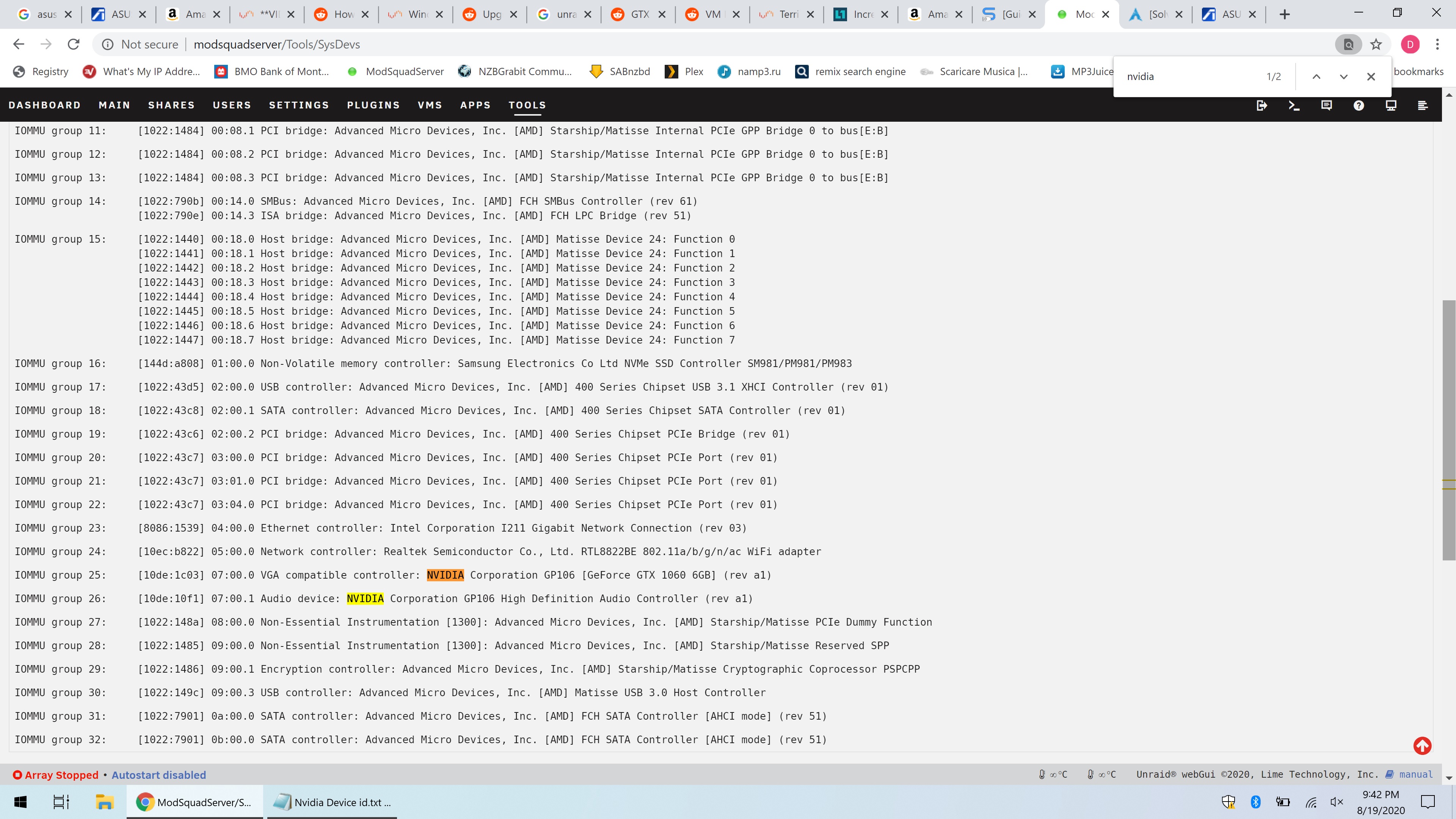

I have attatched a screenshot of my IOMMU Groups as well as Flash Config.
If anyone has any idea of where to go from here or what could be causing the issue, any feedback would be appreciated.
Thank you,
Dre
