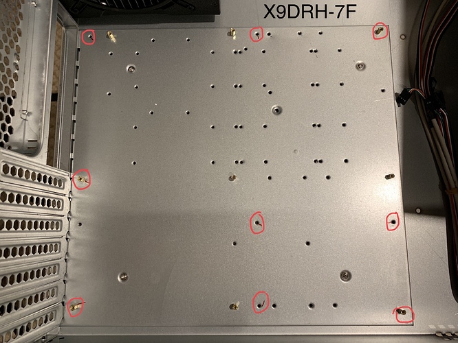

Here is the proper layout for the Rosewill L4500 case using the Supermicro X9DRH-7F motherboard.
Standoffs should only be located where circled in RED
Remove all the others (Stock locations appear in this photo.)

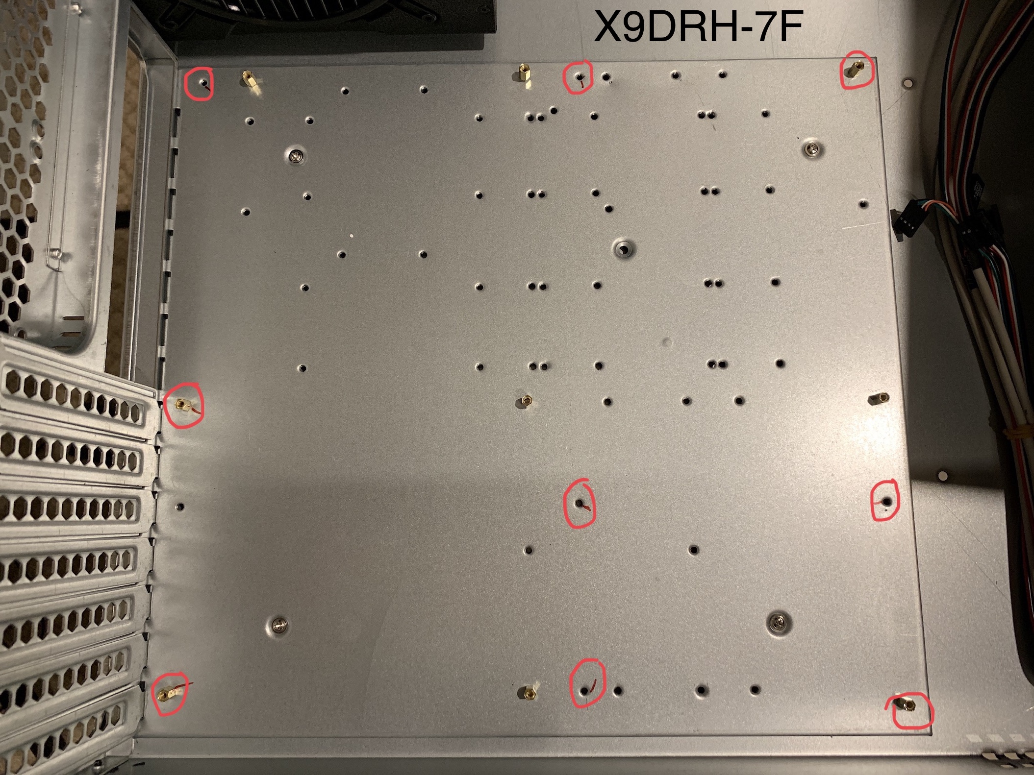

And even after following this image check your damn standoffs twice more!
Your motherboard standoff locations were bang on. Measured just because I am paranoid, but the board fit perfectly. Thanks for the photo!
You did it the right way. Always measure it yourself. Glad the photo helped!
