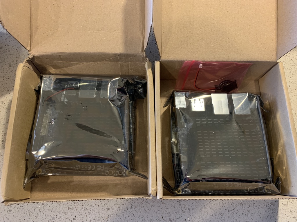

Two orders in 5 boxes.

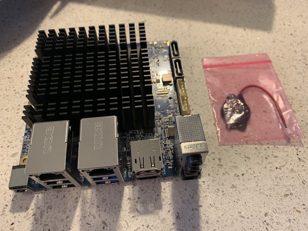

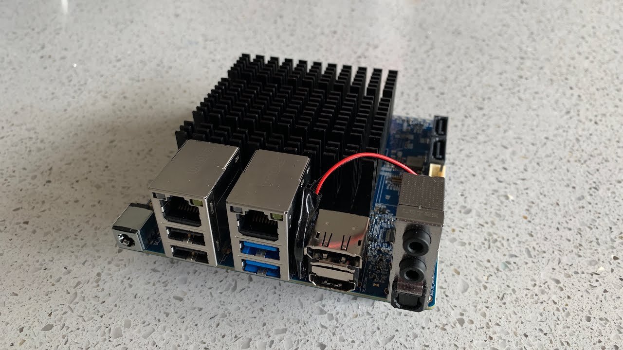

Odroid H2+ with CMOS battery
It’s a very pretty piece of kit.

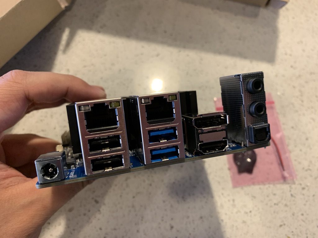

Dual 2.5 GbE NIC, USB 2.0, 3.0, DisplayPort, HDMI, onboard audio w/ optical output

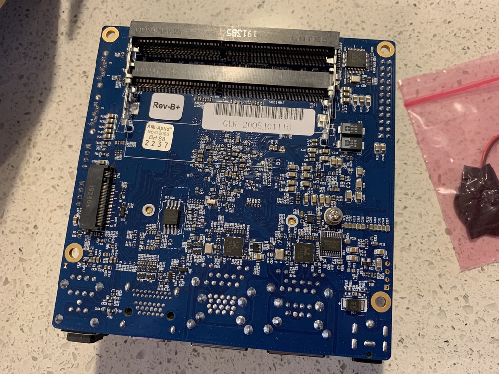

Backside of the board
M.2 NVMe 2280 slot w/ 2xDDR4 SODIMM slots

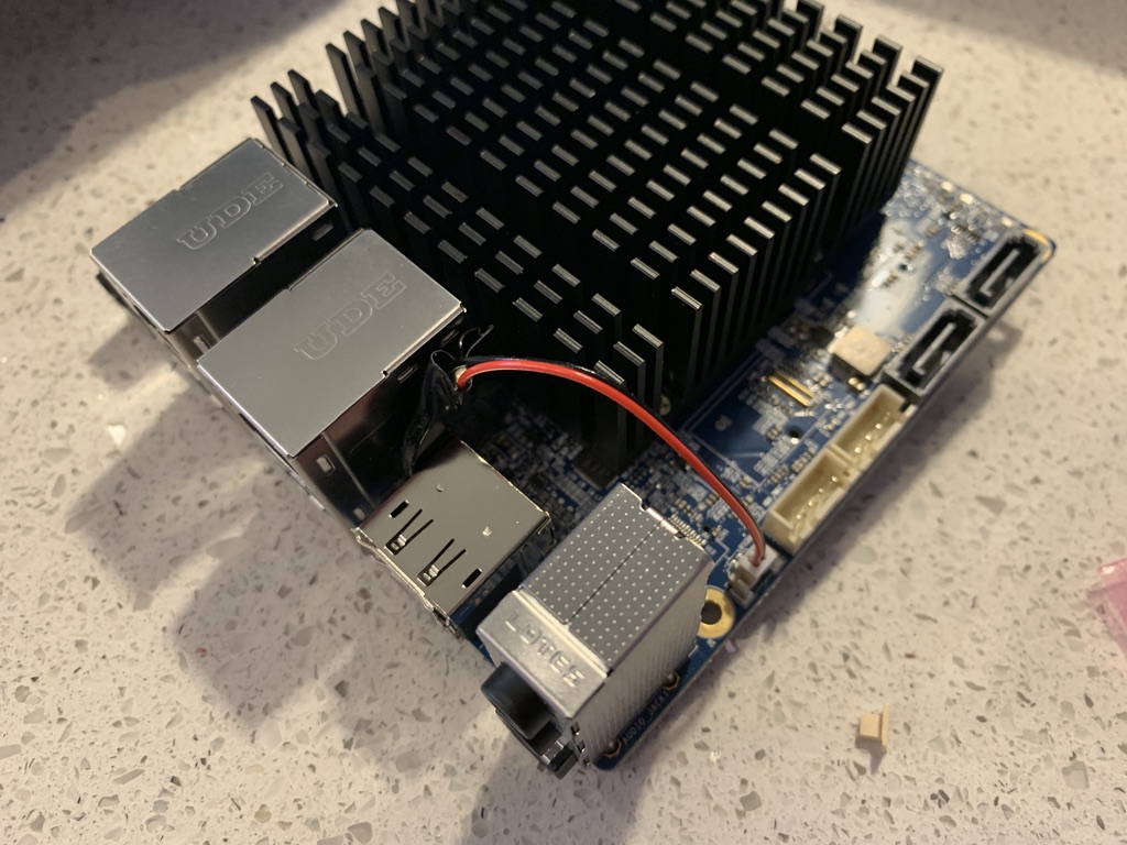

Bios battery installed
inb4 someone uses the included cardboard box as a case for this thing…

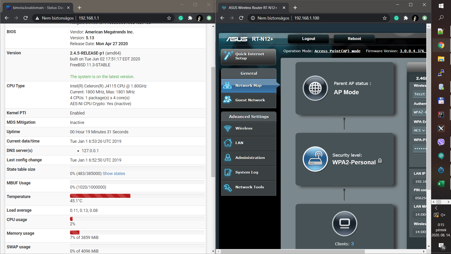

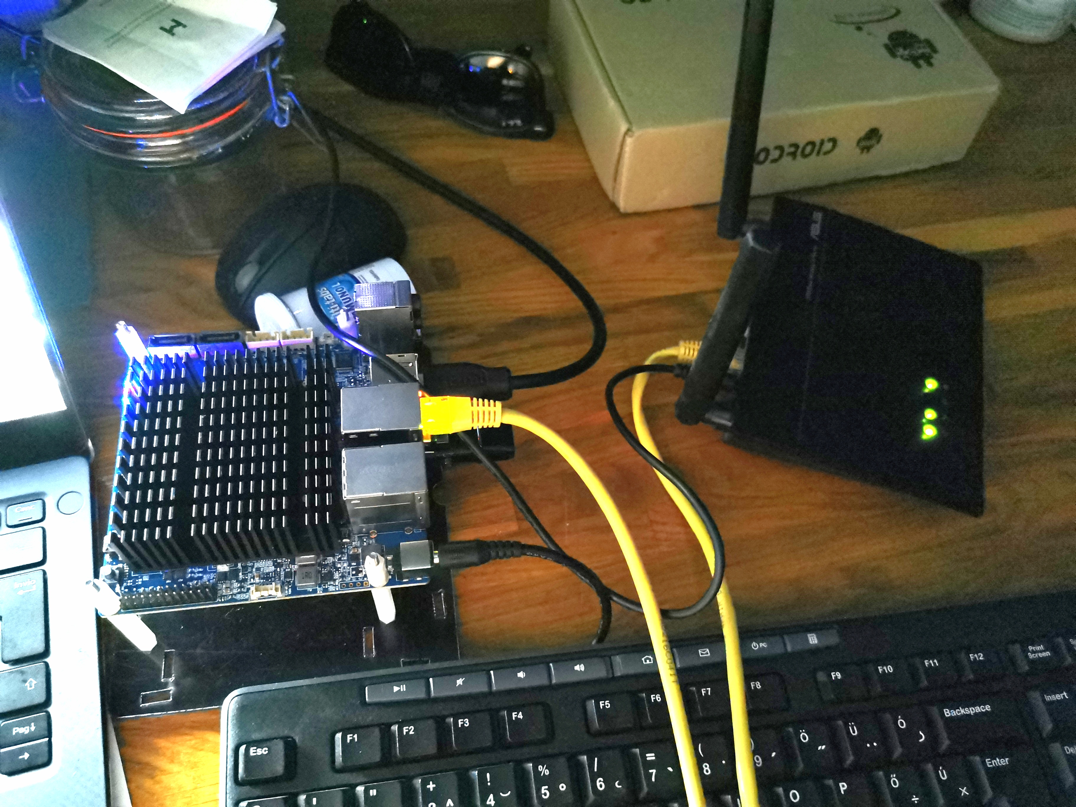

Found the compiled driver for freeBSD for the 8125 NIC, it works flawlessly so far.
It was so easy to make this work, that I did not believe first it actually worked. All I had to do, was to copy the driver to /boot/kernel and add a line to a config file
And since my laptop does not have an ethernet connector, I had to get the old Asus wifi router from the attic to use it as an access point to configure pfsense
Tomorrow will test with wired gigabit internet and 2,5 Gbit switch on lan. Based on other user’s experience I expect that it should put out around 1,1-1,7 Gbit on lan, and 900Mbit on the Net. But the main reason I got this was to build a site to site VPN with my old Roomie for share our media library and for me to create an offsite backup on his server.
