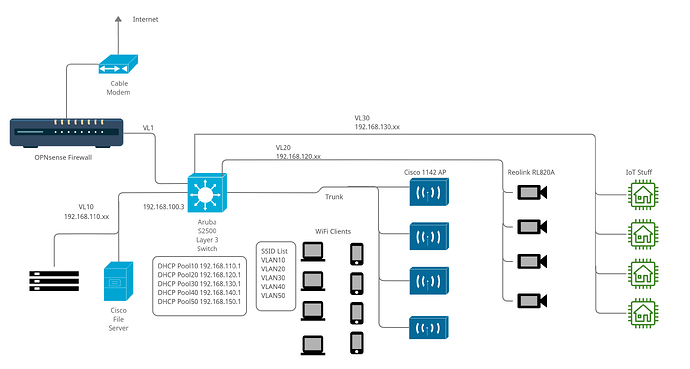

Here is what I am trying to create:
Hi Bill,
Yes that’s certainly doable with the S2500; though its L3 capabilities are somewhat limited compared to many other switches. Static routes to each VLAN should be automatic once you’ve created IPs for the switch on each VLAN. You can check with ip route
. On the switch, you’d need to add a default route via OPNSense’s VLAN1 IP, so the switch knows how to reach the internet. In addition, configure the DHCP server to send DHCP clients an option setting their default route to go via the switch’s IP on their VLAN. DNS would need to be configured separately (e.g., on OPN), so you’d probably want the DHCP server to assign static leases. The switch itself needs to have an upstream resolver configured, either manually or via DHCP from OPN over VLAN1 (you’d let OPN run the DHCP server for VLAN1, and let the switch be a DHCP client on that VLAN). And again, tell the S2500’s DHCP server to tell clients to use itself as DNS server.
I actually don’t do this (yet) in my own homelab, even though I have a fancy 40Gbps L3 switch with BGP, VRF, and all that jazz. I use the switch purely at L2, routing everything through OPNSense, and design the VLANs to minimise inter-VLAN traffic. The switch is assigned one IP (via DHCP) just for management. The port for OPN is a trunk with all VLANs tagged, as are AP ports. DHCP, local DNS, and inter-VLAN firewall rules are handled by OPN. The switch config is pretty simple this way, and it’s what I’d recommend to start out with.
Thanks Sean. I will take all this in and play around more today.
