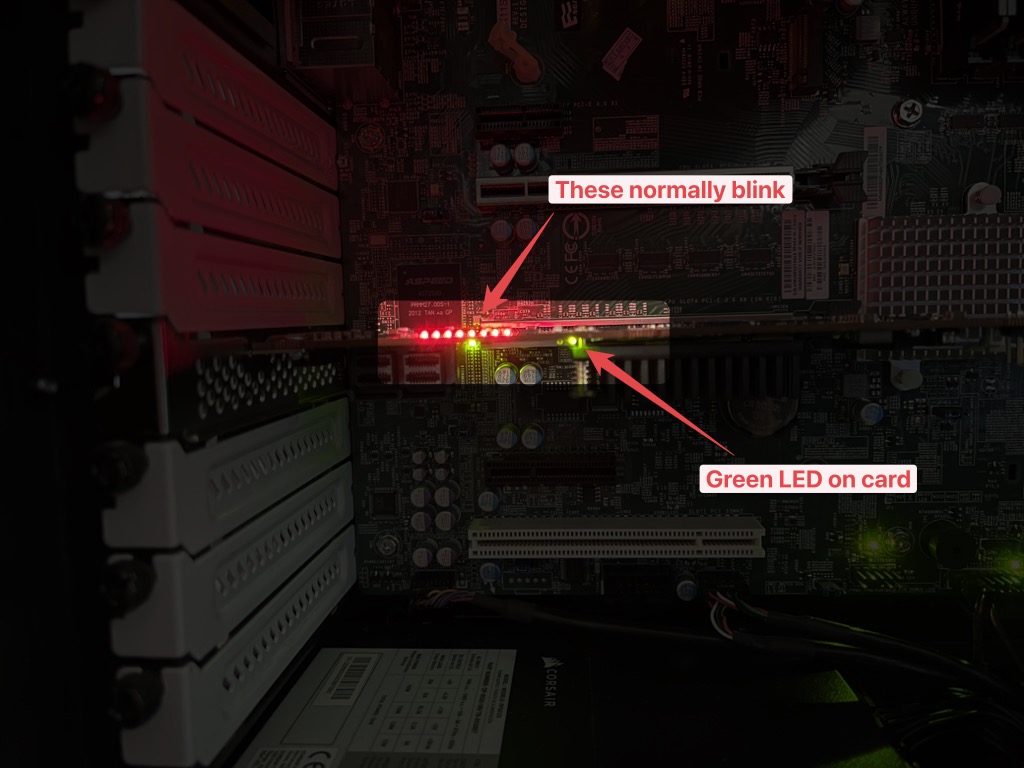

Anybody run into issues with the ASR-7805 Adaptec on a X11SCA-F motherboard? Any ideas or help is appreciated.
As soon as I add the Adaptec card, the system does not want to boot, no beeps, nothing and the orange LED next to the CPU turns on. Without the card, the system boots fine.
The red LEDs on the adaptec card remain static, and do not blink.

Turns out the first card was broken, I replaced it with a different one which is now working flawlessly.
