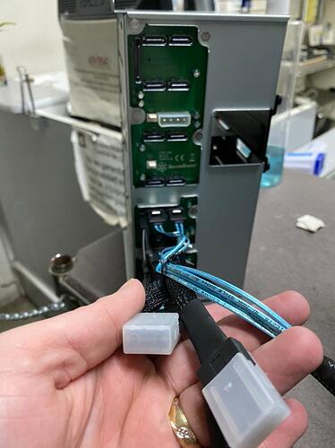

@cobalt or @LivePono what cable do I need to buy to connect the fan of the SAS HBA? I donāt have that Y cable youāre talking about.
Last thing; how do I power all of the hard drives? am I missing more stuff? lol
if for some reason none of the Noctua fans for the DS380B or the smaller one for the SAS HBA didnāt come with a Y splitter youāll want one of these. You plug it in to the CPU fan header. The CPU Fan goes in to the side with all 4 pins. Then youāll want an extension to plug in to the other side of the Y cable like this. You can route the extension out from under the backside of the plastic shroud that sits around the CPU Heatsink and Fan assembly so that you can plug the fan on the HBA in to it easily.
As far as the drives go you just plug 1 Molex and 3 SATA power connections in to the back of the DS380Bās backplane from the PSU you should have added to the DS380B.
