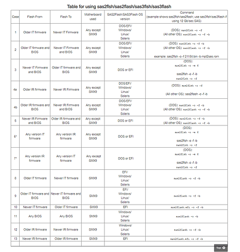

Here is a USEFUL link from Broadcom,
link
Please be mindful of
FLASH & FLSH
Here is a table from the link, please refer to the link for more details.
