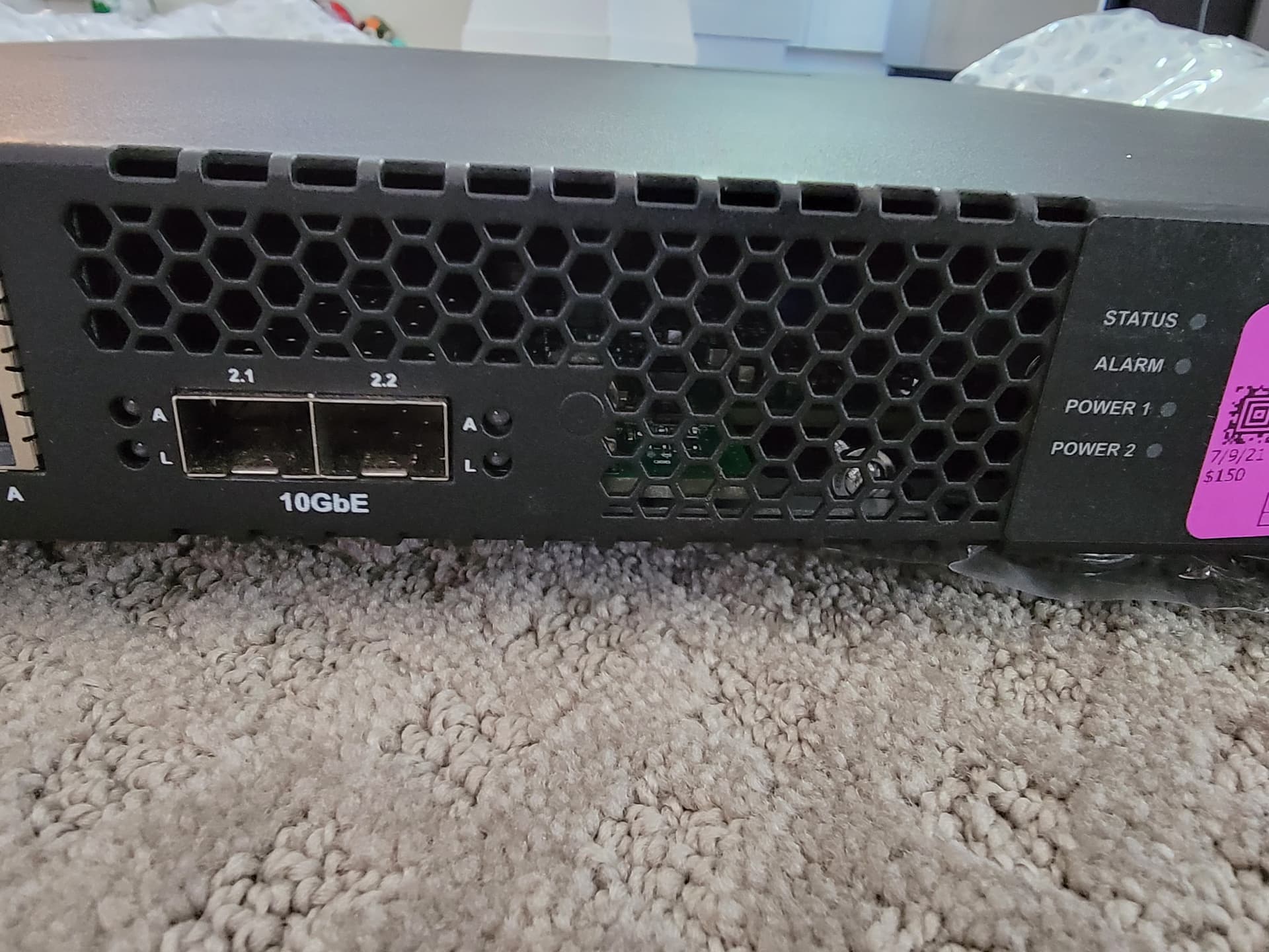

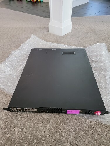

just picked up one of these, seller accepted $75… I like that it has 2 SFP ports
anyone have any experience with these?
Isn’t that just a switch? Are you confident that there’s computer hardware inside?
This is the specs I was going by, quad core xeon with 8 threads, 16GB RAM and 500GB HDD
Fingers crossed

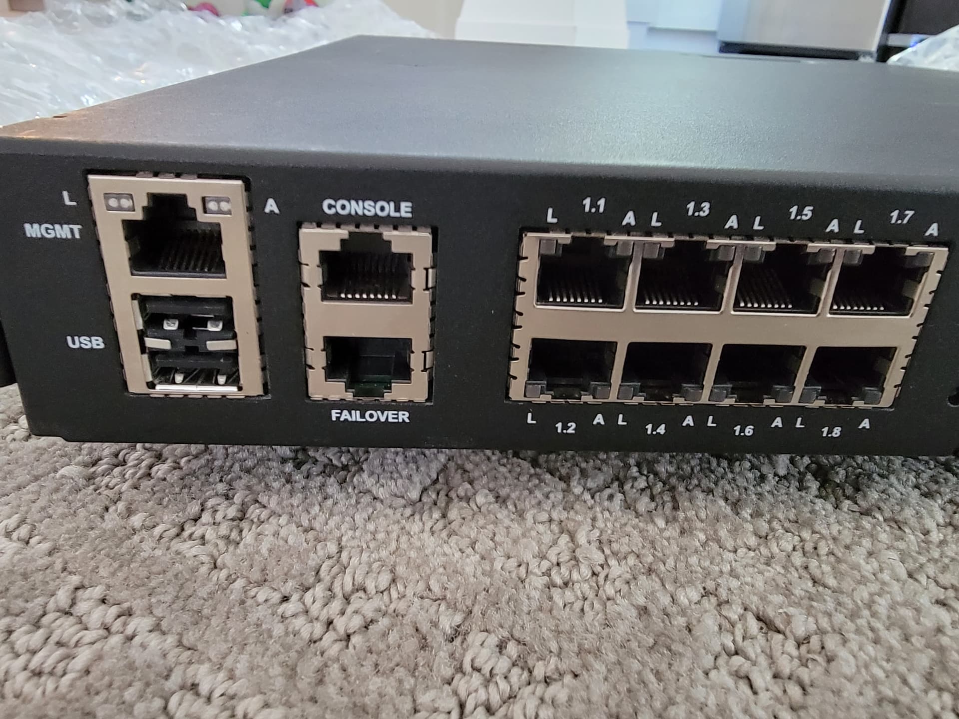

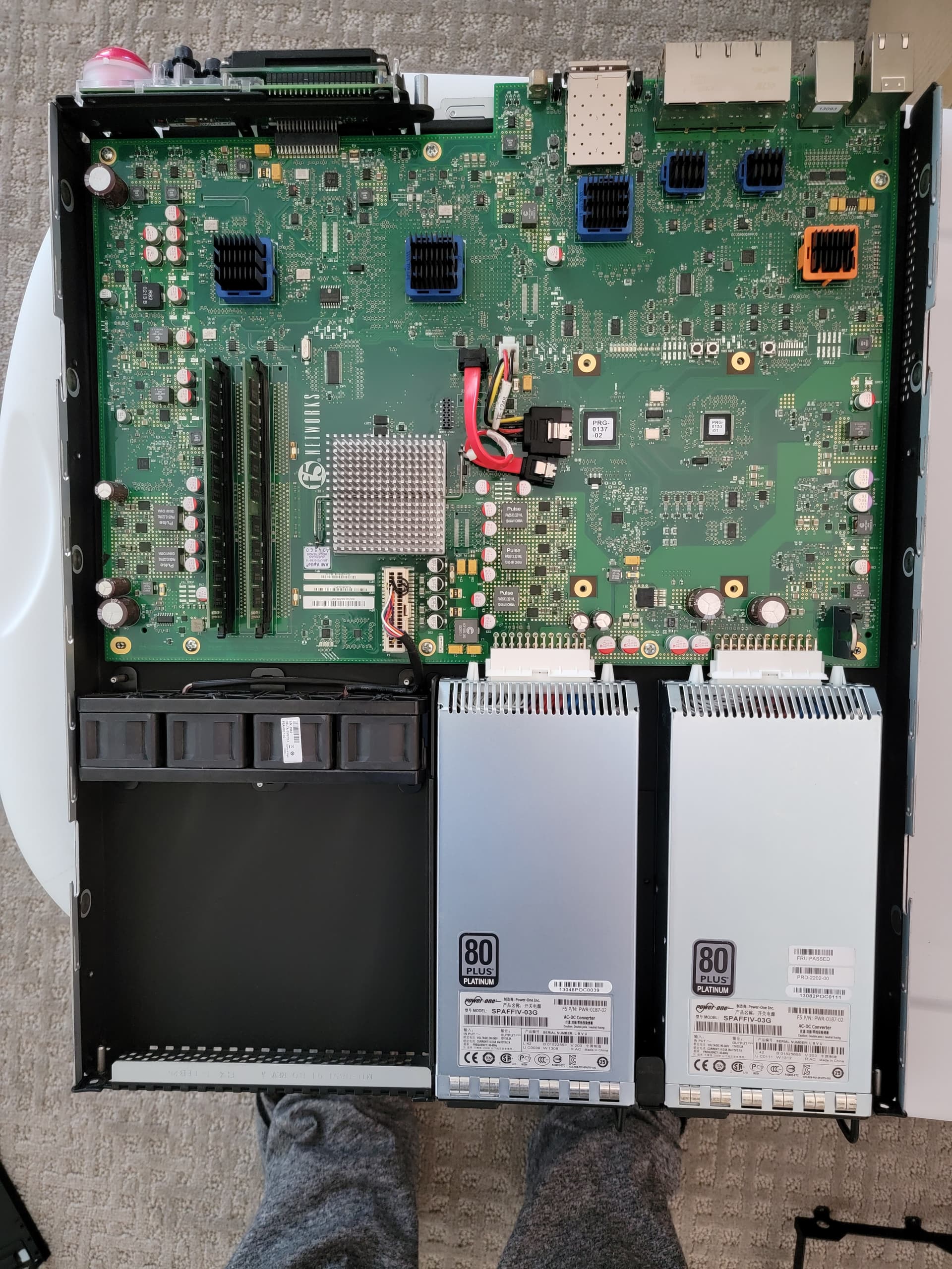

Just got my F5 Big IP 4000 in… heavily disappointed not too sure how there could be a quad core zone under that heatsink.
Positives are that it did come with 2 sticks of 1600 8gb of RAM and Platinum power supplies which are nice…
Will have to inspect it a bit more when I have time.
What heatsink are you referencing? If you’re talking about the one you can see through the grate, it’s probably for the 10Gb networking…

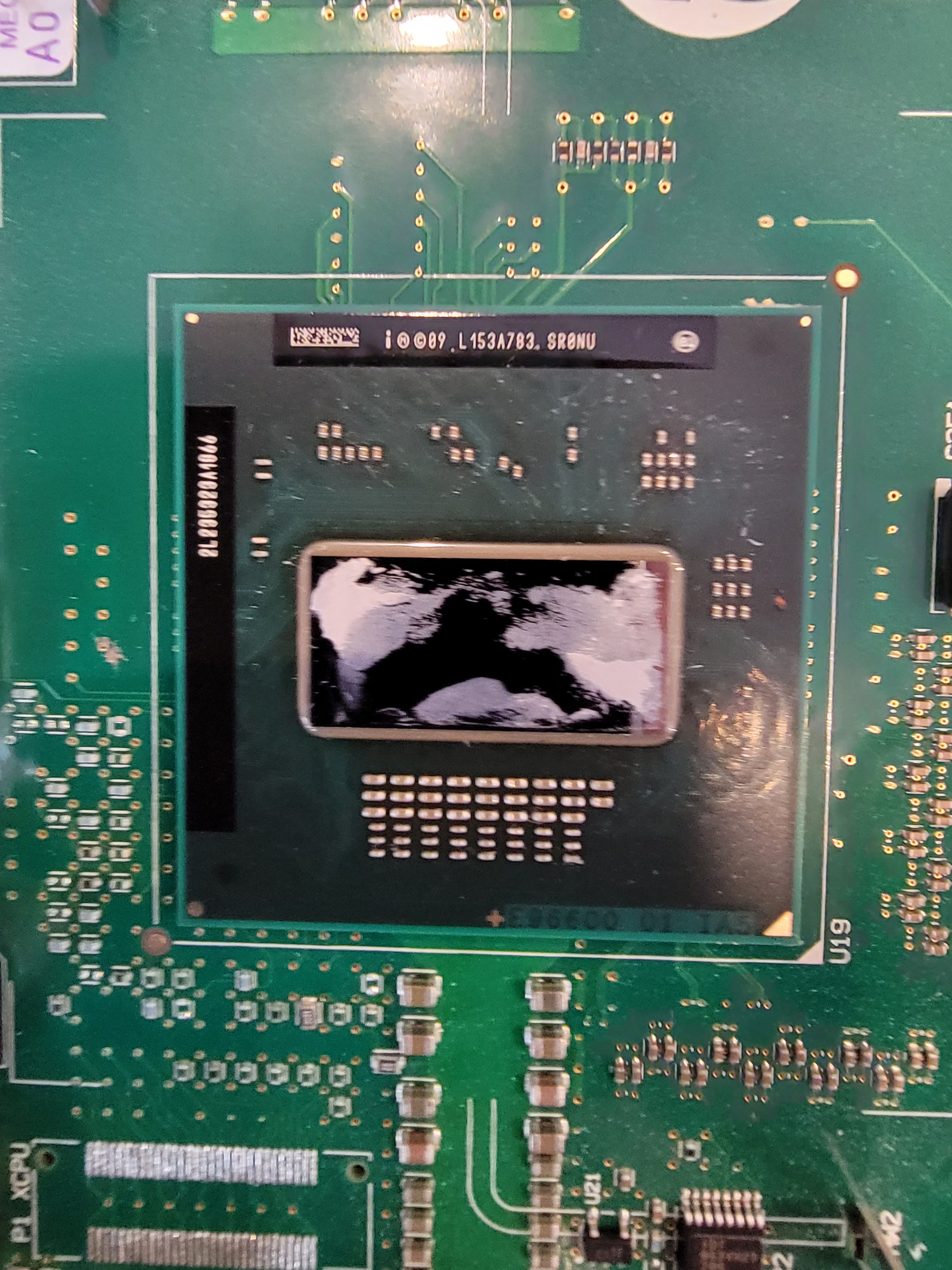

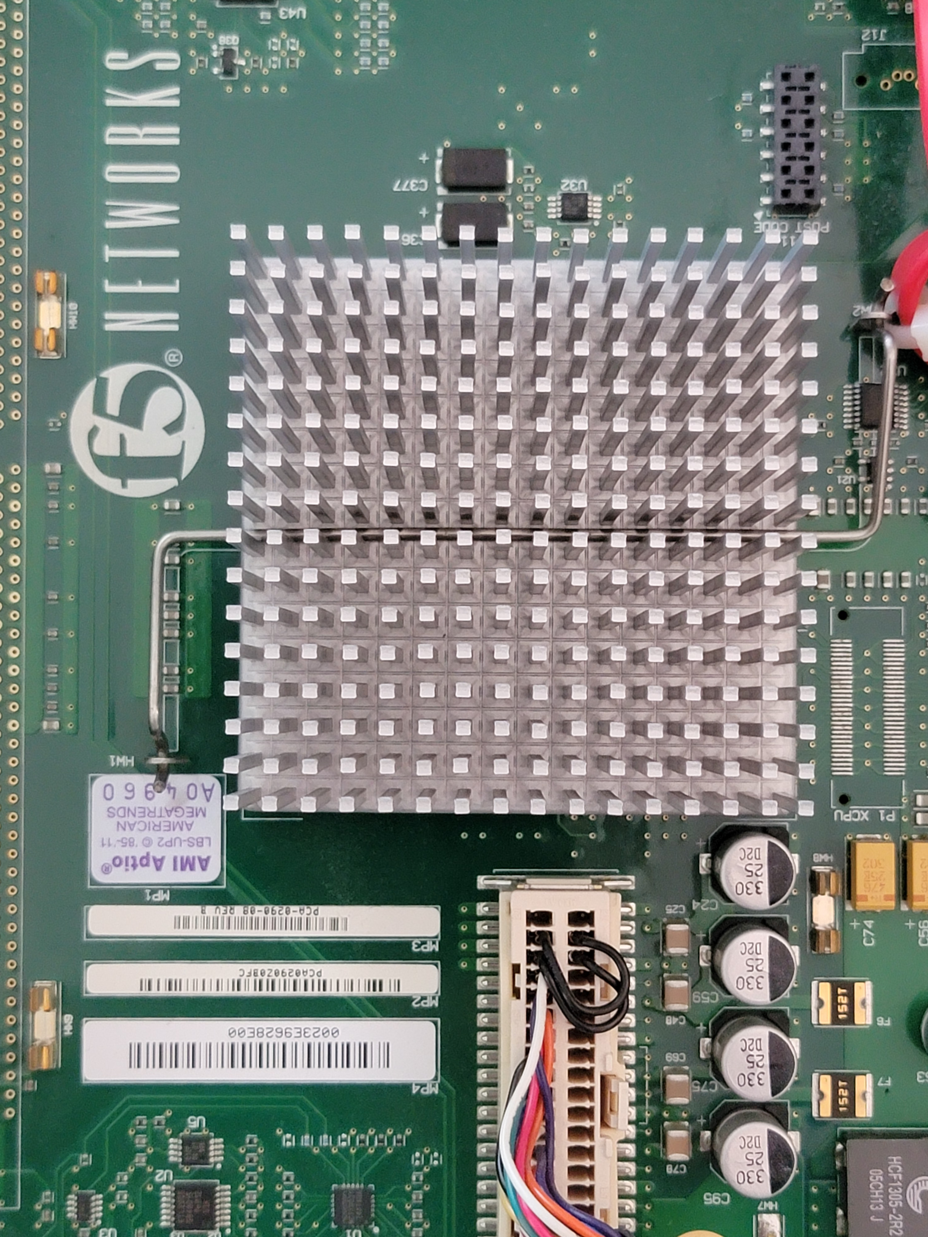

Hey JDM I meant this larger heatsink… I doubt that’s a xeon but I could be wrong… my research skills on how to look for this mobile online are lacking
Just unpin that heatsink and see what’s underneath!
SR0NU looks to indeed be an E3 quad core proc
SR0NU Intel Xeon E3-1125C Quad-Core 2.00GHz 5.00GT/s DMI 8MB L3 Cache Socket FCBGA1284 Processor
Wow, that’s actually pretty rad.
now to figure out how to flash this board and make use of it :grinning:
there’s no vga/graphics output
I think that was a pretty decent score for $75 CAD

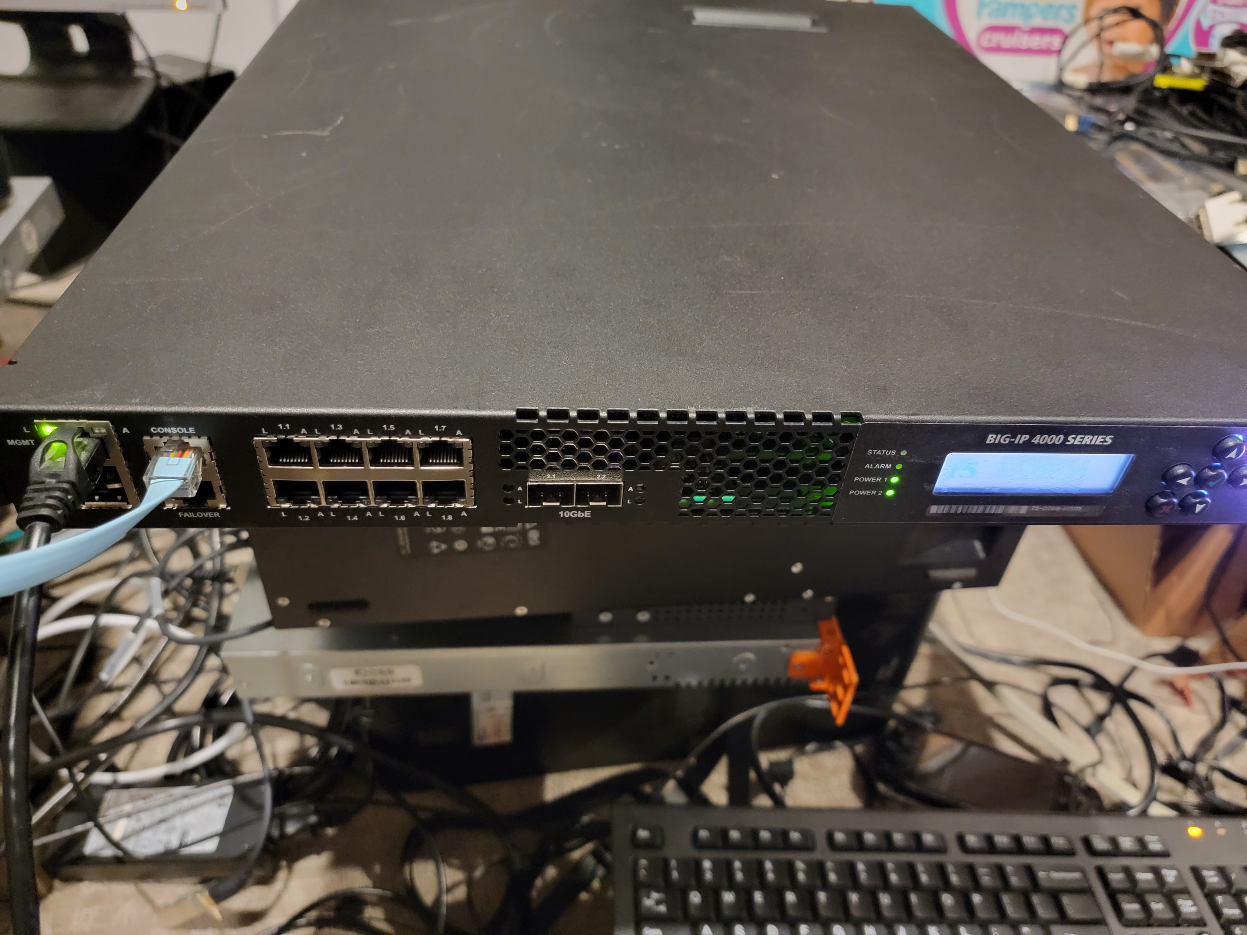

You’ll need to use a console cable to connect to the serial management interface. From what I can tell, the device comes with a heavily customized CentOS install, but you could feasibly install whatever you want. Don’t be fooled by the arrangement of the ports, that’s not an integrated switch - those look to be simply two quad port NICs on the board. Unsure on the controller model, but it’s more likely to lack a solid FreeBSD driver than it is to have one. Given the custom nature of the board, there will almost assuredly be quite a few things that would not work as intended using an OS other than the one they provide with their modified kernel and modules.
thanks @Riggi, I’m trying to access it through the console right now… hopefully I can get proxmox installed and see what’s available
