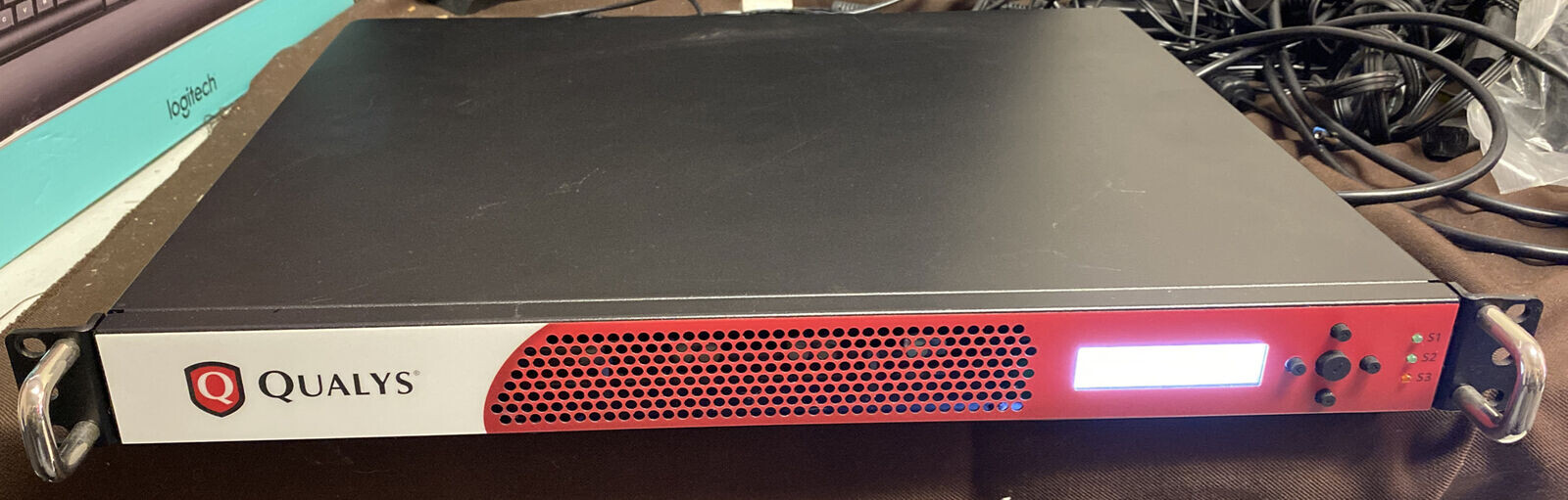

Qualys Scanner Appliance Model No: QGSA-4120-A1
Over all it is a great unit. Only upcoming change I have is to purchase a riser card and insert a 10g card into it. This will require me to do some minor case mods, but I think it is worth the pain.

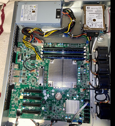

the insides for any interested

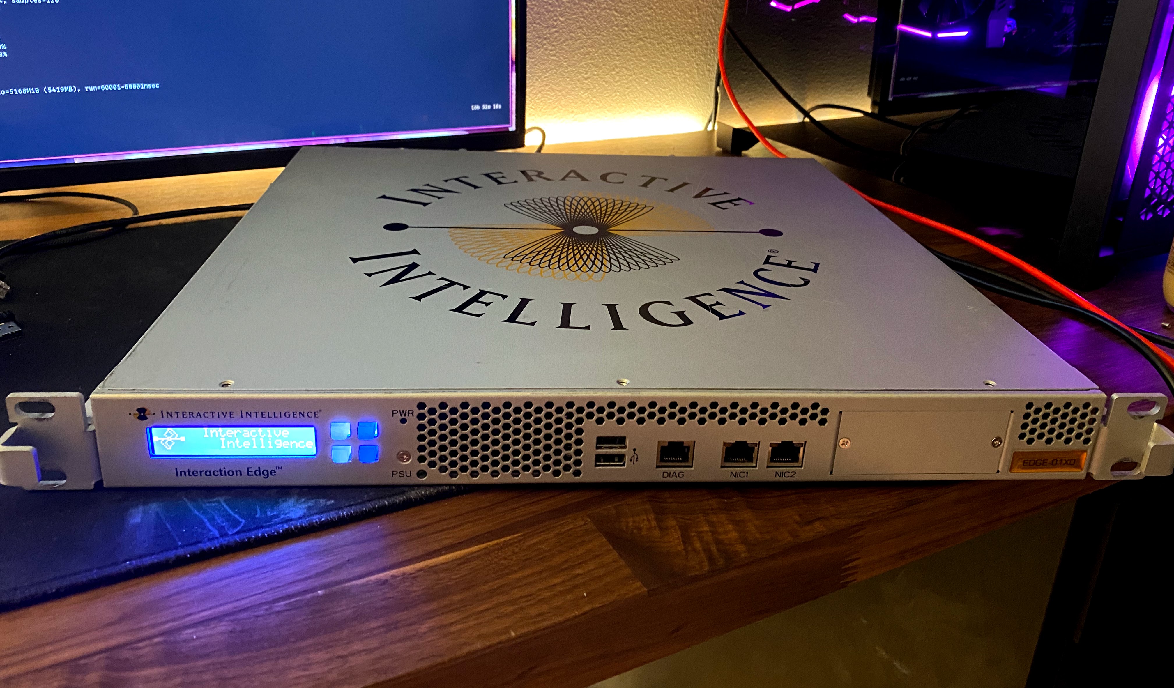

This popped up in my eBay feed for $29 USD and I grabbed it (mostly because it looks like a piece of CIA wiretapping equipment
It’s an Interactive Intelligence (now Genesys) Interactive Edge EDGE-01X0 SIP edge router:

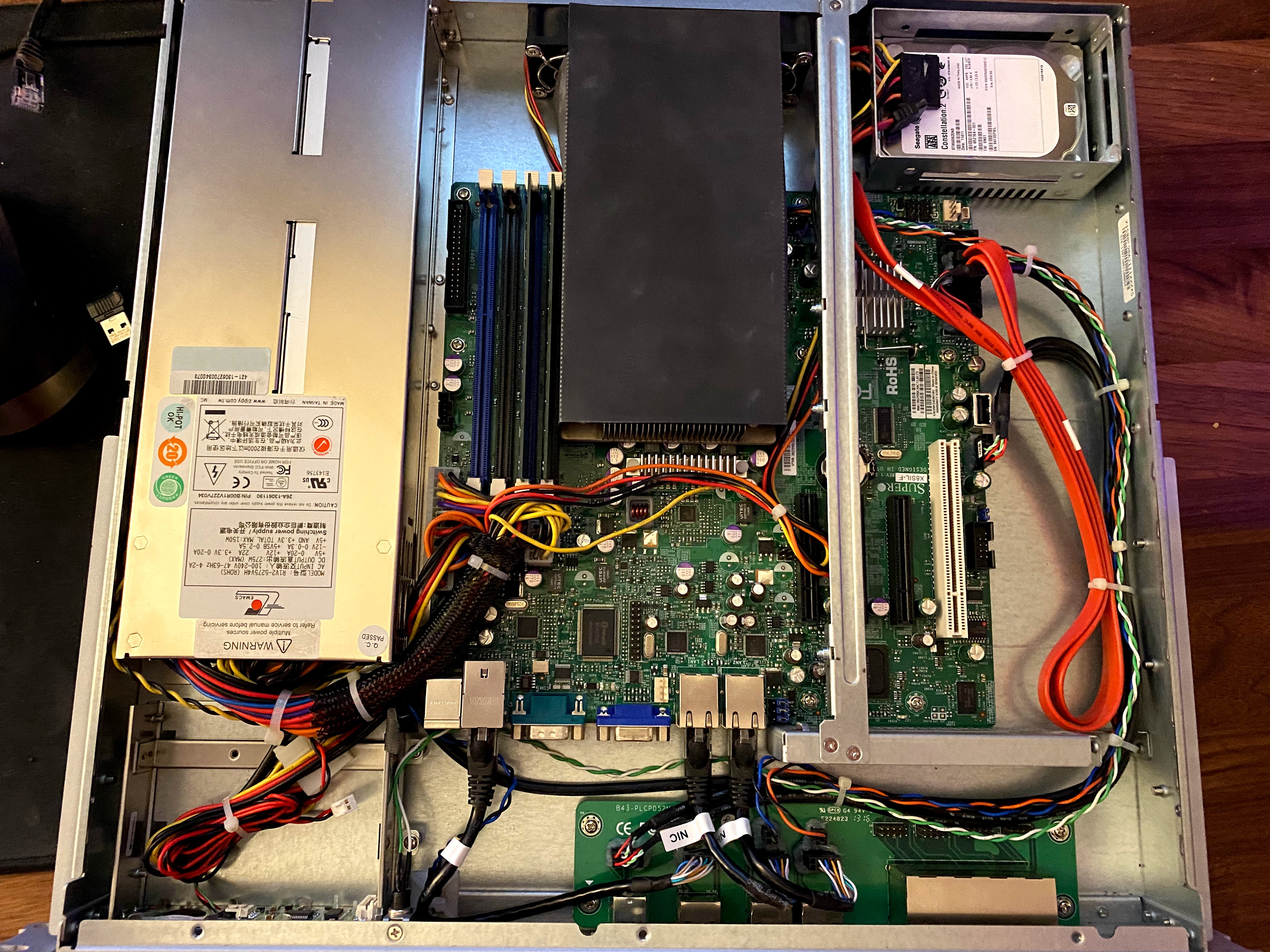

Nothing online indicated the hardware inside but for $29 no big loss. Turned out to be a Supermicro X8SIL-F with a Xeon X3450, 4GB DDR3 1333mhz, 32GB Kingston DataTraveler flash drive (seller had pulled the hard drives but it originally had 2 of some sort), EMACS 275W dual PSU, and a CrystalFontz LCD:

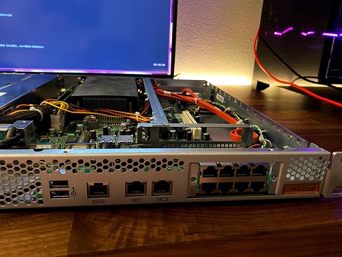

The little cover on the front can be removed to reveal more RJ-45 ports which on other models are typically connected to T1 TDM’s for SIP to landline termination. Could probably be rigged up to a NIC connected similar to how the onboard NIC ports are:
BIOS wasn’t locked but IPMI was set to a static address and had a non-default login so I had to use FreeDOS to reset it. I was then able to update it to the latest BIOS and IPMI firmware no issue.

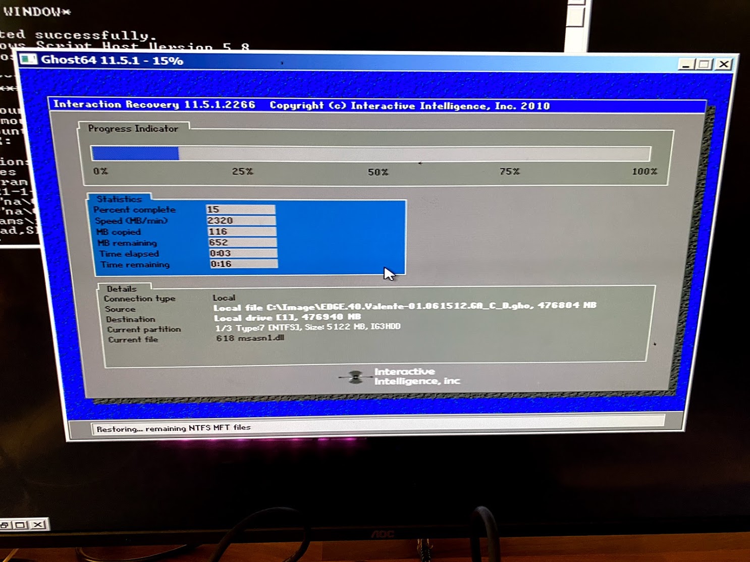

If anyone is curious if you put hard drives in it by default it will boot WinPE from the USB and start up a copy of Ghost and image the drives with the original software. Kind of neat for an appliance like this to have a bullet proof restore procedure like that. Of course the software won’t actually work without a license ![]()
Kind of meh hardware especially for pfSense and the like (no AES-NI support) but not terrible. I’ll probably end up throwing some random x9/x10 supermicro board in it.
That hardware isn’t nearly as bad as I thought, it’s NAS Killer 1.0 level. X8SIL has been around the block, it seems.
