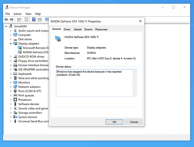

Hi,
my xml My VM XML - Pastebin.com
I have tried it with the multifunction and the slot changes also in the gpu section,
Screenshots added

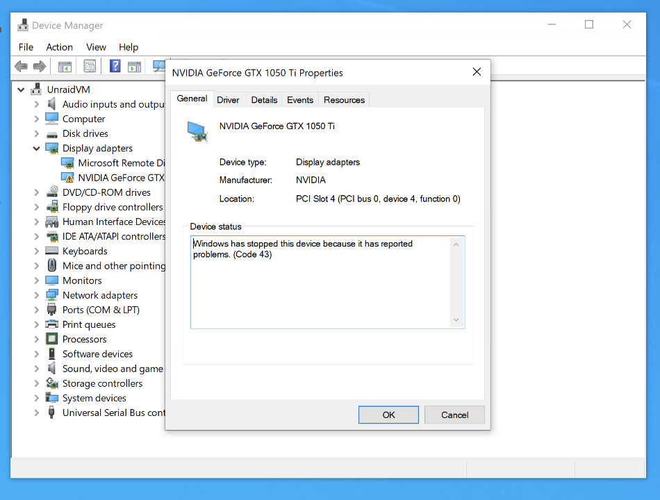

Hi,
Screenshots added
You have missed a few parts of the guide, hyper-V is enabled. Start there and recreate a new VM.
@JDM_WAAAT Hi, did have the VM with Hyper disabled as per guide, I had the 43 issue still at that point, I added in the stuff for Hyper v into the xml at the end to see if it made a difference
before Hyper V
The Hyper-V should not be changed until the GPU is working.

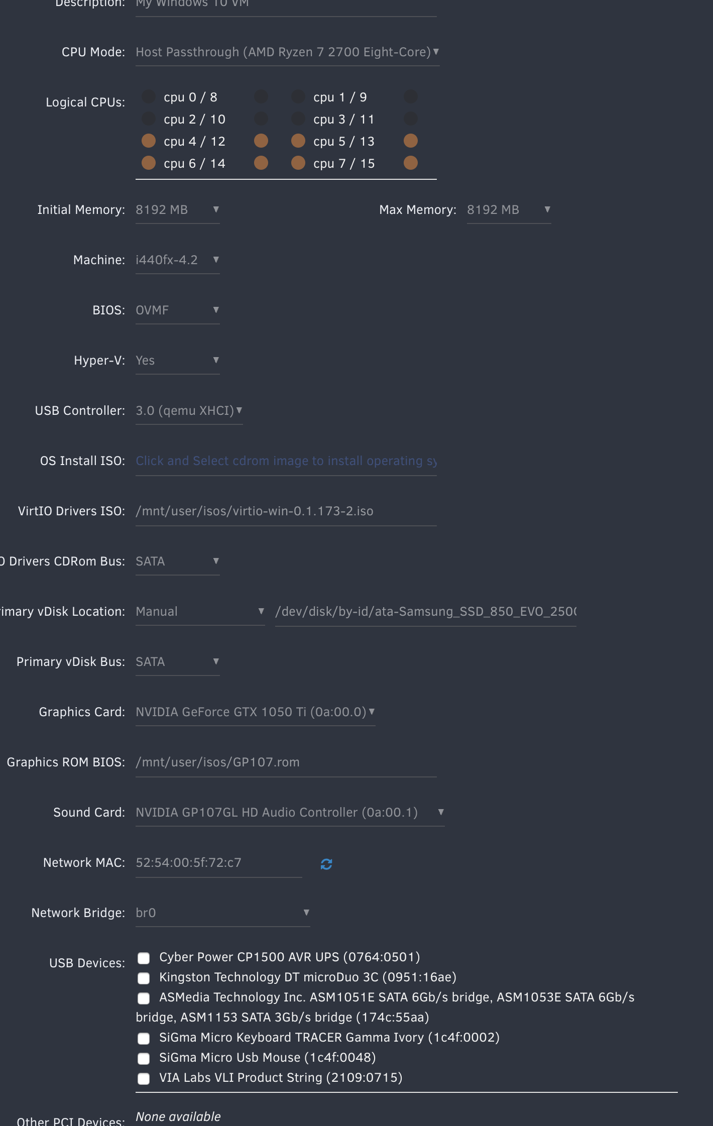

This section:
<hostdev mode='subsystem' type='pci' managed='yes'>
<driver name='vfio'/>
<source>
<address domain='0x0000' bus='0x0a' slot='0x00' function='0x0'/>
</source>
<rom file='/mnt/user/isos/GP107.rom'/>
<address type='pci' domain='0x0000' bus='0x00' slot='0x04' function='0x0' multifunction='on'/>
</hostdev>
<source>
<address domain='0x0000' bus='0x0a' slot='0x00' function='0x1'/>
</source>
<address type='pci' domain='0x0000' bus='0x00' slot='0x06' function='0x0'/>
</hostdev>
Should be:
<source>
</source>
</hostdev>
<source>
</source>
<address type='pci' domain='0x0000' bus='0x00' slot='0x04' function='0x1'/>
</hostdev>```
Hi, I did have that set like that but still get the code 43, i was trying different things and forgot to put the lines back in for the xml i sent you, sorry ![]()
I have just changed the xml back to pre-hyper v and redone them lines again and still not working ![]()

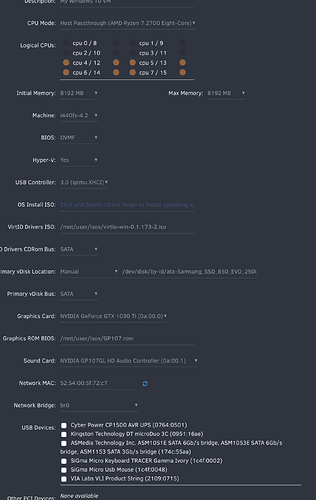

You really should create a new VM following all of the settings exactly, then see what happens.
I did do it exactly … I will do it again tho

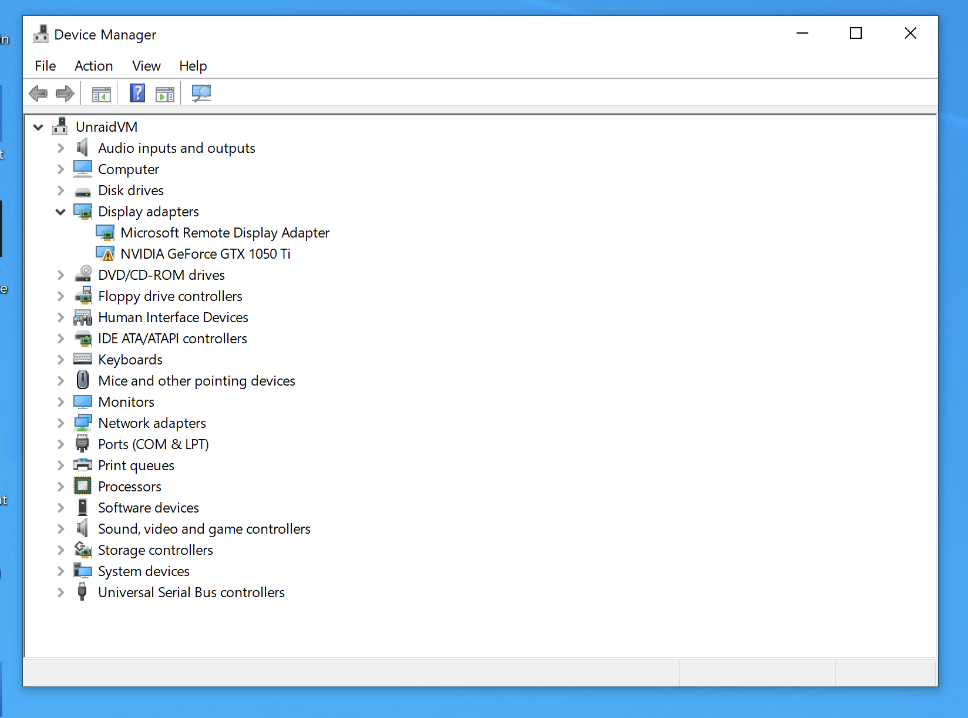

Hi @JDM_WAAAT I have done it again from scratch followed the guide up till editing the xml with the changes for the GPU multifunction bit,
https://pastebin.com/Sc0L6zMH!Screenshot 2020-05-25 at 22.39.19|675x500
