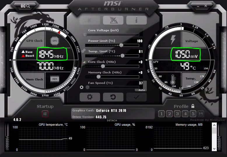

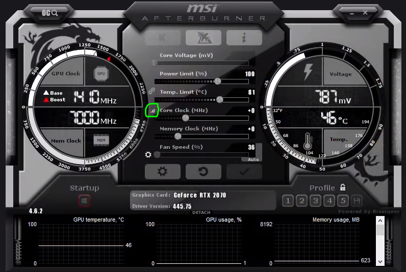

4. MSI Afterburner Overview
1. Afterburner info (click me)
All fields are top top bottom, left to right.
- Current GPU Core Clock Speed
 - Current GPU RAM Effective Clock Speed
 - Core Voltage (mV) - Disabled
We will not be adjusting core voltage with this slider. - Power Limit (%)
The maximum power the GPU can use, in %. - Temp Limit (degrees C)
GPU Core Temperature - Core clock (MHz)
GPU Core Clock Offset (relative to stock) - Memory clock (MHz)
Effective Memory Clock Offset (relative to stock) - Fan Speed (%)
Shows current fan speed when set to “Auto” (stock behavior)
You can also force a constant fan speed or enable a user-defined curve.

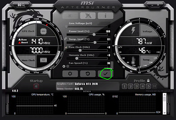

 - Settings

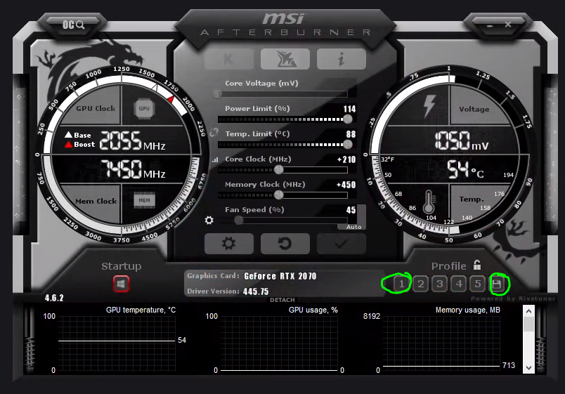

Show main settings menu - Revert
Revert to stock settings - Apply
Apply all changes that have been made
Apply changes often. It updates your displays, and will allow the changes to be saved into a profile.
 - Current GPU Core Voltage Display
 - Current GPU Temperature Display
 - Startup
Applies the selected profile at startup - Graphics Card
GPU Information - Driver Version
Driver Version Number - Profile
- Lock/Unlock
Prevent changes to the profiles - 1/2/3/4/5
Profile save slots - Save button
Click the save button after making changes, then select a profile save slot.

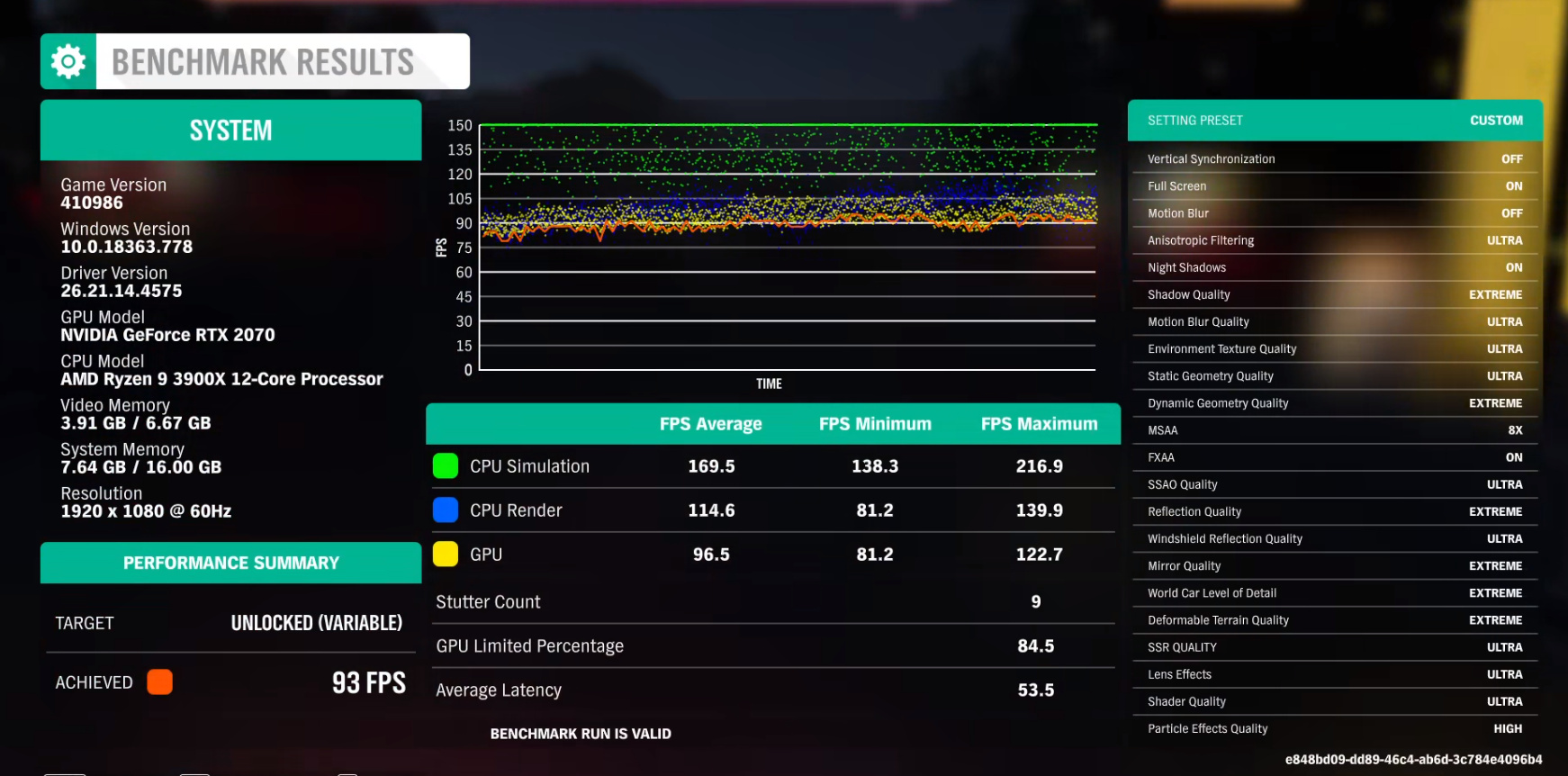

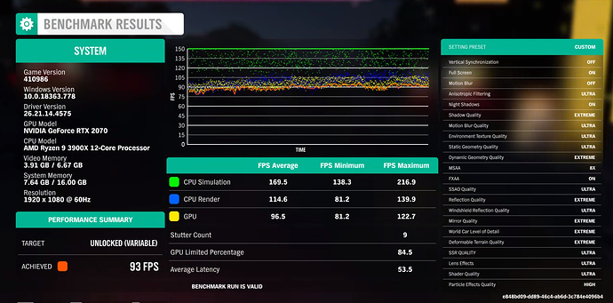

Before any of the steps below, I recommend running a benchmark.
For this guide, I will be using Forza Horizon 4’s built in benchmark tool at Ultra settings on 1080p with AA maxed.
This will set a baseline for comparison.
1. Stock Benchmark Results (click me)
- “Stutter Count” seems high, so we’ll take note of that for future runs.
This is a raw count of the number of frame stutters and dips experienced in the benchmark. - “GPU Limited Percentage” is the amount of time where the GPU was the limiting factor when rendering frames. A higher percentage indicates a GPU bottleneck, a lower percentage indicates a CPU bottleneck.
This guide will aim to lower this percentage.

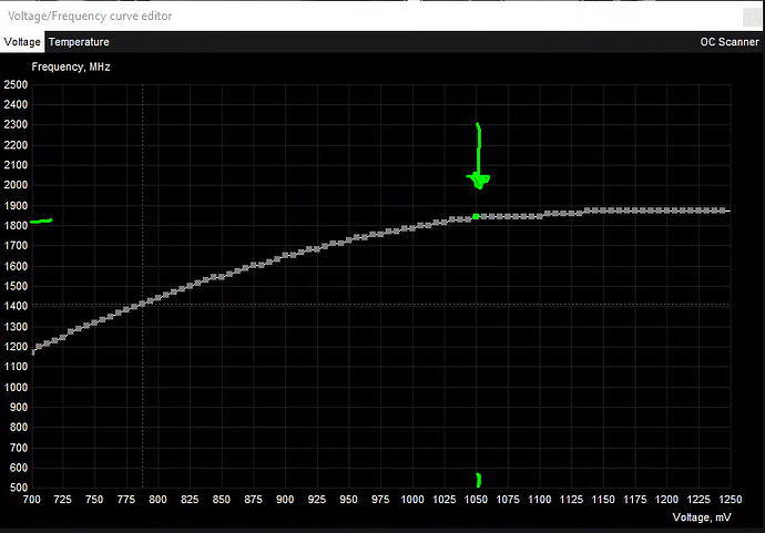

[details = 2. Force your GPU’s Voltage & Frequency (click me)]
Locking the Voltage and Frequency will show an improvement on its own, especially with stuttering and minimum frames. If you don’t feel like extracting even more performance out of your card, you can stop here at the end of step 1.
- Click the graph icon next to “Core Clock (MHz)” or press
CTRL+F

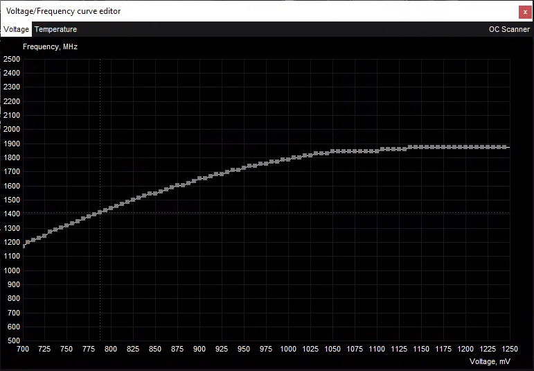

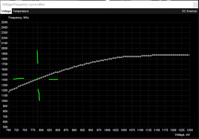

 - You will see this window appear.
 - We will only need to use the voltage tab, so don’t click off of that.

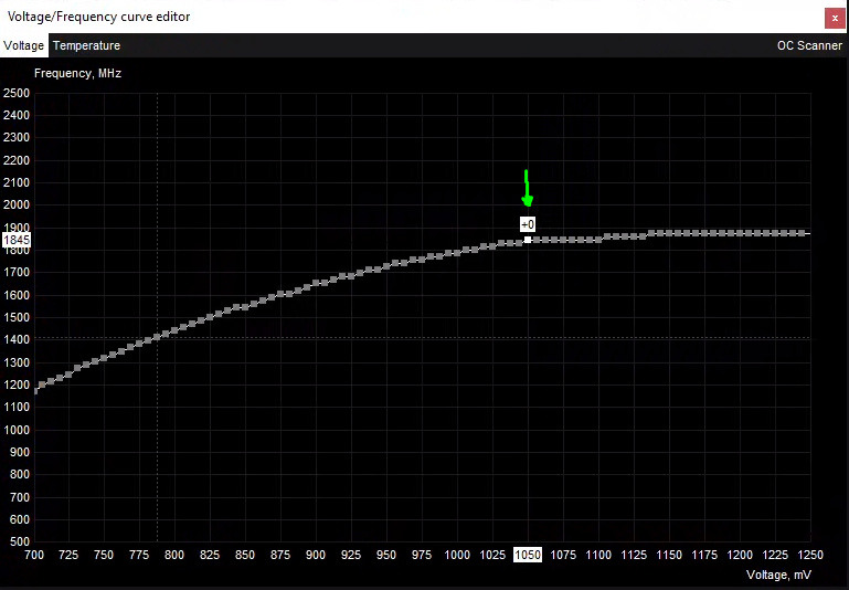

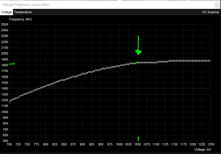

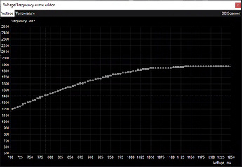

This is the default Voltage and Frequency plot for your GPU. As more demand is placed on the GPU, it will dynamically increase Voltage and Frequency. The problem is that game do not have a consistent workload, causing the Voltage and Frequency to jump around very quickly. This can cause a number of performance issues.
The intersecting grey lines are the current Voltage and Frequency.

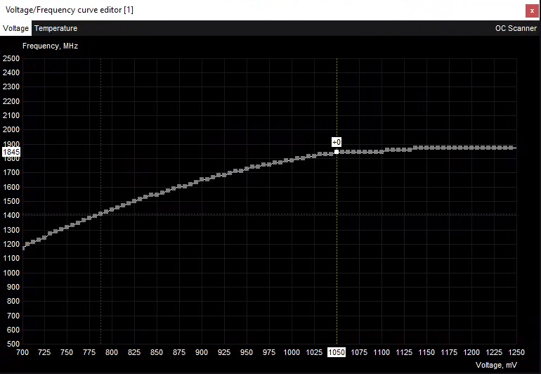

 - Look for where the curve starts to flatten out. For my RTX 2070, this is at
1050 mVand about1850 MHz. This is where we will lock the card’s voltage. It’s a good starting point, you can always increase or decrease this later.
1.Click on that point (without clicking and dragging it)
Make sure the point’s value says+0when the point is selected.
If it doesn’t, use the arrow keys on your keyboard to adjust the value until it is+0.
l - Press the
Lkey on your keyboard.
A yellow line will appear.
You have now forced your GPU to use this Voltage and Frequency.

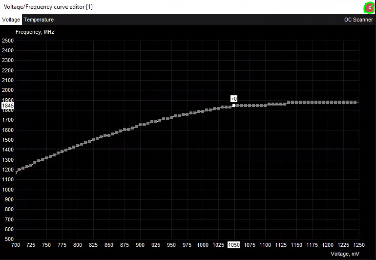

 - Click the “X” button on the graph.

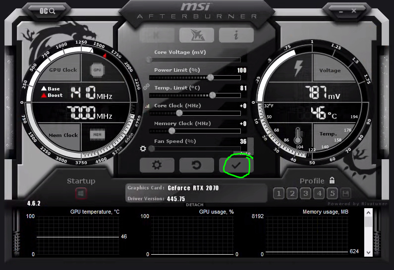

 - Before going any further, apply your settings.
Get used to doing this after every step.
 - Inspect your work
Notice the Core Clock and Voltage displays have changed to your settings.

3. Locked Voltage and Frequency Benchmark Results (click me)
Overall performance is marginally lower than a stock card, however stutter count is much lower. This indicates that while the card was dynamically turbo boosting higher than our current settings, performance is now much more consistent while only losing about 1 FPS on average.

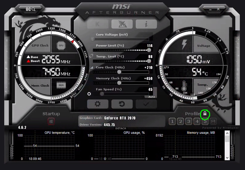

4. Apply an Overclock (click me)
It’s time to get even more performance from the card now that we have locked it down.
- Start by maxing out your Power Limit and Temp Limit.
These are just limits. This will allow your card to maintain clock speed under a variety of workloads.
Make sure to apply your settings.
 - For your first overclock, start with +80 MHz Core and + 200 MHz Memory.

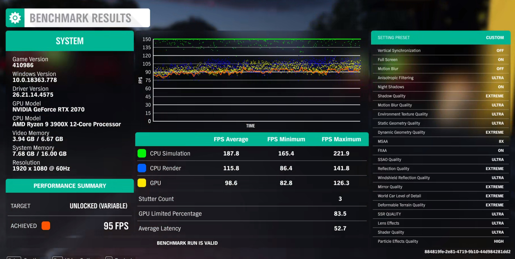

 - Retest your benchmark
5. Overclocked Benchmark Results (click me)
Finally, we see a performance improvement.
- “Stutter Count” is within margin of error of the previous benchmark, but it is higher.
 - “GPU Limited Percentage” dropped quite a bit as well.
 - Average FPS improved.

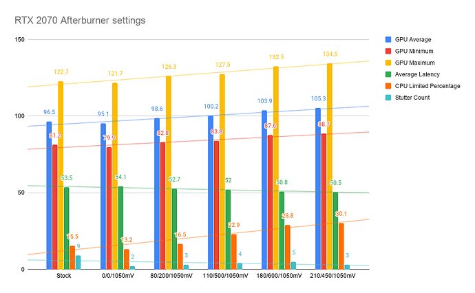

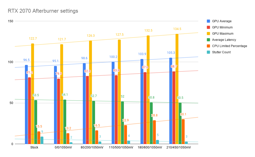

6. Benchmark results
The chart below details various overclocking profiles with results from the Forza Horizon 4 benchmark.
- Each group is labeled either [Stock[ or with [Core Offset/Memory Offset/Voltage].
 - GPU Average (higher is better)
Average FPS rendered by the GPU - GPU Minimum (higher is better)
Minimum FPS rendered by the GPU - GPU Maximum (higher is better)
Maximum FPS rendered by the GPU - Average Latency (lower is better)
Frame latency rendered by the GPU - CPU Limited Percentage (higher is better)
= 100% minus the GPU Limited Percentage.
We are overclocking the GPU in order to reduce the GPU bottleneck, putting more load on the CPU. - Stutter Count (lower is better)
A couple of things to note…
- While locked voltage with no overclock technically performed worse than stock, performance is much more consistent equating to a much better gaming experience. Frame rate isn’t everything.
 - Stutter count dropped significantly after locking the voltage, but continued to increase with each overclock. Dropping the Memory Clock reduced the Stutter Count again.
 - Compared to the stock GPU, CPU Limited Percentage increased from 15.5% to 30.1%.
That equates to double the amount of time that the CPU was the limiting factor when rendering frames. - Minimum FPS rose about 9.2% from stock, which is huge.
On a slower card this could be the difference between having sub-60 FPS to having consistent 60 FPS or higher.

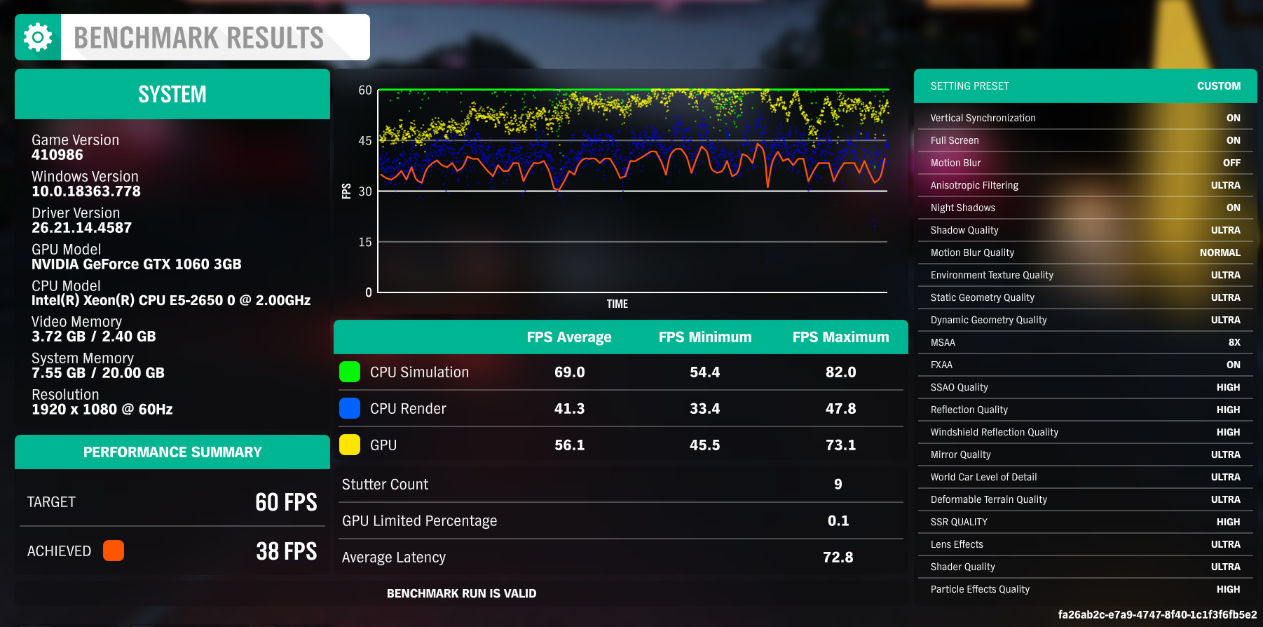

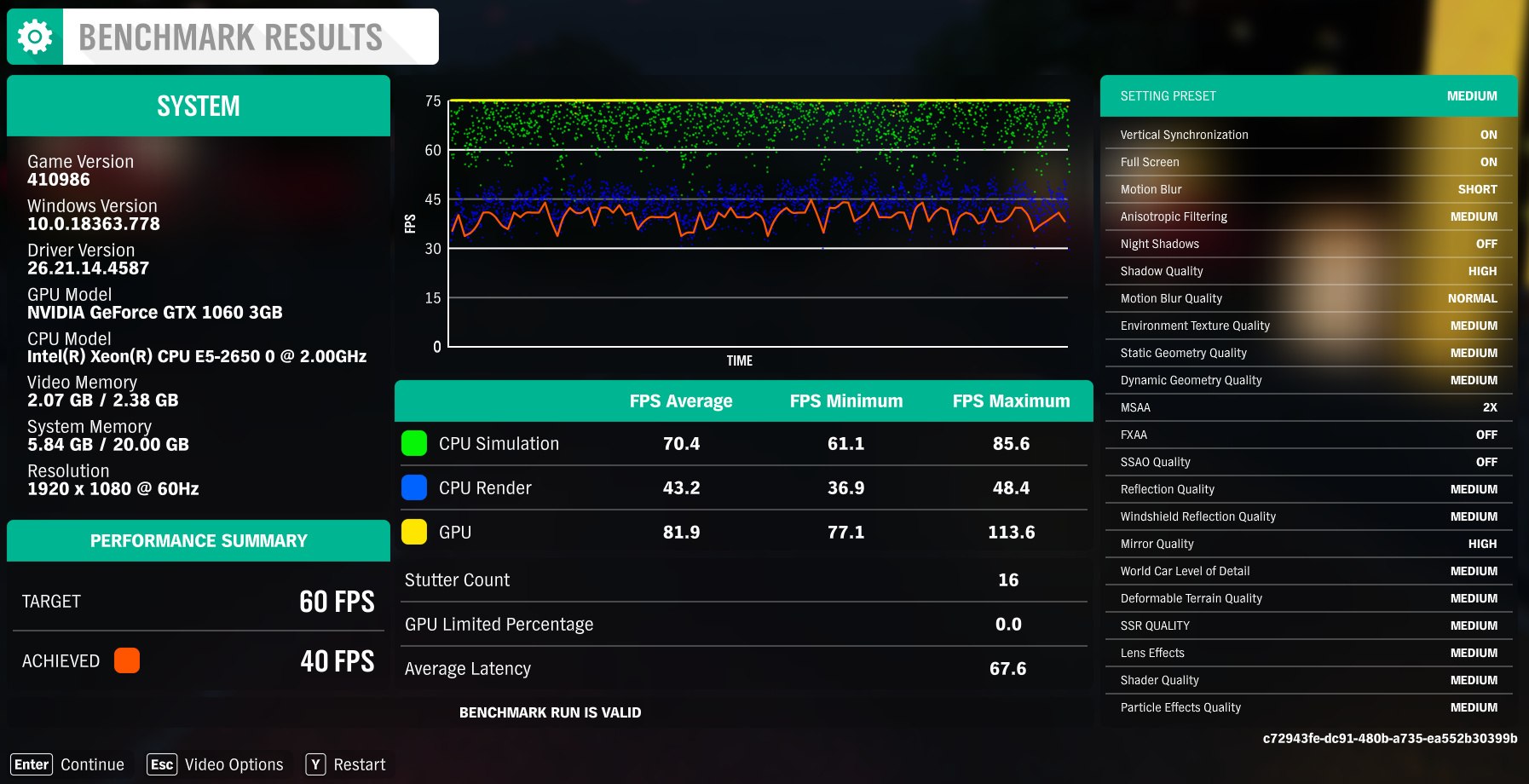

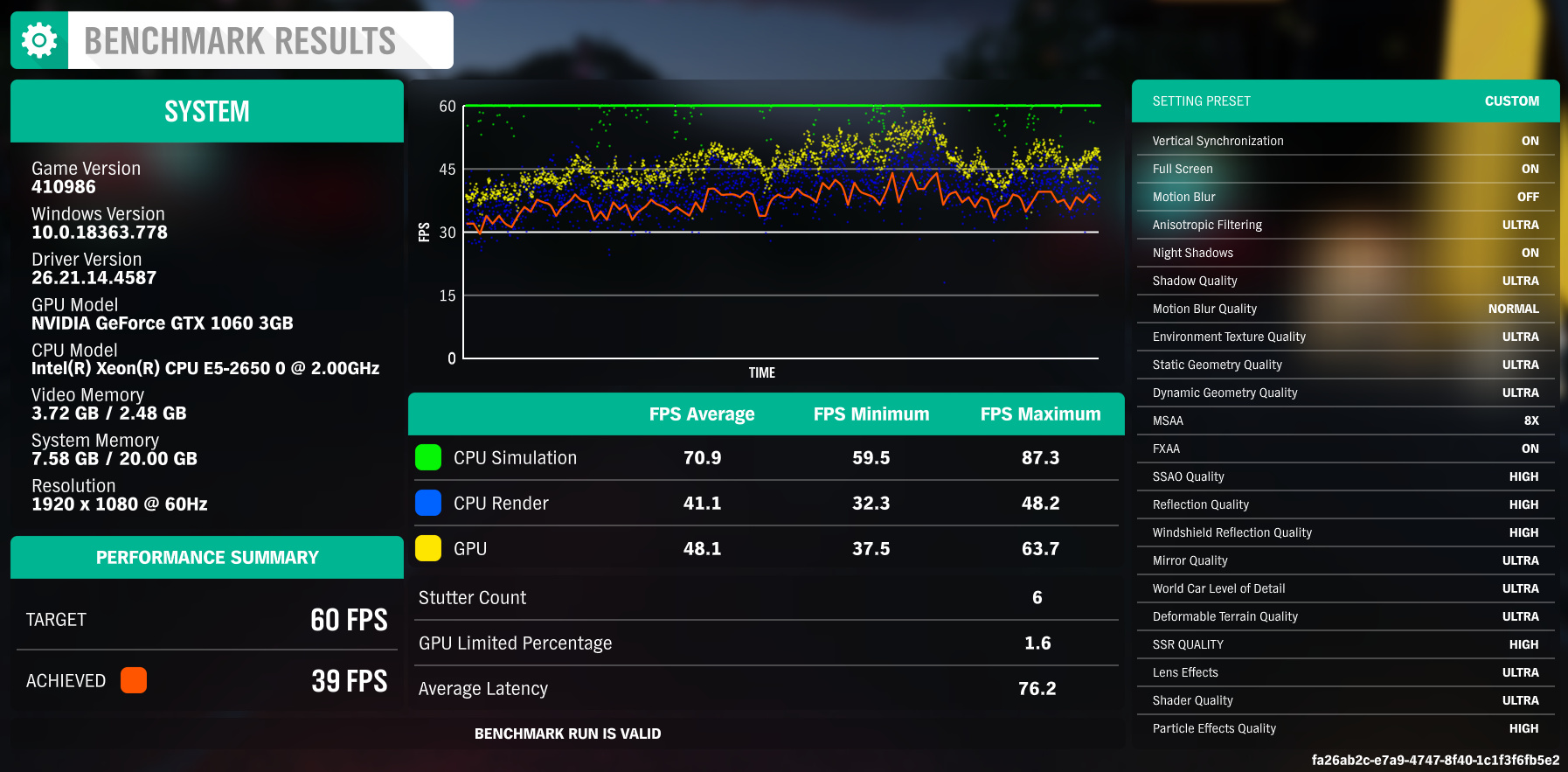

Thanks so much for this guide, JDM!!! This has been very helpful. Here are all my before overclocking benchmarks.
This benchmark was taken with everything at stock, graphics optimized by the game, and with Firefox, discord, Xbox loader, battle.net loader, and more running in the background. It was a “this is my first benchmark” kinda thing.

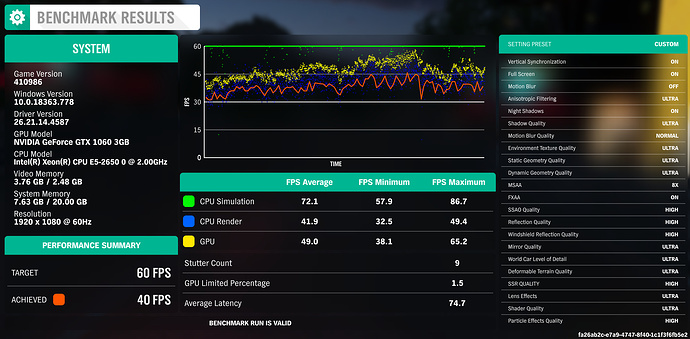

This is the first benchmark with the settings set to the ultra “category” setting. Then AA was turned on and maxed out and motion blur turned off.
This is the first benchmark where there were no background applications running whatsoever. It has the same video settings as in run 2.
This is a second benchmark run, again with no background applications and the settings at ultra - same as run 3.

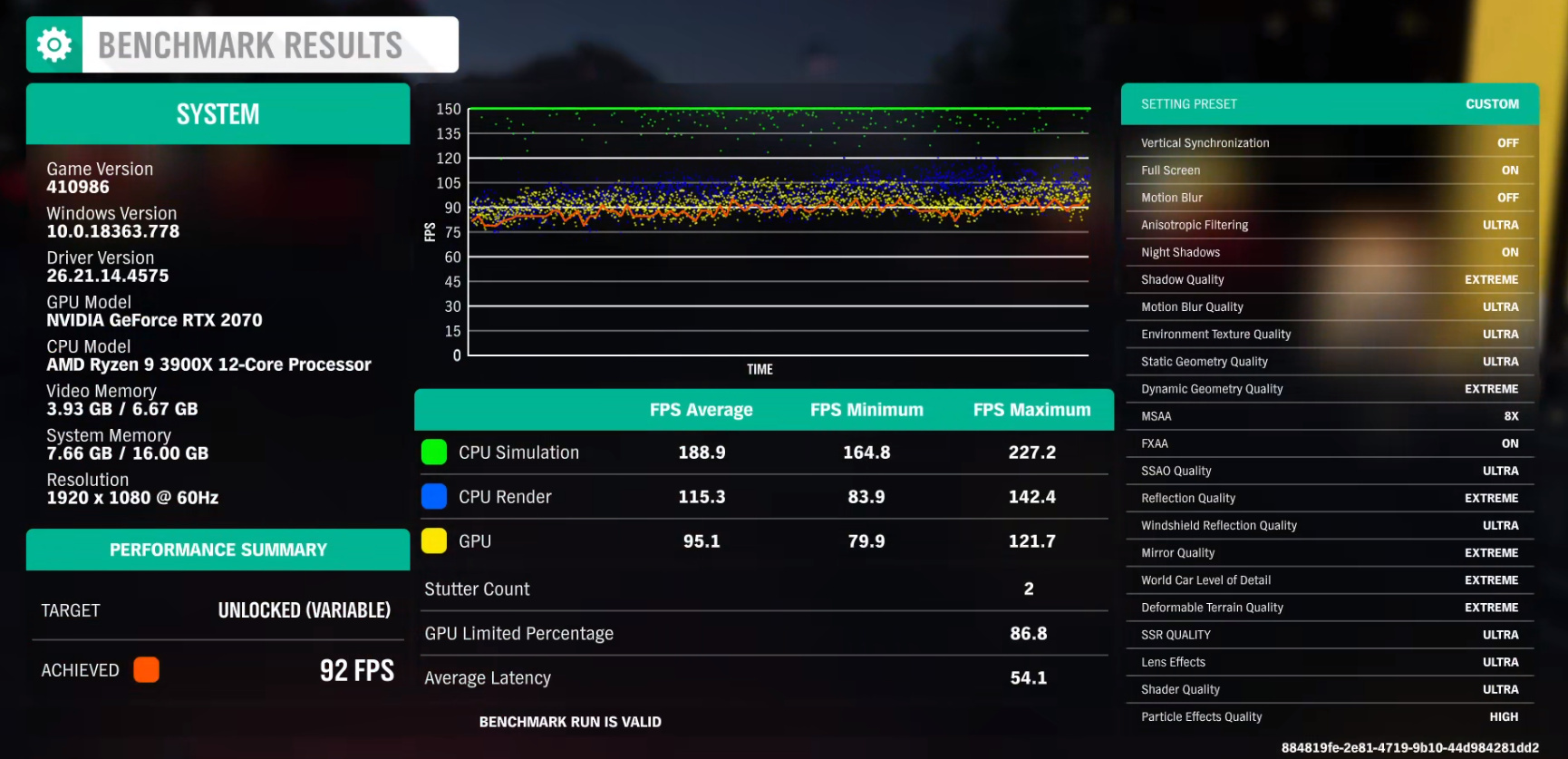

It is very interesting to see the differences in the scatter plot and the FPS line. It make a difference not having a bunch of background applications on.

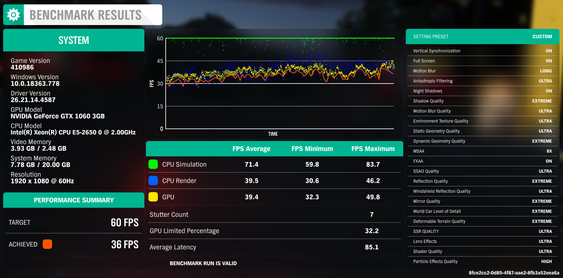

This is a “just for fun/cause I can” benchmark, with all the settings set to their maxed out option - to either ultra or extreme. I also turned on motion blur and maxed it out.
This is a second benchmark run with the settings maxed out just like in run 5.
It is interesting that while the scatter plot condenses, the output is not better - actually worse than just on typical ultra settings.
