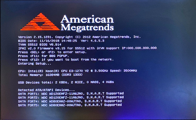

This is Combo 4 listed above in NAS Killer 4.1 on eBay—
American Megatrends v 2.15.1231
BIOS date: 11/16/2018 v 4.6.5.3
TYAN S5512 V8-B14
INTEL XEON E3-1270v2 3.5 GHz
Intel Boot v 1.3.38
Error message: PXE-E61: media test failure, check cable.

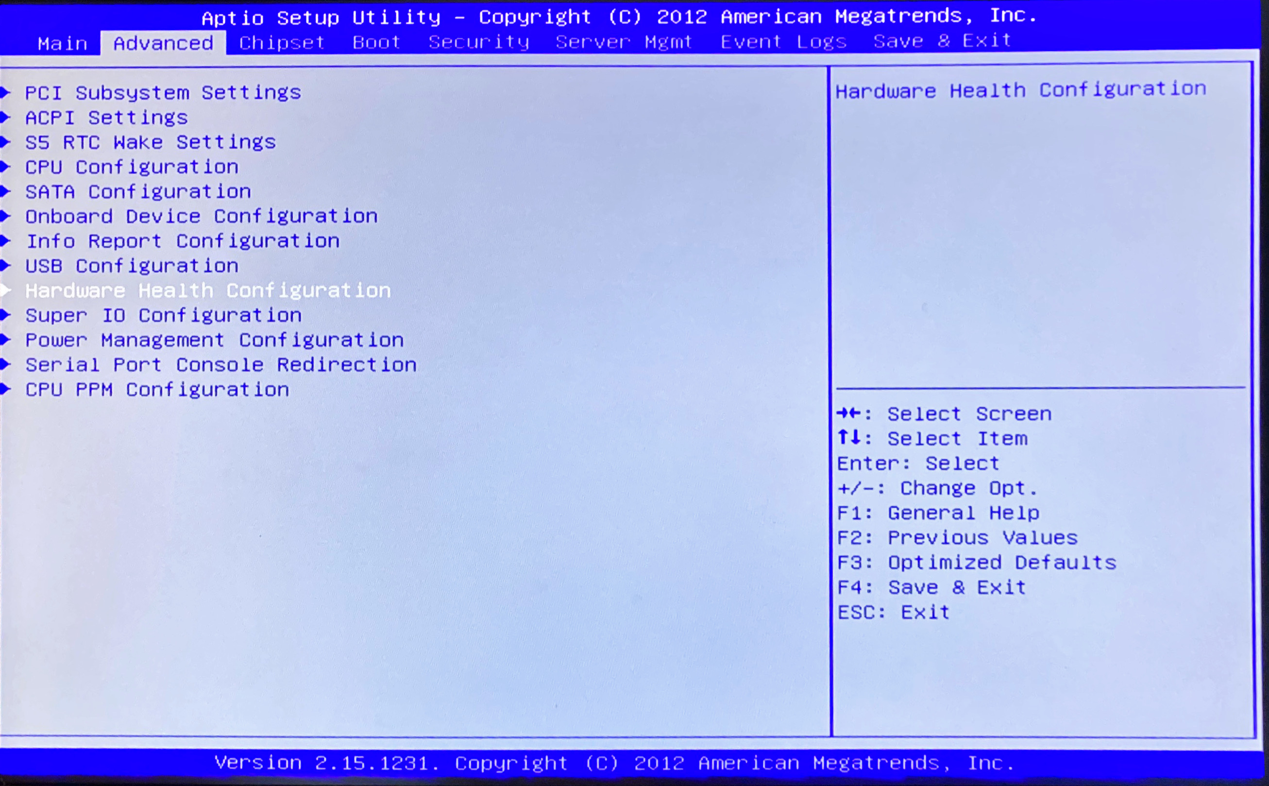

Pressed DEL to get into BIOS, now unsure where to disable the fan alarm. Also seems the media check failed, whatever that might mean. I have connected my HDD to the SAS ports and there currently is no SSD or any drives attached to any SATA ports on the motherboard.
I feel I’m almost there… help Obi Wan Kenobi

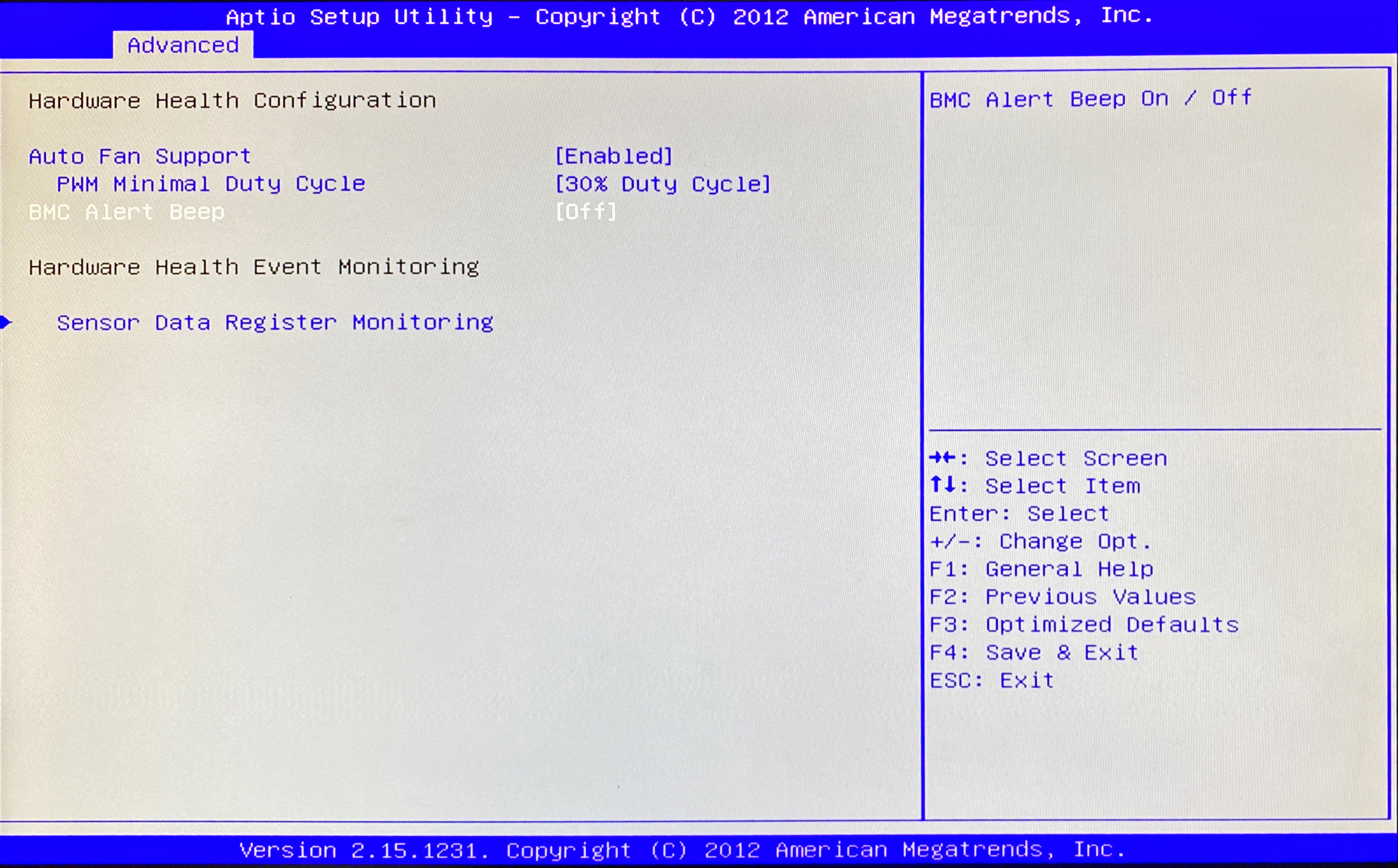

I never found a fan alarm to disable, despite what others said (all I found was chassis intrusion, which was off when I received mine, and BMC alarm, which was also off)
One person had luck flashing the BIOS back to one of the ones on Tyan’s website (the BIOS flashed on these is 5 years newer and not listed anywhere on the website)
Also try plugging your hdd into the SATA ports not into the SAS port to start and see if that fixes the alarm. You could even try plugging it into the very first SATA3 (blue) port, which is by default set to hdd not sdd (if it is a hdd that is)

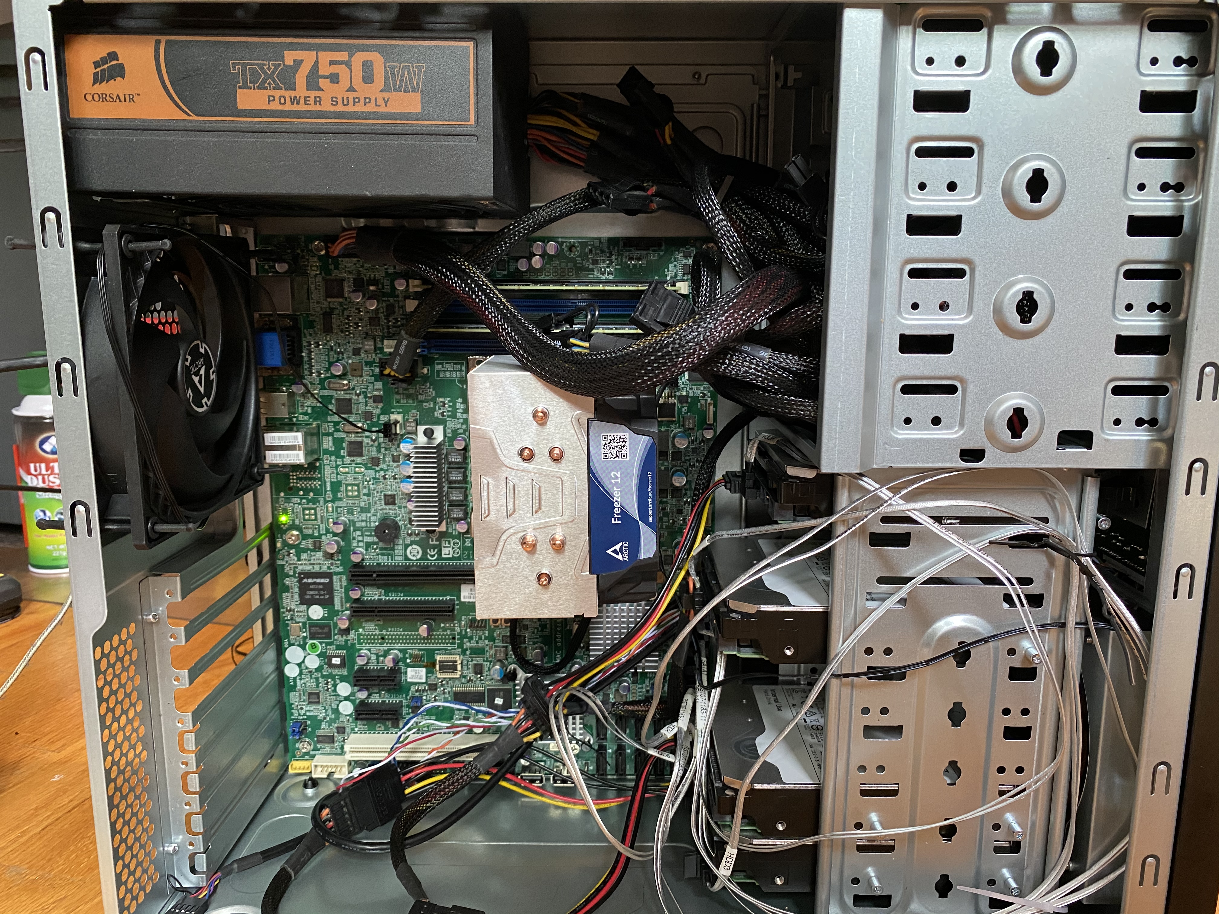

Yes I am using the Cooler Master Elite 350 (CMP350) and while it is a tight fit I think I am able to get (11) 3.5” HDD in there. Right now I have (2) 12TB and (2) 8TB all purchased when on sale.
The Arctic Freezer 12 is a bit loud but I suppose it’s only doing its job.
I stopped the fan alarm :police_car_light: by going into BIOS and disabling BMC Alert Beep.

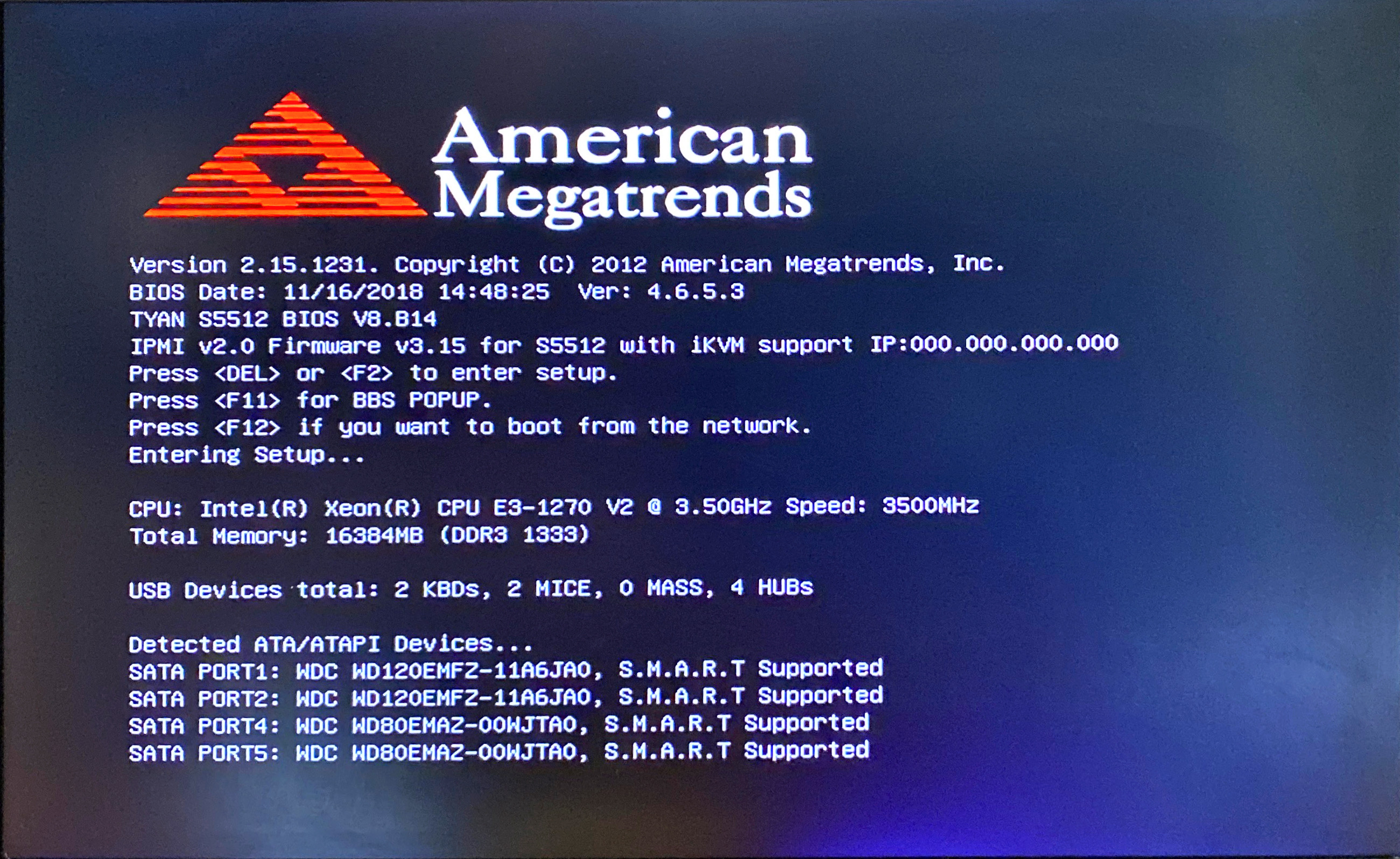

All my HDD are recognized after plugging them all into the SATA 1-5 ports, while I left the SATA 0 port open for an SSD which will arrive later. The SAS ports - how do I use these and plug in SATA HDD? I may have mistakenly assumed I could plug a normal HDD into the SAS port.
Fortunately, I did not have to flash the BIOS. RAM was NOT the issue and all 16GB are recognized. About to install UNRAID Plus (up to 12 drives). Fingers crossed :crossed_fingers:
