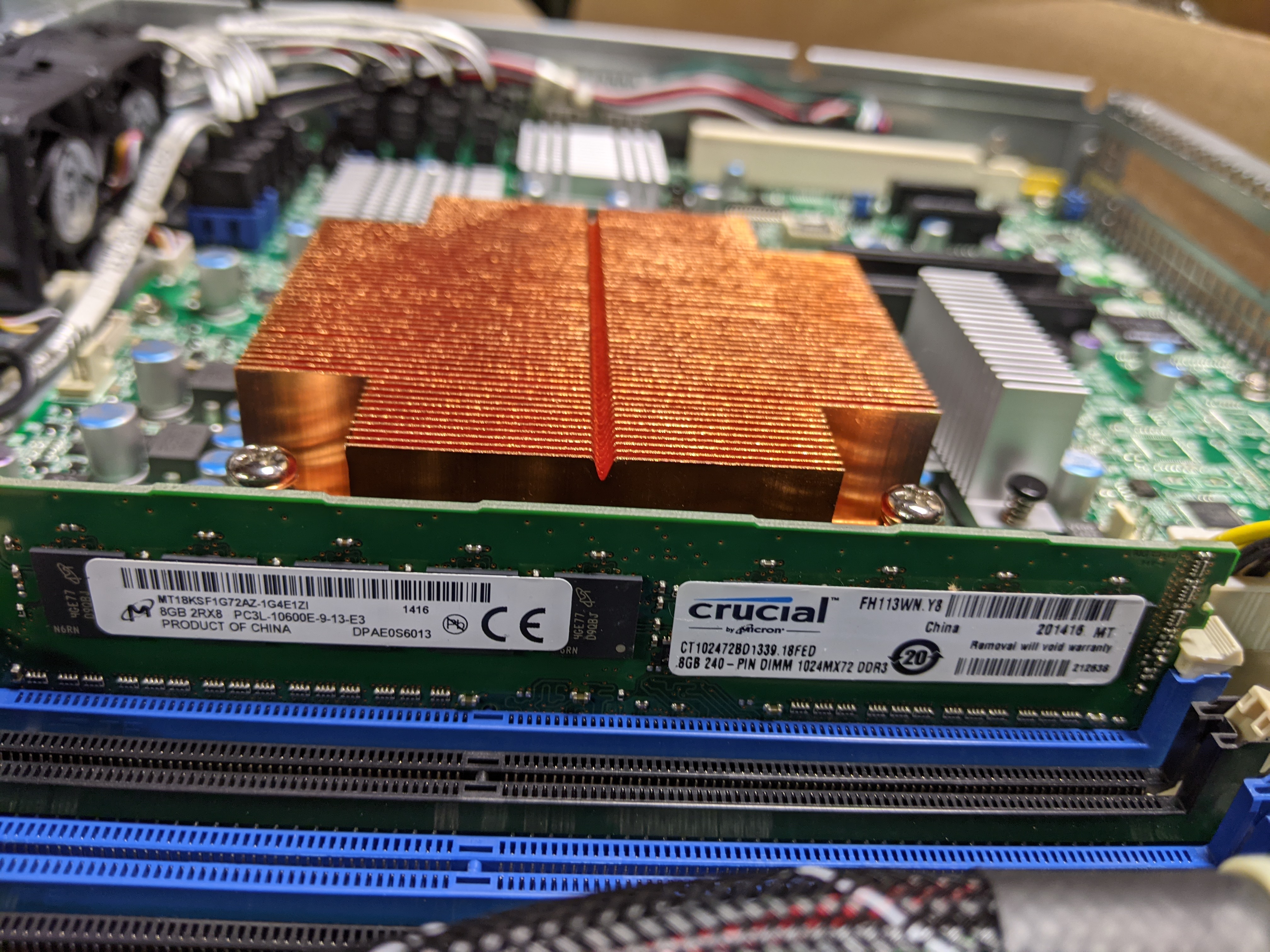

I did some research and think this will work:
That seems expensive, did you reference the NAS Killer 4.0 guide for RAM yet?
