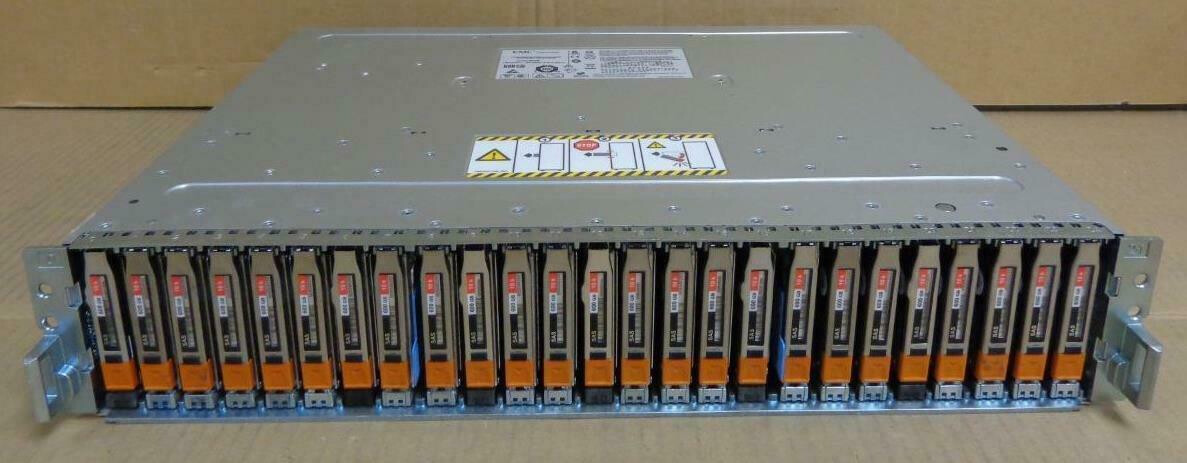

EMC VNX SAE w/ 25x 600GB 10K HDD, w/ 2x 6GB SAS LCC Controllers - $230 OBO incl. shipping
  • Includes 25x 600GB 10K HDD + drive trays
  • JBOD config with passthrough/daisy chain
  • Short depth
  • Dual PSU
$230 shipped, OBO

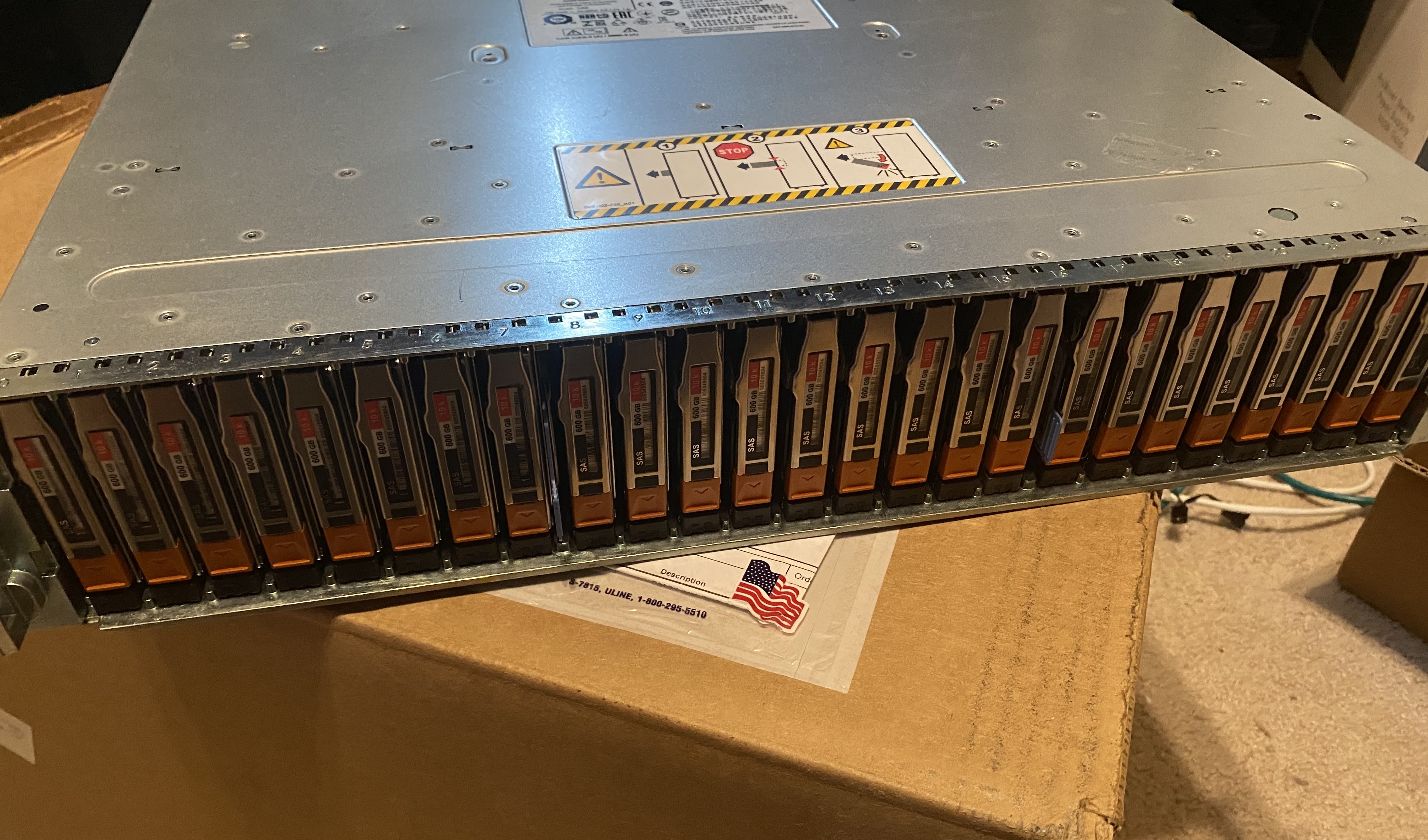

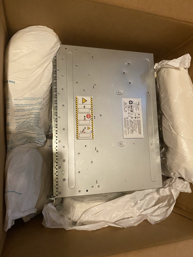

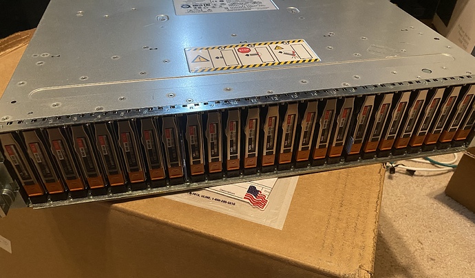

Some additional pictures from the one i just received, will be doing some testing with it this weekend.

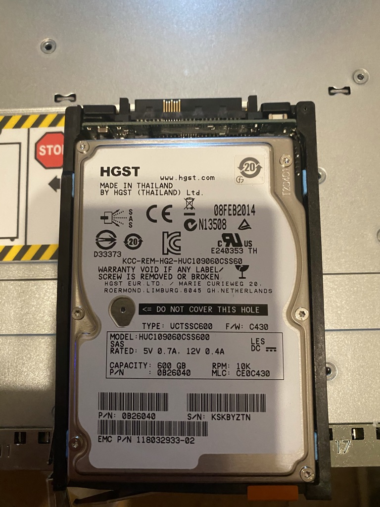

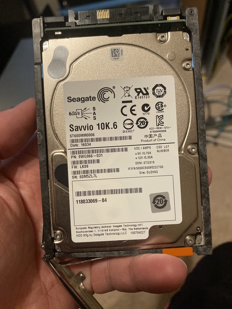

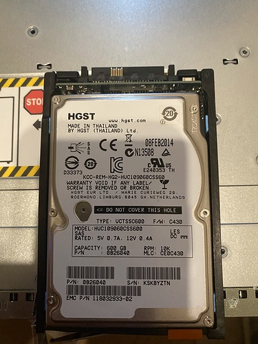

Mine came with 21 of the HGST drives, and 4 of the seagate.
Seller accepted 185 but not 175, may take 180 but didnt try.
HGST HUC109060CSS600
Seagate ST600MM0006

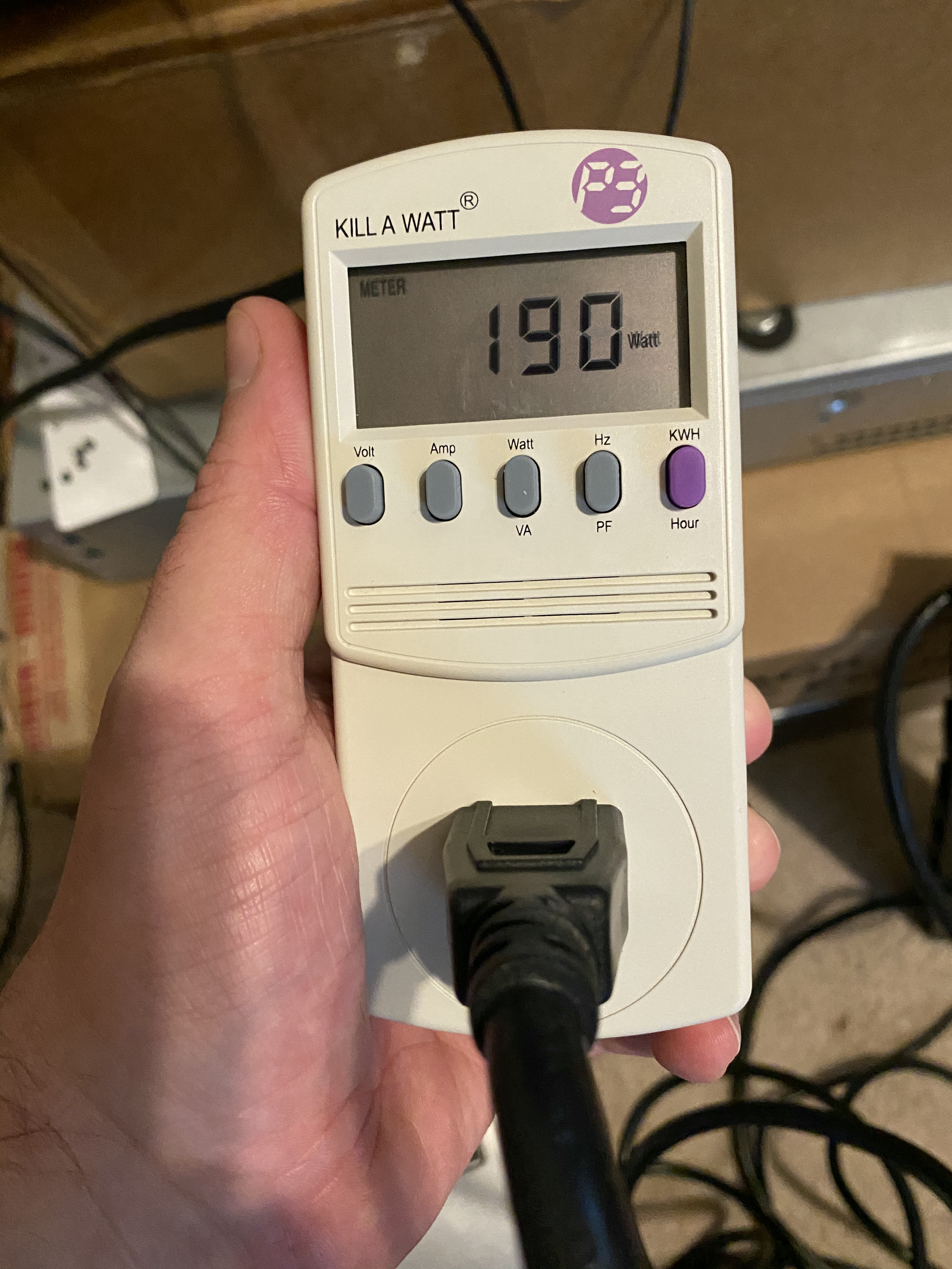

Any ideas what this will pull from the wall at idle?
Not terrible at 190.

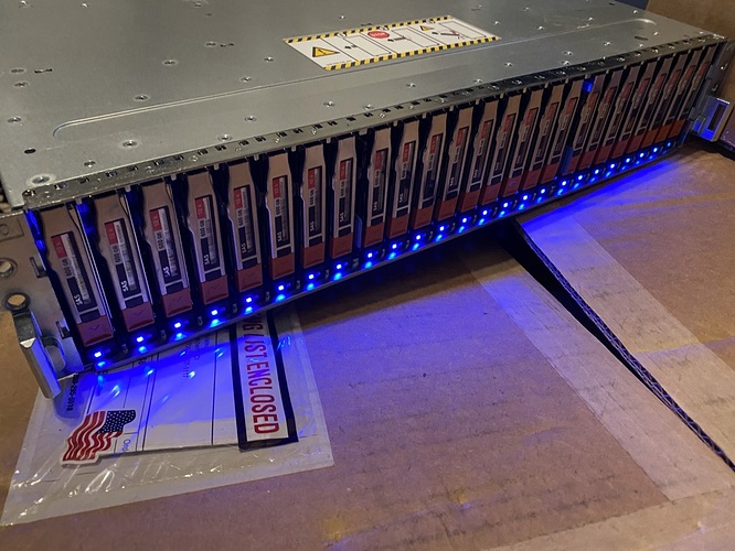

Hell yeah, Chenbro Dwarf Star Blue!
Holy shit that’s a lot of blue blinkenlights

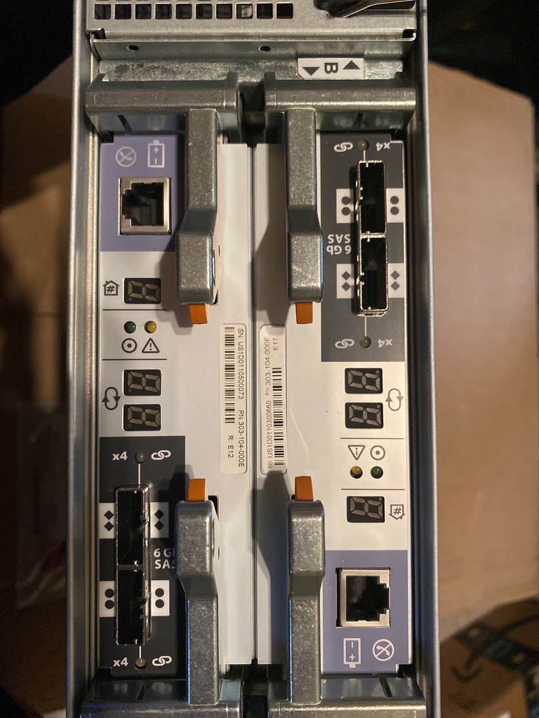

I see there are 4 SAS connectors on the back, do I need to populate all 4 to connect all 25 drives?
nope, and only one is really needed because if you run two in JBOD mode, the drives show up twice and things get weird. so you are limited to one 6gbs connection, unless there is something im not aware of to do. the other two are daisy chain connections you would use to connect additional shelves off one controller.
additionally, i just tested it and cannot get any SATA SSD or HDD to recognize, not 100% sure its not just me, but it did let me swap out to different sized 2.5 sas drives which showed up just fine.
Thanks! I plan on connecting mine to my unraid server. Were you by any chance also connecting to your unraid and saw the drives showing up twice? Mine will get here this week, so I’ll also let you know if SATA drives don’t work on mine either.
sata work! i switched the cable to the top controller vs the bottom and all drives show up. and yes using unraid,

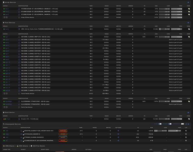

here you can see my test unraid box showing my disks. the VNX drives are the 20x600gb HGST in a raid1 for 6tb cache pool, 2x900GB Toshiba in a raid0 1.8TB cache pool, and in unassigned you can see a Kingston 120gb Sata SSD, Seagate 750gb Sata HDD, and an unused seagate 600gb Sas HDD.
