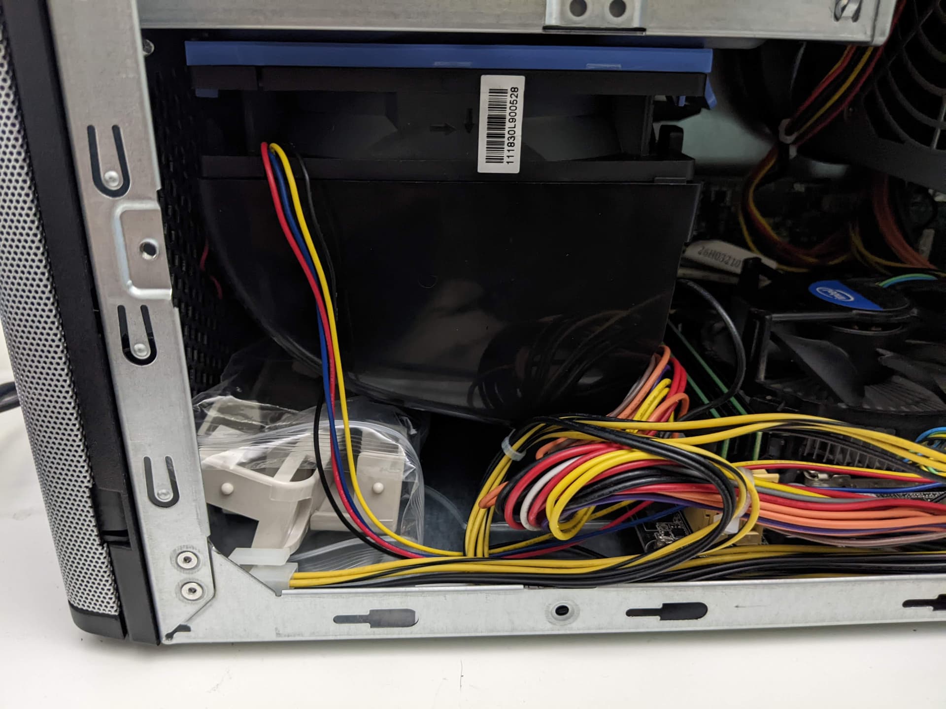

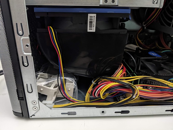

on the topic of the 2.5" brackets, instead of throwing into my black hole box of misc computer parts, i put them in a baggie in the dead space below the fan in case i ever need them, it’s with the case.

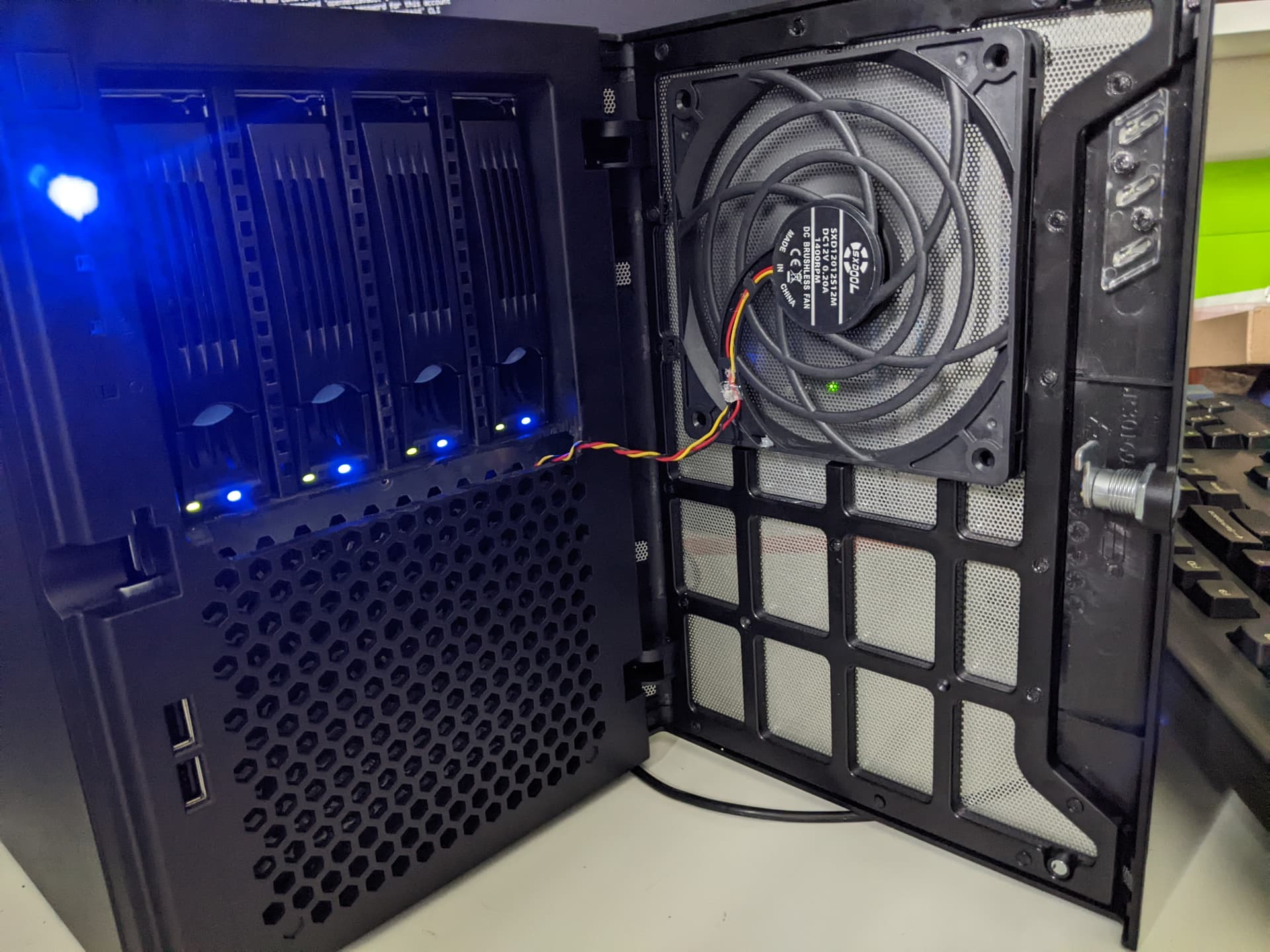

I like to pimp out my electronics with fans
Added fan in front of drives
Took a Dremel to the plastics. Metal shears to snip out a hole in the metal honeycomb. Added rubber grommet for the hole
Fan is 120x120x12
Thickness must be 12 because ebay seller said it was 12 but I received 15mm thick. It did not close

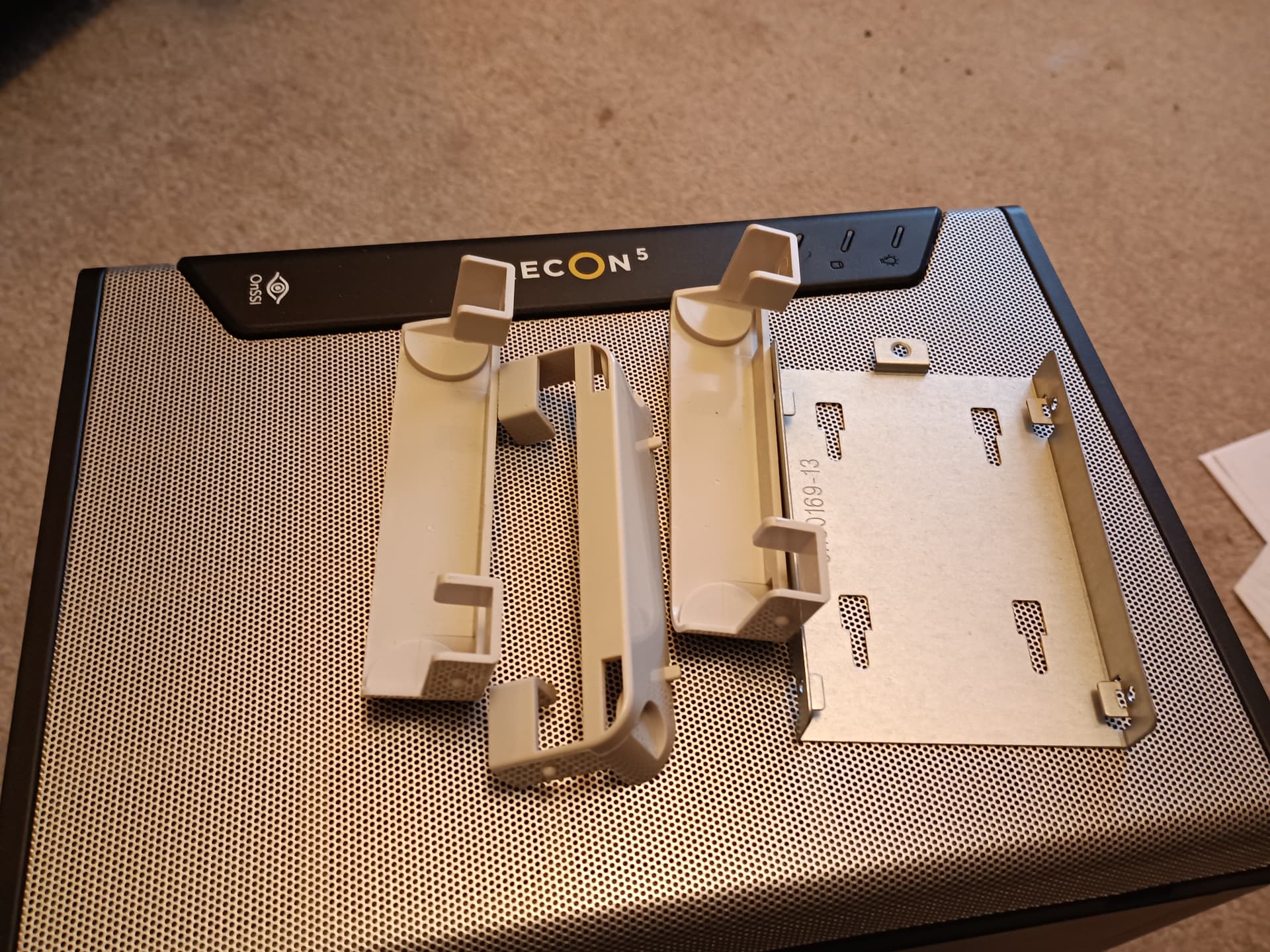

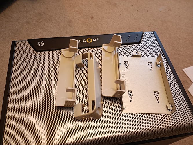

I feel dumb for asking but I cannot remember what the plastic things were for. I assume they go to the drive bay but never used them.
