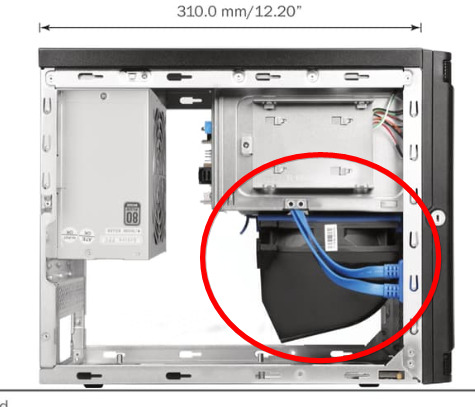

What’s up with the back? No space for a fan? or does that cover come off?
No need for a fan in the rear. There’s one in the front, under the drive cage with a duct.

I already have 2 x Chenbro NAS build , my feeling is love and hate this chassis.
Cooling is not that good, strange air flow pattern,
