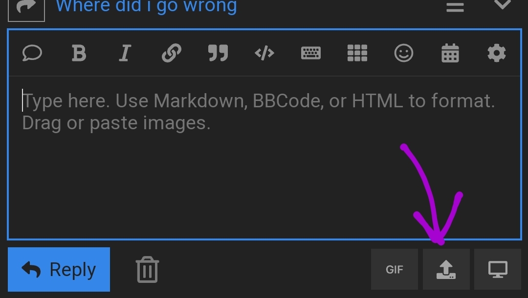

Dont know how to insert a photo but when booting up i got the error (dont know how to fix it either)

Drag and drop the file into the compose box
Unfortunately i am on a phone as my computer is dead

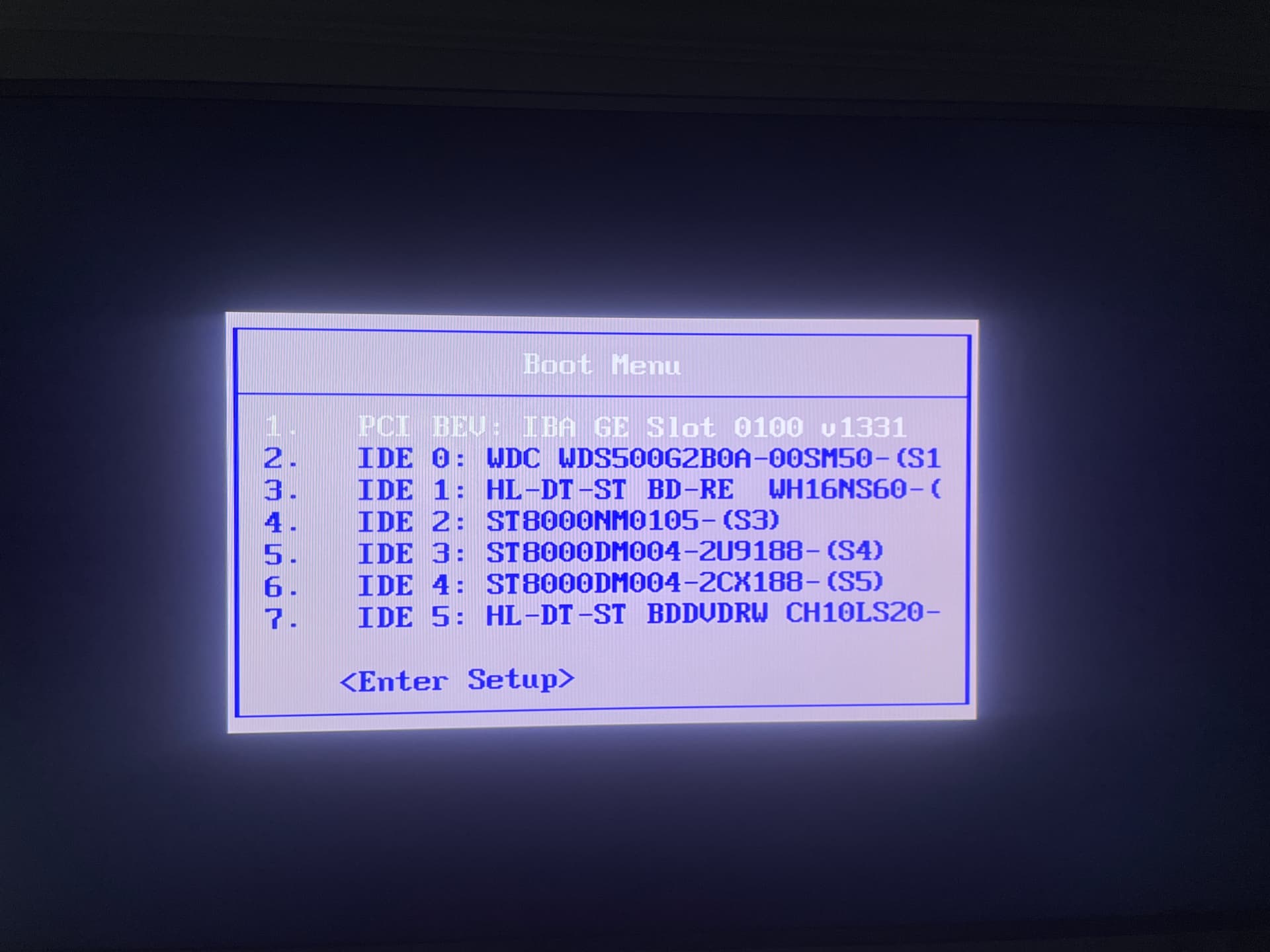

Already tried resetting bios to factory defaults and then seeing boot order only?
This is out if order

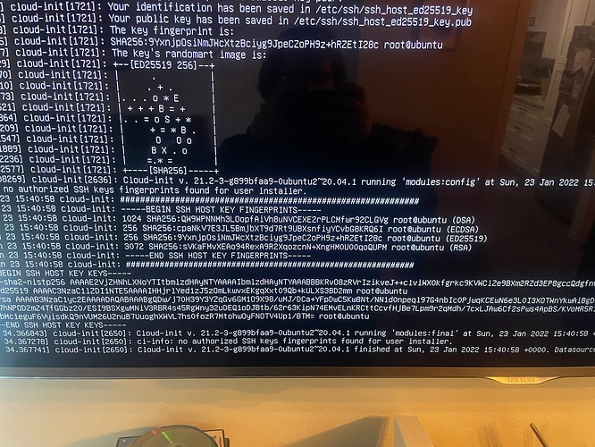

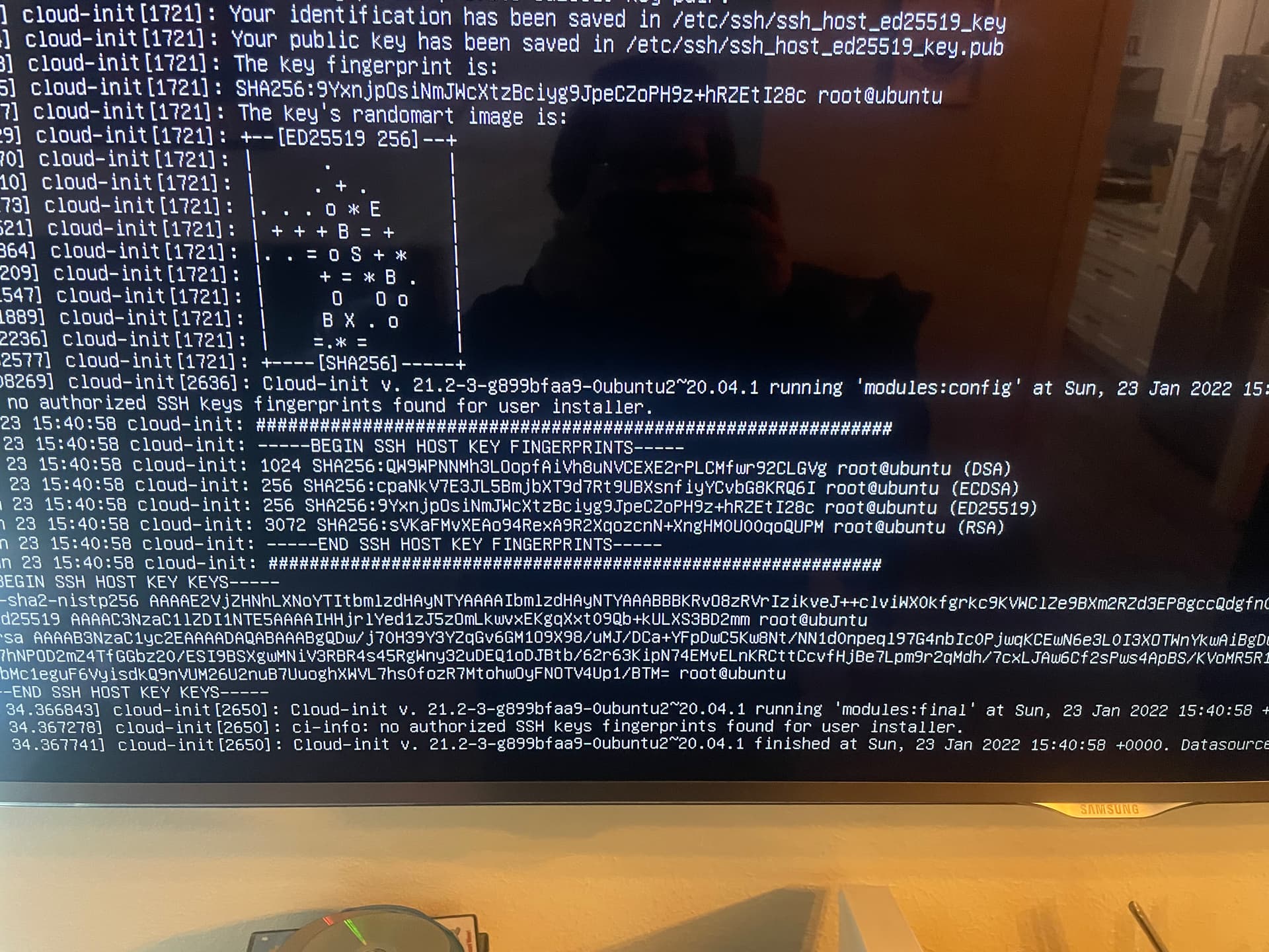

Ok so after various attempts at fixing windows 10, i decided to load uduntu back on. Inserted usb boot to usb loaded ubuntu server not sure where it loaded to as i walked away and came back to this screen
After that turned it off and back on windows loaded perfectly fine so obviously ubuntu didnt go to the 500gb ssd, and i can see the 3 8tb hdd but i dont see any of the 2 yb so my concern is not i overwrote the lsi sas controller
Wait, are you saying that Ubuntu installed itself without any input from you?
Used yumi and selected install to first hard drive
and didn’t check which disk it was? you can boot up ubuntu as a live disk and see what the partition tables for the connected devices look like.
fdisk -l should get you started
