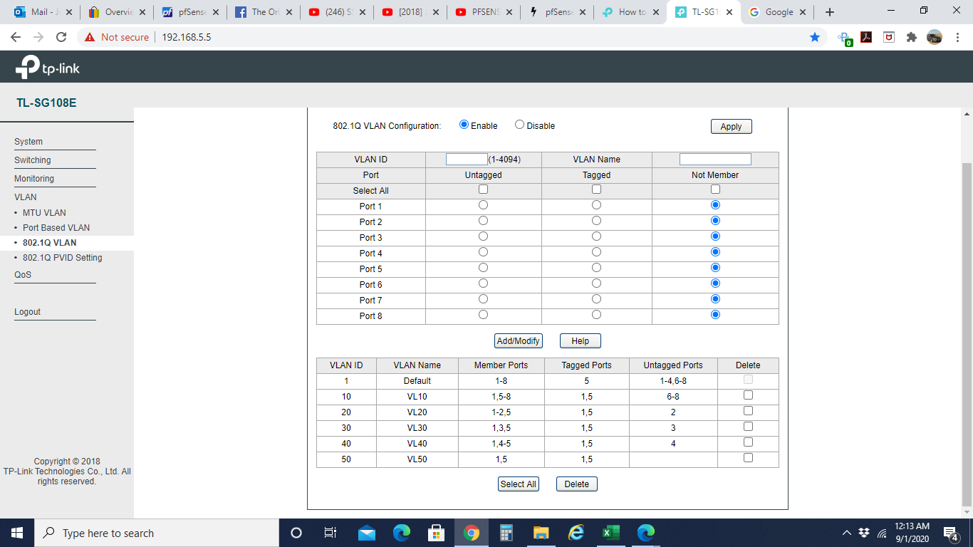

I am trying to setup the Vlans on this switch but nothing seems to work for me. I followed the examples from the TP-Link website and that still did not work. Do anybody on here have this switch that can share how to set this up? Here’s a screenshot of what I did below:
Did you configure the PVID for the ports? PVID (or Port VLAN ID) tells the switch what VLAN ID to add to untagged packets that arrive on each port. So, for VLAN10, you want to set PVID on port 6-8 to 10, same goes for VLAN20 on port 2, and so on.
