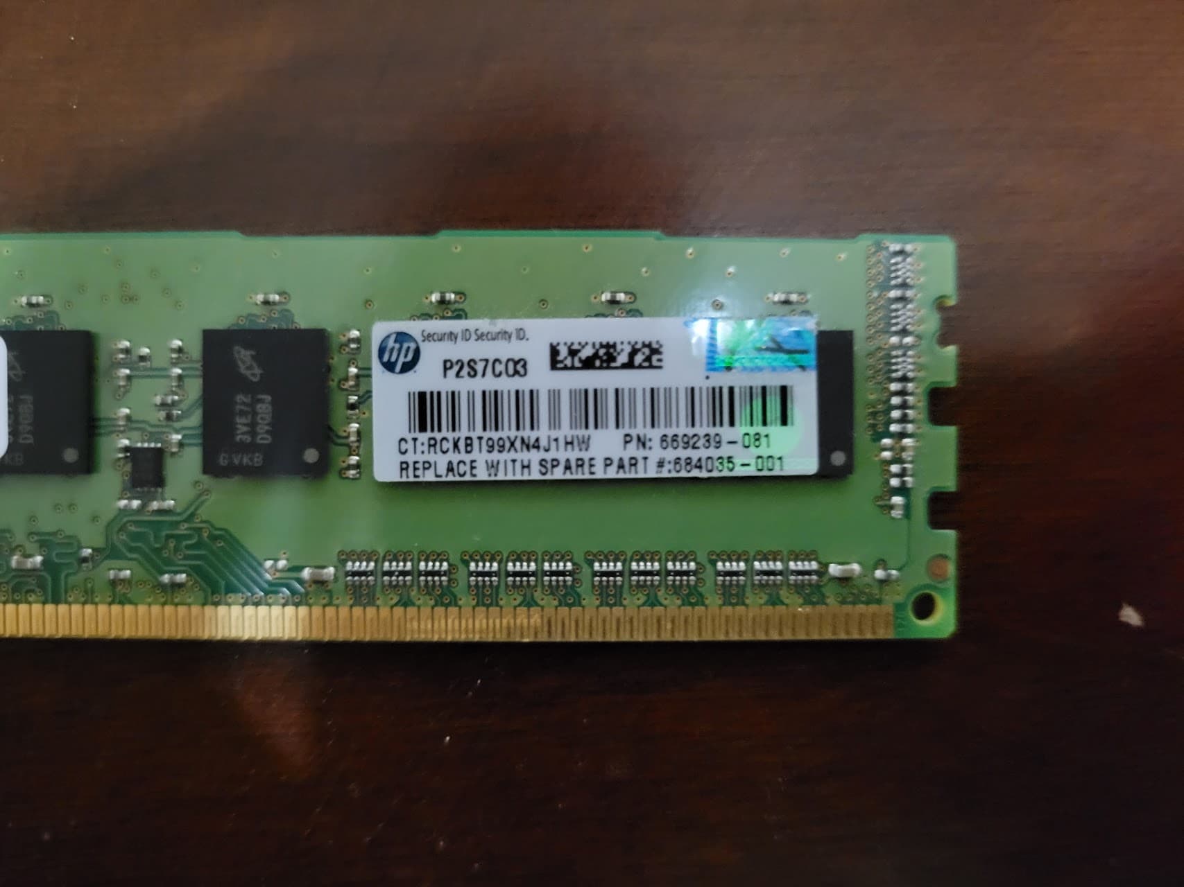

Which RAM and CPU are you using in your build?
@JDM_WAAAT I harvested the hardware from a Chenbro NR12000 Processor is a Xeon E3-1230v2, 32GB DDR3 Unbuffered ECC RAM Picture of the ram sticker is included.
