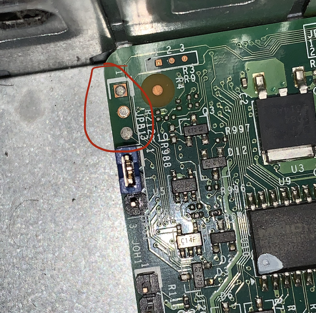

I looked up my manual, and it says to change jumper JPB1 from 1-2 to 2-3 to disable IPMI/BMC. Problem is, my motherboard doesn’t even have this jumper.. it’s missing!

You can try shorting pins 2 and 3 by using a metallic object that bridges the gap between the solder for pins 2 and 3 (assuming the solder in each pin hole is above the level of the pcb). think small coin, better small washer or nut though in a pinch with steady hands a pair of needlenose pliers opened to span the gap during post will do the trick too. You need to be very careful and not come into contact with other traces or components on the pcb while doing this.
As @JDM_WAAAT said you really should be doing this outside the case at this point too.

I shorted with a flathead screwdriver and it worked like a charm. Was able to get past the initial boot loop, boot from USB key and update bios.
