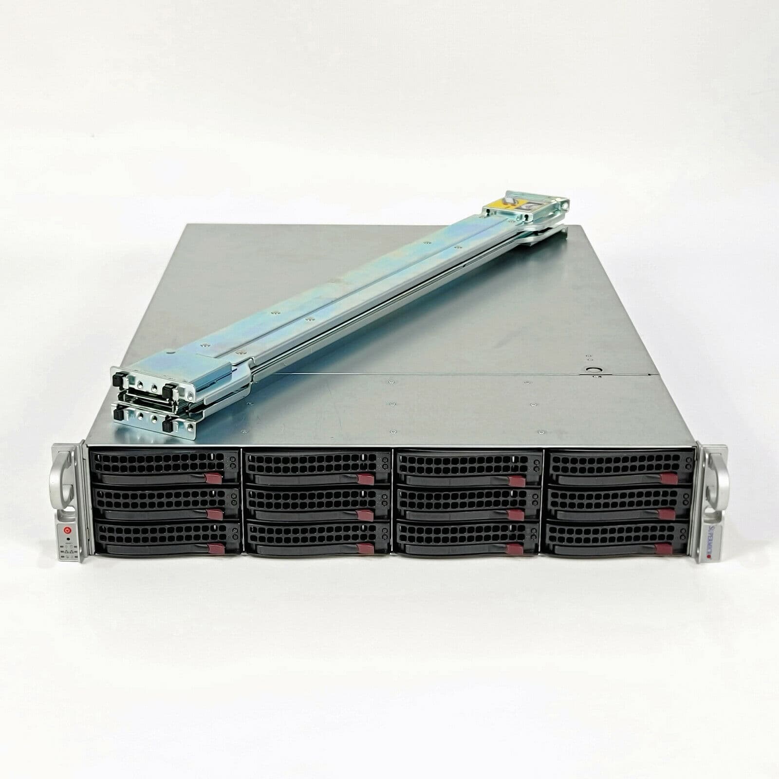

Supermicro CSE-826 2U Chassis BPN-SAS2-826EL1 2x 500W PSU w/ Sliding Rails and 12x Trays - $250 shipped
Supermicro CSE-826 2U Chassis BPN-SAS2-826EL1 2x 500W PSU w/ Rails and 12x Trays
  • CSE-826 Supermicro 2U SuperChassis
  • BPN-SAS2-826EL1 12x3.5 SAS/SATA 6G BACKPLANE
  • 2x PWS-501P-1R 500W PSU
  • Sliding Rack Rails
  • 12x 3.5" Drive Trays/Caddies
  • Air Shroud Baffle Cover
$175 + $75 shipping
