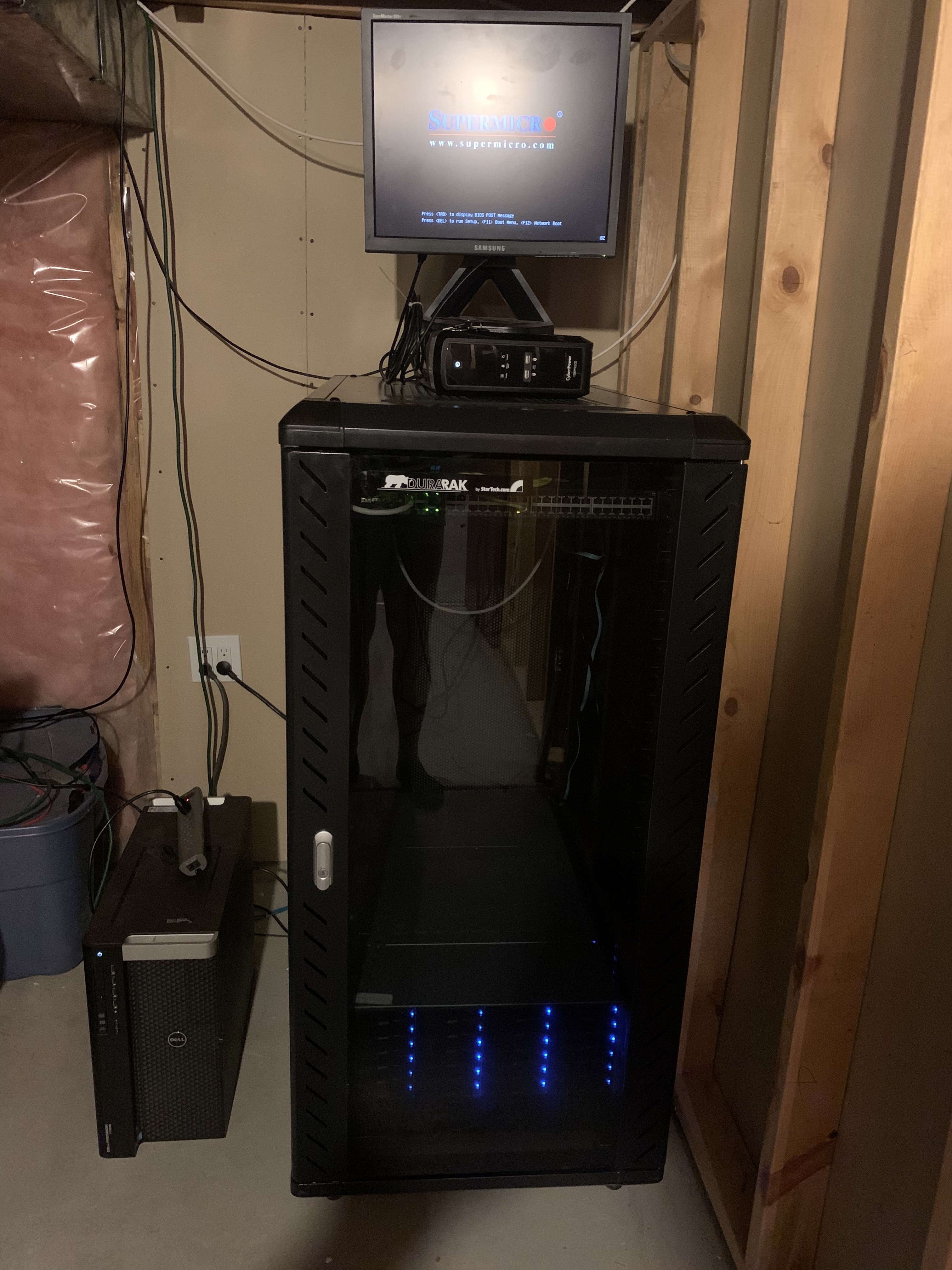

I picked this up for $300 off craigslist. I think I did pretty good compared to new. I considered JDM’s recommendation for the 25U open frame very heavily but I was really set on something enclosed to help with sound deadening. I plan to add some sound absorbing foam on the inside but for now I am just running it normal so its still really loud. I am considering framing and sheet-rocking in a “closet” around it (in my basement) to further help reduce the noise.
Probably better off baffling it all around with foam or something and making sure your air flow is solid. The more impediments you have to airflow and the better you sound insulate, you also insulate thermally.
I personally would avoid any type of foam inside an enclosed frame.

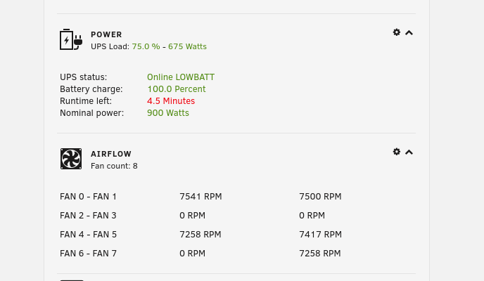

@seanho no its an 848A with the 4x CPU setup. When I ordered it from the server store I was hoping for more horsepower and cores for virtual machines in my homelab and it was trivially more than the 846 dual cpu setup. The main problem is it uses different power supplies than the 846. I have 3x of the PWS-1k21P-1R 1200W. Can I swap those out for the PWS-920P-SQ? Unraid says I am using 900W nominal power but I think thats based off the UPS:

I bought the artic P8s for the fanwall modification but I stopped myself as I seem to have thermal struggles with the fans that in this unit to begin with and I am concerned they wont push enough air.

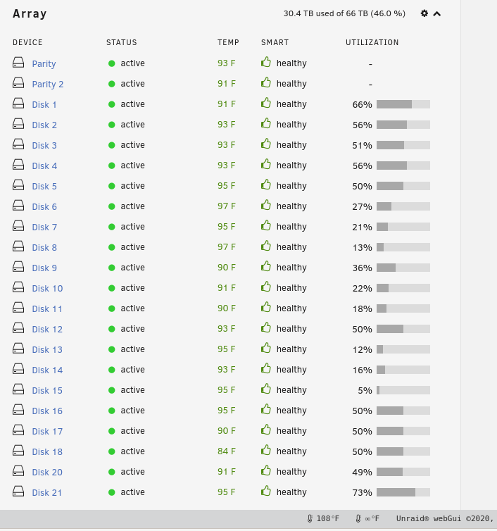

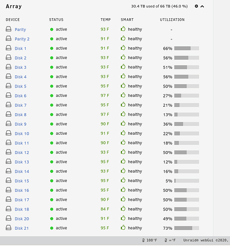

Kinda hot for a nice cool fall morning in my basement…

Your drive temps are fine. Switch to C.

I believe both the 920 SQ and the 1200 R use the old-style PDB. It’s the 1280 SQ that needs the newer PDB.
very late UPDATE - I recently gave got fed up with the noise, well I should say my wife’s complaints were more the problem ;-P, and I pulled the trigger and purchased those 920SQ power supplies. I just received and installed them. OMG what a difference. Thank you for the excellent advice all.
