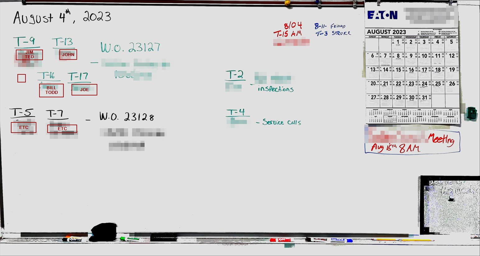

I am looking to automate taking a picture/video of a whiteboard periodically throughout the day and then update to some kind of dashboard/intranet site.

The information that gets put up on the board is the groups of utility workers and what jobs are on task for given workday.
This pic was taken with Microsoft Lens which does a great job of cleaning up written text but this is a manual process.
