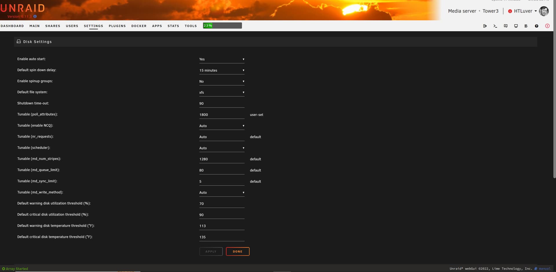

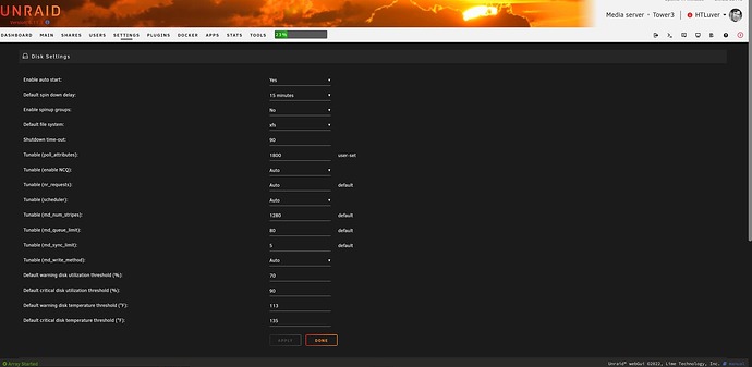

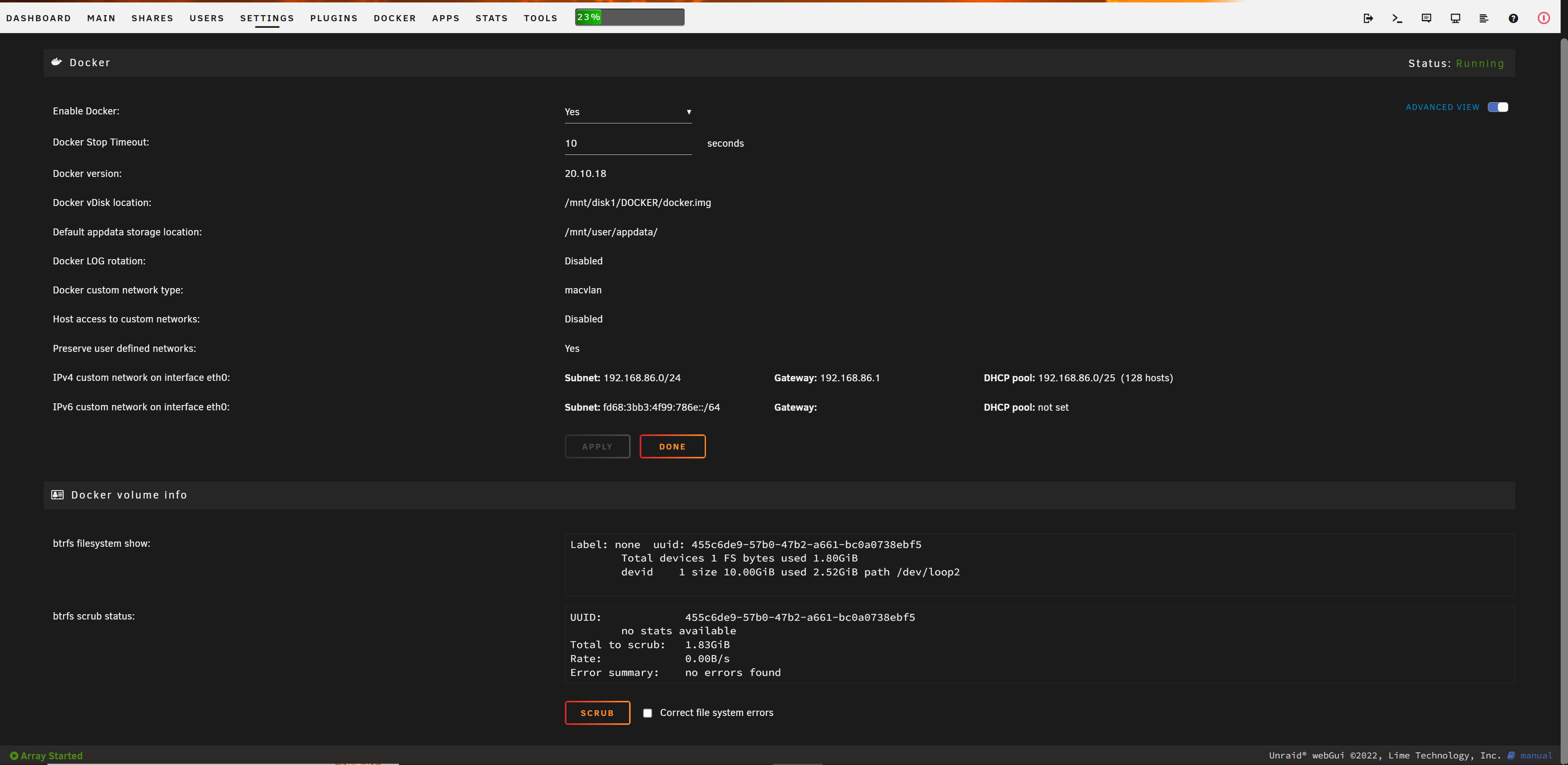

Can you send us some screenshots of your Unraid array config, along with the docker container config?
I think I have it down to when the server has activity on SABnzbd and the processor is hitting 50% or whatever it is at and I try to watch something on PLEX it stutters. Especially when SABnzbd is unpacking and the processor is really getting hit nothing is watchable. Does that make sense?
