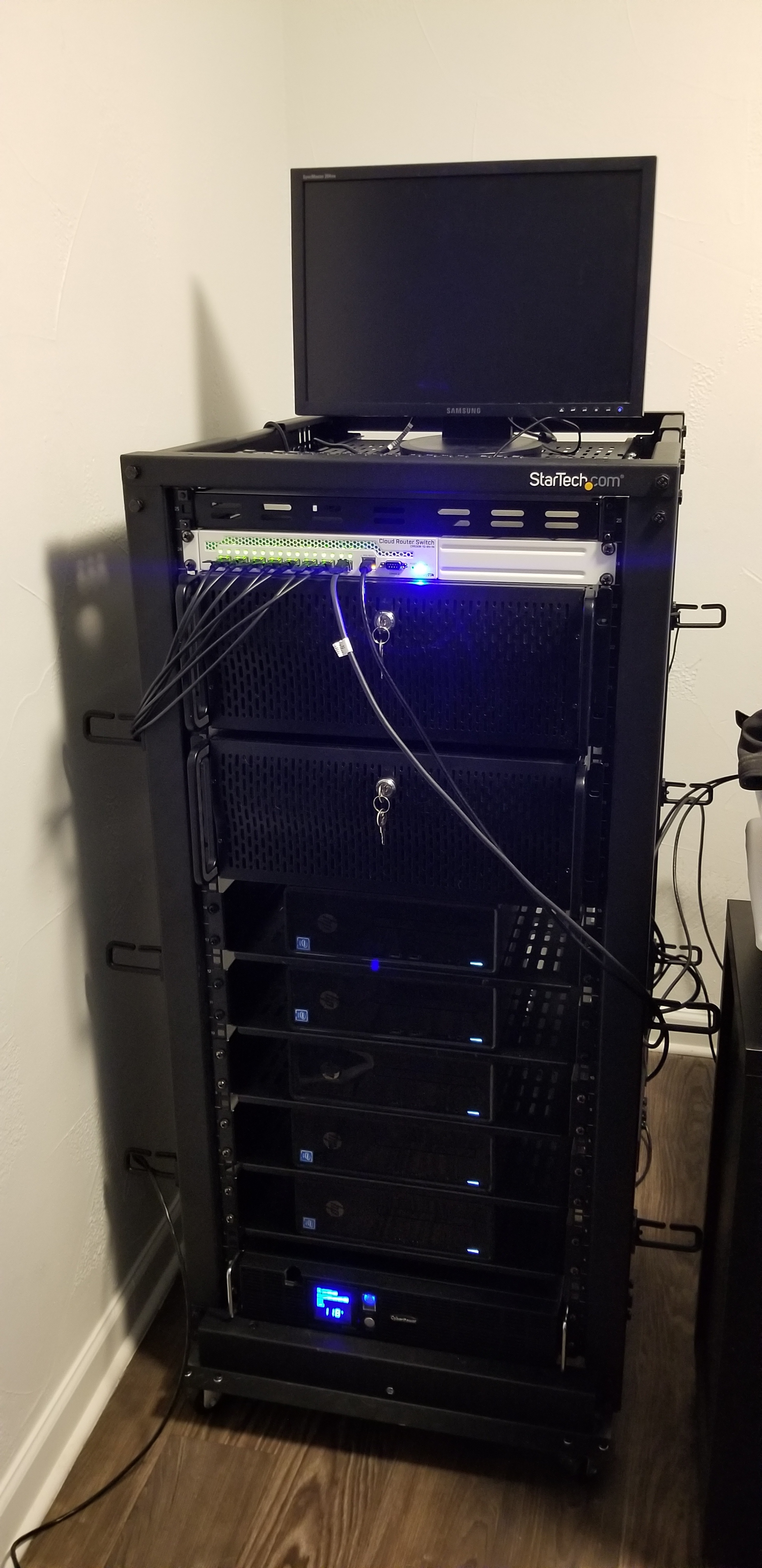

Just finished my NAS Killer 4.0 Build with 5 HP 290s. I’m using these shelves @ Amazon.com
In total 5 290s take up about 12U of rackspace

What is the breakdown of your stack? I see the two Rosewills which I assume is your storage. Are they setup as independent NAS with their own motherboards or DAS and being controlled by one or more of the 290’s?
I’ve actually been wanting to ask JDM the same question, how he split up his services among his many, many 290s.

@roblun68
4U Server Case #1
Windows Server 2016
AMD FX8350
16GB RAM
1x 240gb SSD
2x Toshiba 3TB 7200RPM HDD
For running a few VMs to host tautulli, radarr, sonarr, lidarr, tdarr, etc
4U Server Case #2
NAS Killer 4.0
unRAID OS
Intel Xeon E3-1270V2
Supermicro X9SCM-F Server Motherboard
Arctic Freezer 12 CPU Cooler
32GB Unbuffered ECC RAM
1x 512GB Cache SSD
10x Seagate ST6000NM0034 6TB 7200RPM SAS HDD
2x Dell H310 w/FH Bracket PERC Adptr (3P0R3) Flashed to IT Mode
EVGA 850 Bq, 80+ Bronze 850W Power Supply
Replaced all Rosewill Fans with: ARCTIC P12 PWM PST & Arctic F8 PWM PST
MikroTik 9-Port Desktop Switch 8 SFP+ & 1 Gigabit Ethernet
All Servers using HP NC522SFP Dual Port 10GbE cards
Using Cable Matters 10GBASE-CU Passive Direct Attach Copper Twinax SFP Cable
5 HP 290’s on 2U Shelves
16GB RAM
1x 240GB SSD
CyberPower OR1500LCDRT2U Smart App LCD UPS System, 1500VA/900W, 8 Outlets, AVR, 2U Rack/Tower
All in a StarTech.com 25U Open Frame Server Rack
Also: A large amount of kapton tape
@ajs
Love the Mikrotik switch. Lots of features and highly configurable. So far no issues with L2 management
So 4U #1 and all the 290s are using the NK4 4U for storage?
What all are you doing with the 290s?
So you have one of the 10Gbe cards in both 4U and the 5 290s?
@Jason_Standiford
Yes they are all using NK4 for storage.
2 290s are PLEX servers, 1 is going to be a Pfsense box, the other 2 I havent decided uses yet. Will probably use them for VMs/other homelab projects.
Yes I have the 10Gbe cards in both 4U servers and the HP 290s. They fit pretty well in the 290s. Couple things to note: You’ll need to get low profile mounts for the NIC cards. You will also need Kapton tape and need to tape off B5/B6 PCI connectors on the cards in order for the 290s to boot properly. I also noticed for some reason the HP NC522SFP have coil wine when used in the HP 290s. I did not observe coil wine in when used in both 4U cases.
