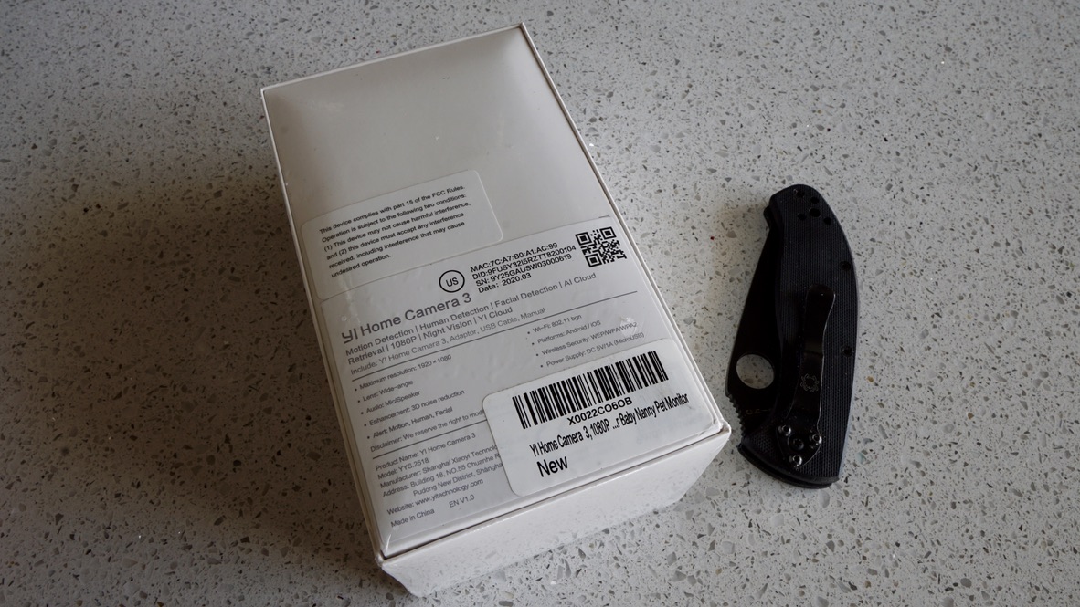

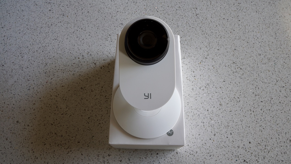

Small box, nice packaging. Not bad for $20.

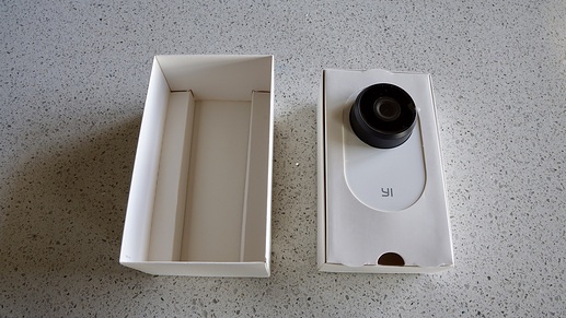

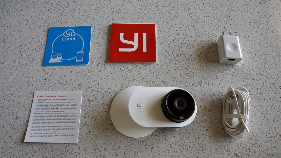

Box contents - a few user manuals, camera, Micro-USB cable, and wall wart.

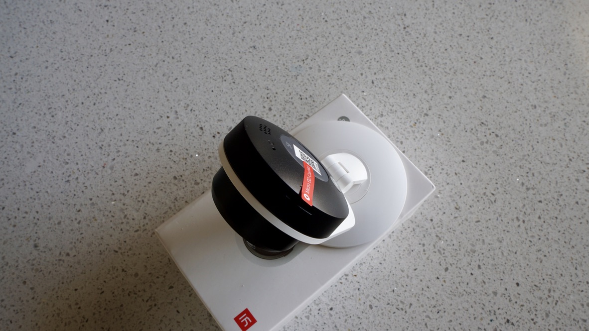

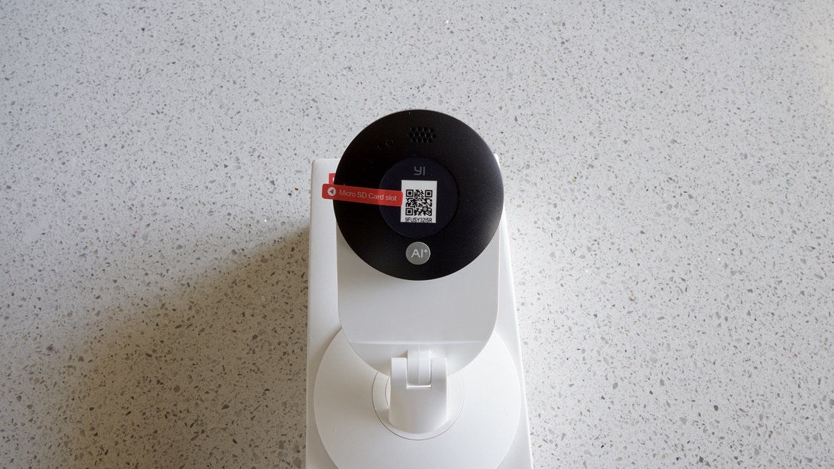

Red sticker indicating where the micro SD card slot is, about “9 o’clock”.
The USB power is at “6 o’clock”.

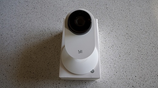

The QR code is to identify the model of the camera, nothing else. It is also identified by the first four characters, in this case “9FUY”.

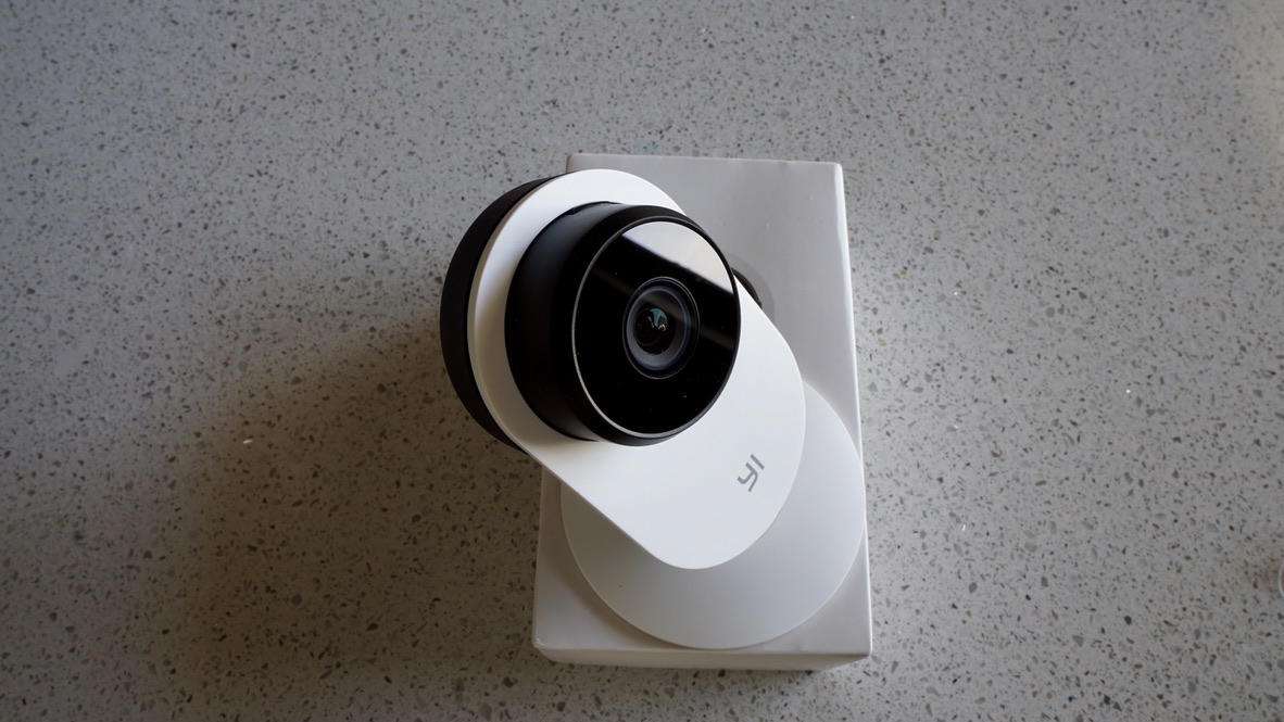

The lens actually looks pretty nice.

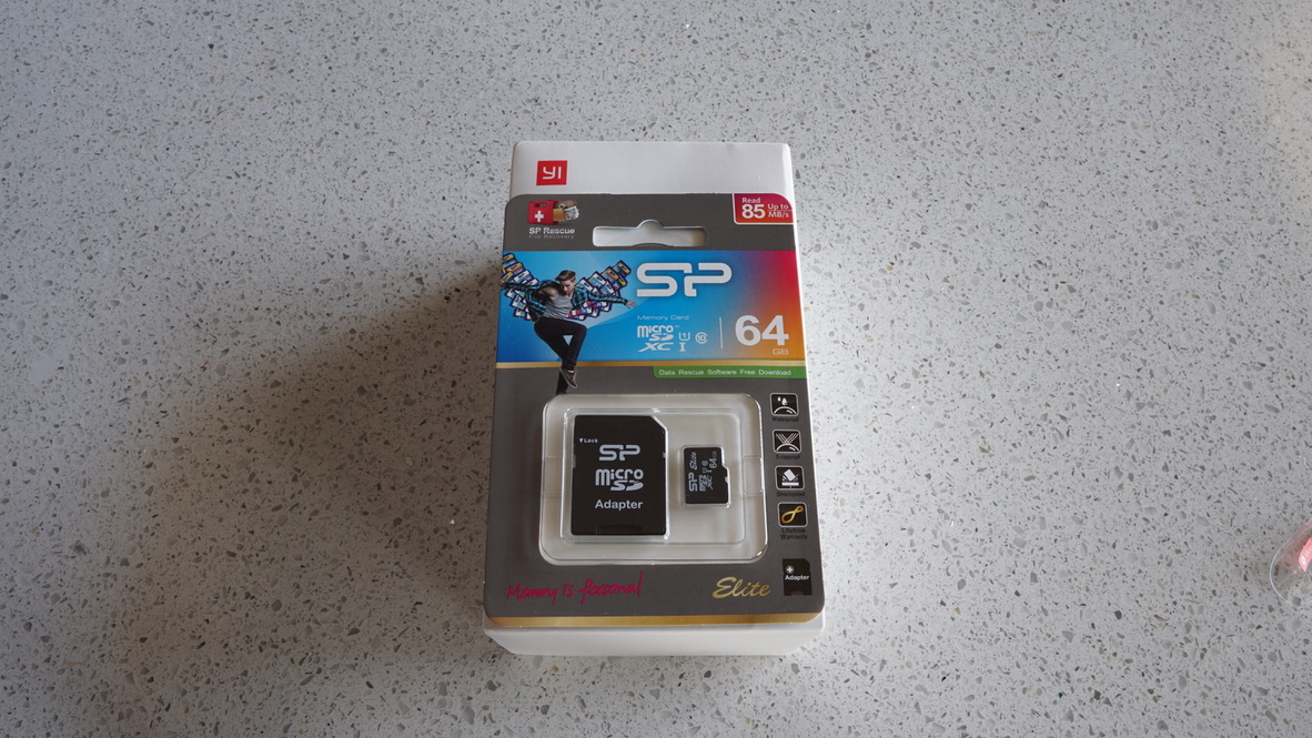

Silicon Power 64GB MicroSD card - pretty much any brand will work.

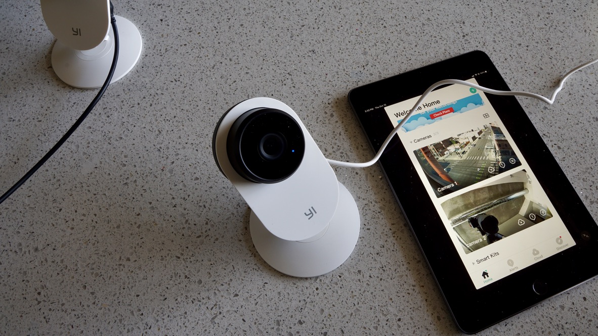

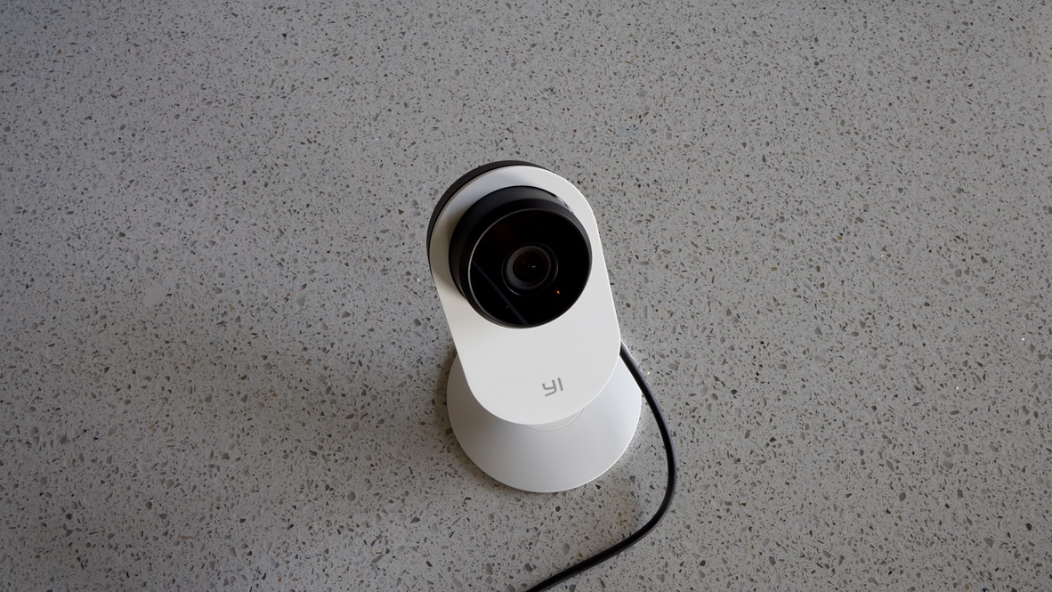

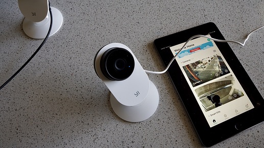

Here’s the yi app running on my iPad mini. Notice the LED light is blue, indicating normal function. You can turn this off with the custom firmware.

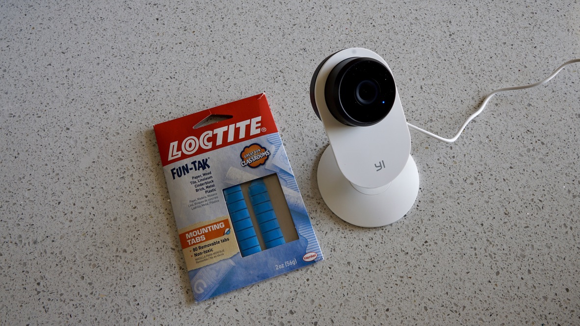

BluTack will come in handy with these guys. They are super light and they can mount anywhere without damaging the surface.

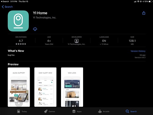

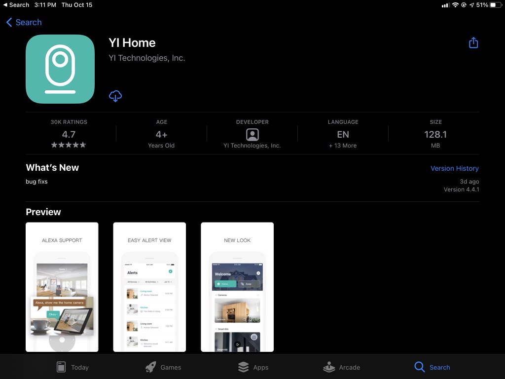

Here’s the correct app. There’s a few results in the Apple App Store, probably more in the Google Play Store.

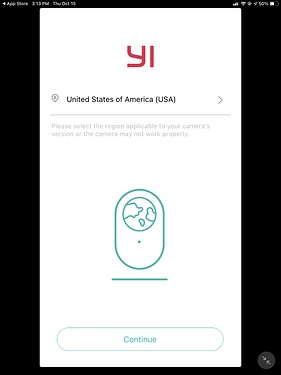

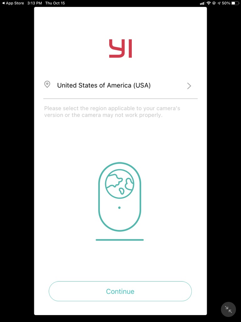

Select your country.

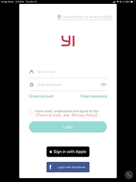

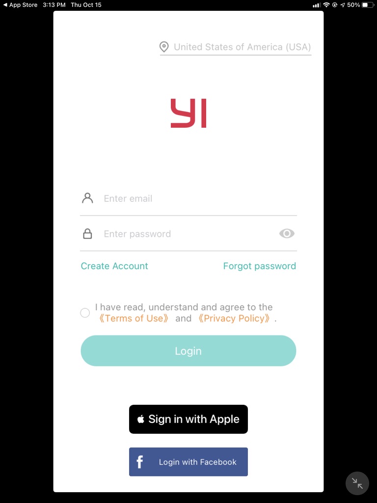

I logged in with Apple. Once you use this account to set up your cameras you won’t have to use it again.

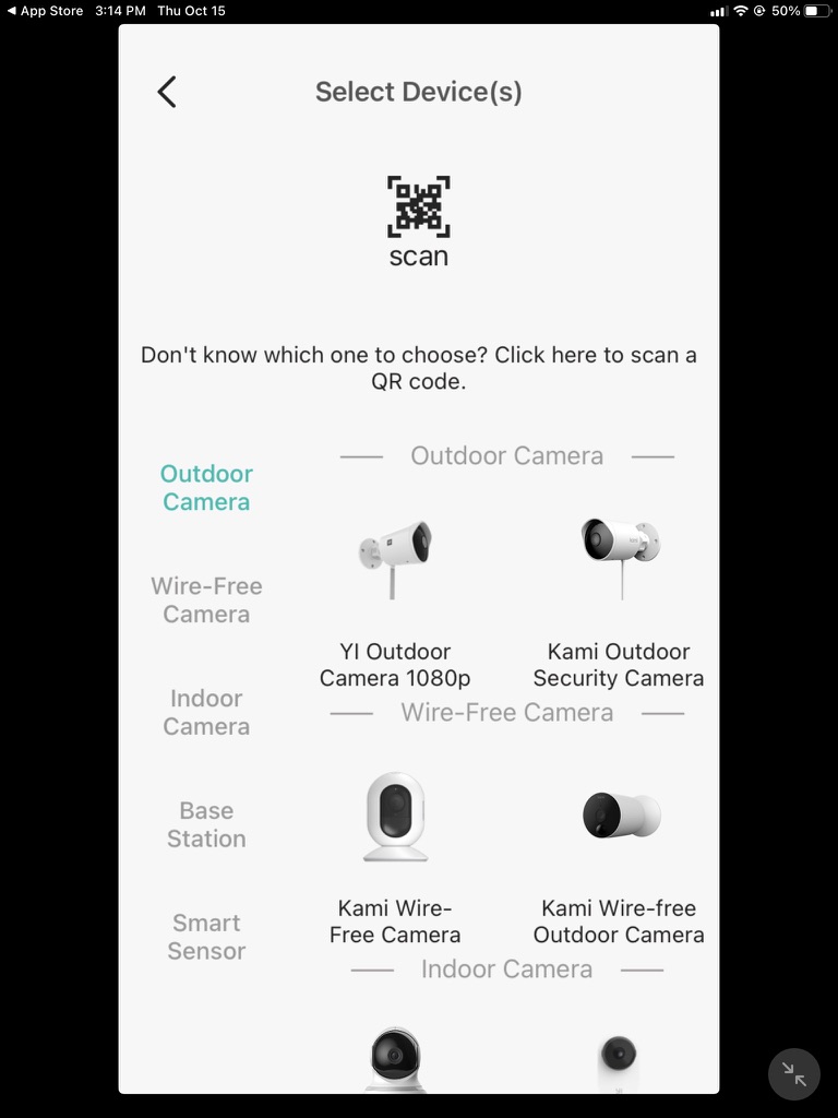

Tap the top right “+” to add a camera.
Scan the QR code on the back so the app knows how to pair your camera.

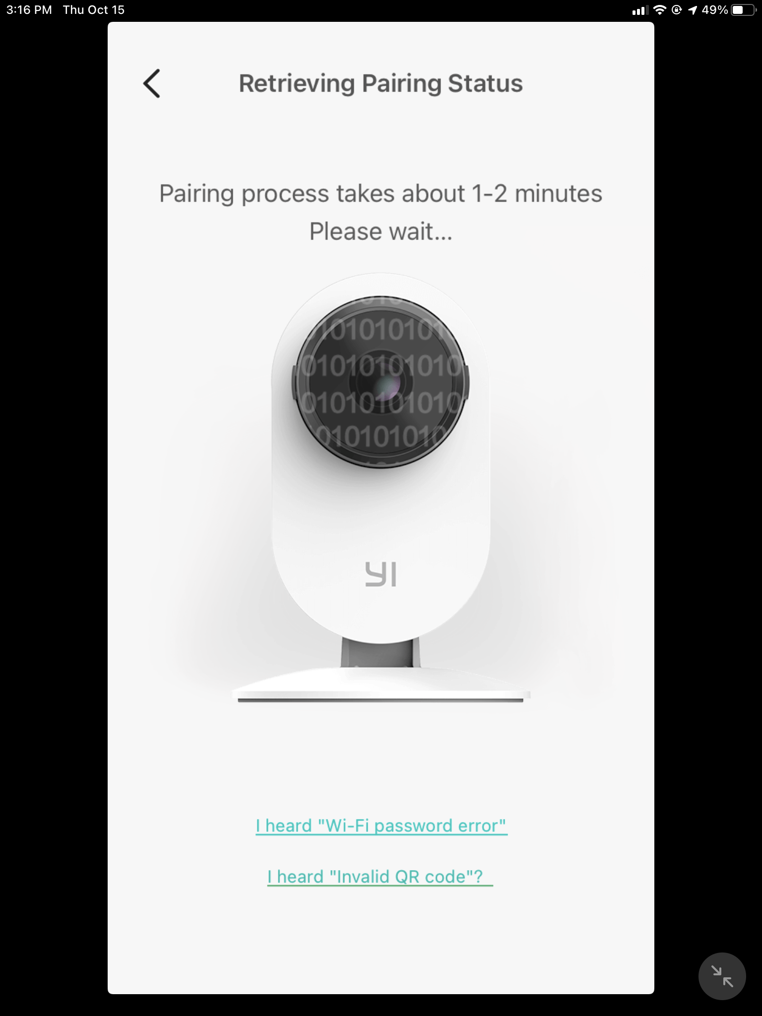

Type your wifi password.
Place the QR code in front of the camera.

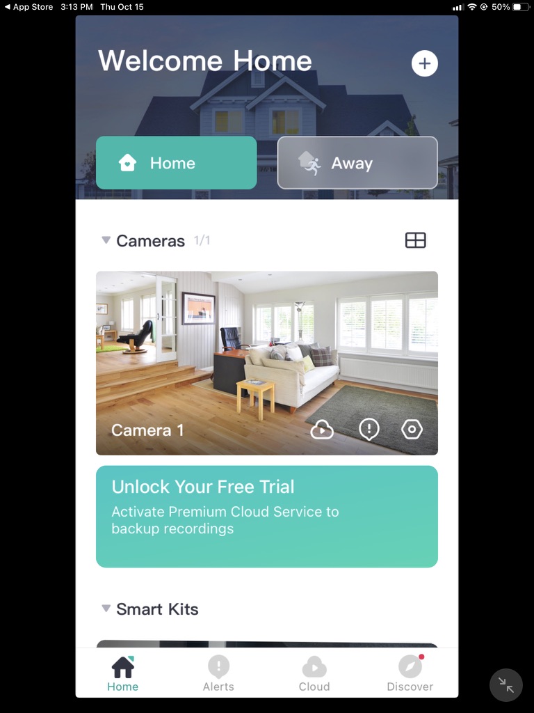

Here’s how the app displays cameras.
