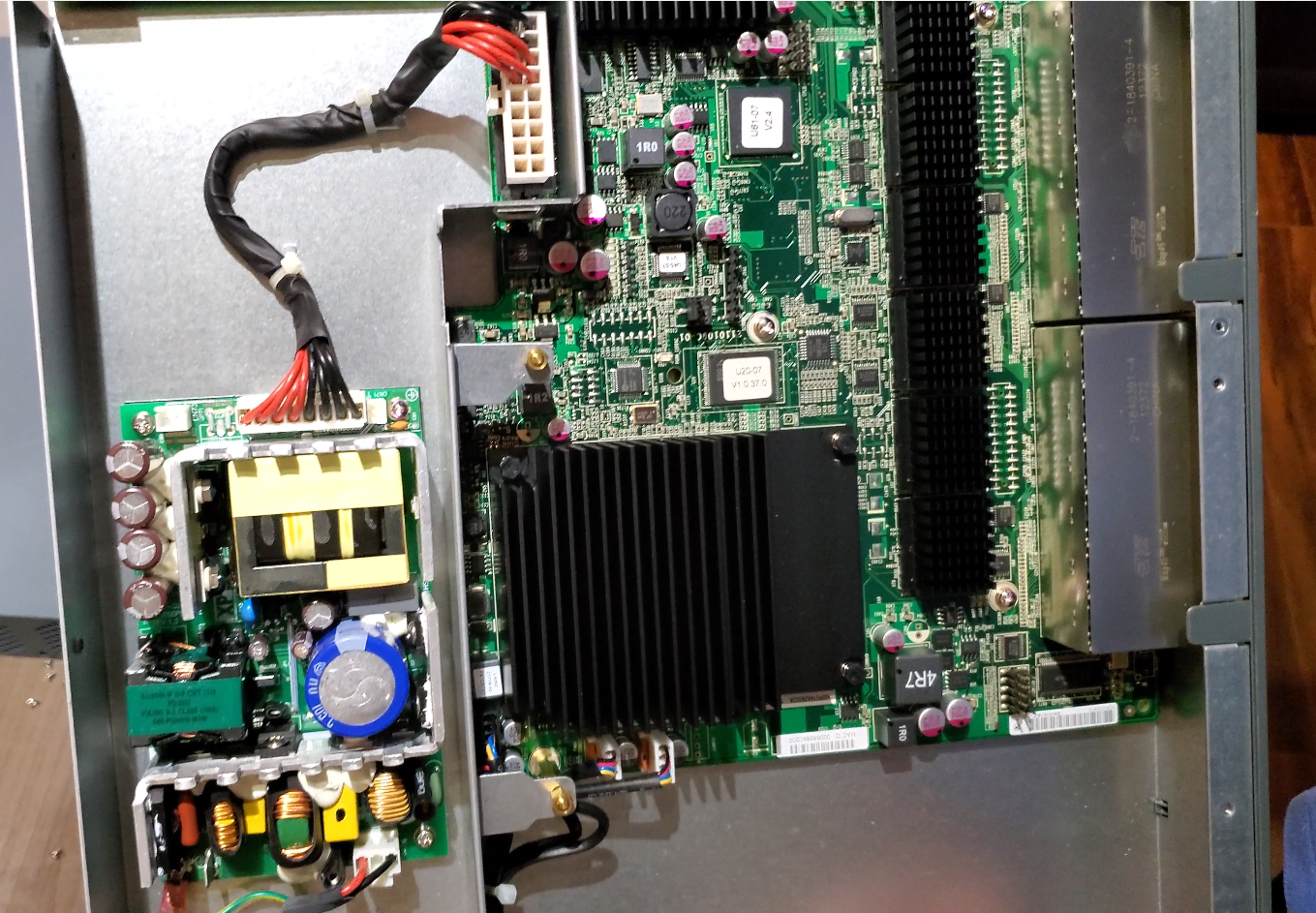

Well it arrived, picked up the S2500-24t as I said, this thing looks like it came off the shelf new, its in such good condition.
Opened it up and inside itâs immaculate. If only I had the DAC cables and/or FPS+ gbics onsite.

Pic from inside.
