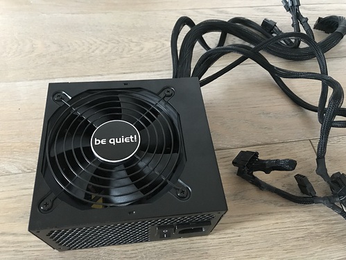

PSU Be Quiet! System Power 9 400W 80+ Bronze 139 PLN (used)

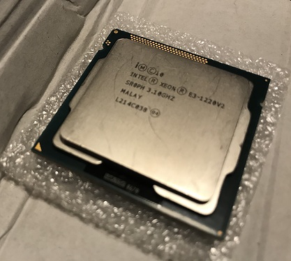

the processor

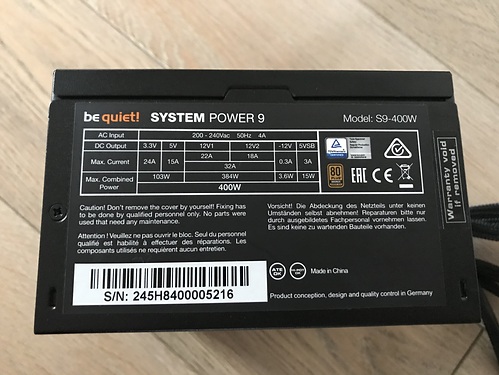

and eventually the PSU

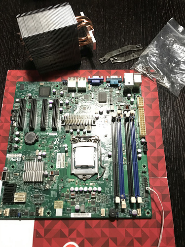

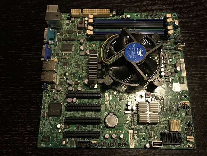

Some of the parts, like CPU cooler and disks are still used in my current setup, so they will find a new home later on. I’ll use the boxed Celeron cooler for table top build and testing.

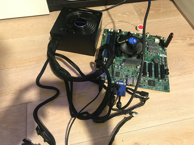

The initial setup went good. It was actually a floor, not a table top build (see picture) :slight_smile:.

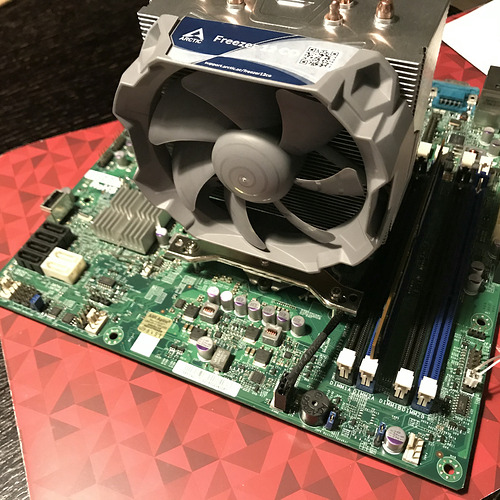

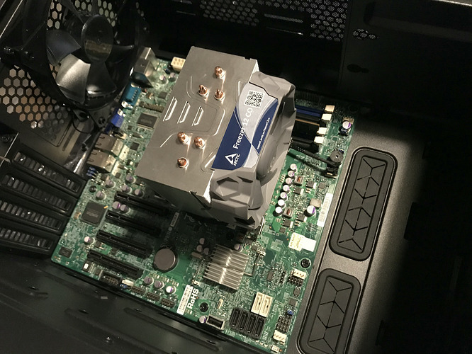

The cooler and memory are in place
I made a mistake though, by starting to tighten the screws with the screwdriver from the beginning. They are pretty loosely fitted and I put more force than needed. It is better to start with bare fingers, to “catch” the treading first.

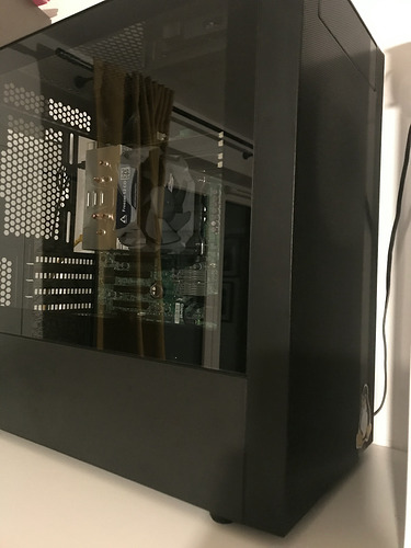

In da case
Power on test successful
Looking good!

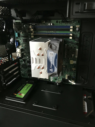

I finished the build at 2AM that night and haven’t time to update.

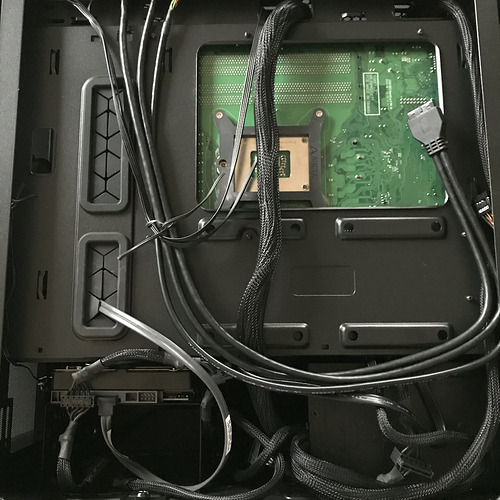

Cables definitely need more management (after I buy second HDD)

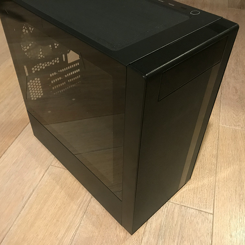

The front looks pretty clean IMHO
Some takeaways from the build process:

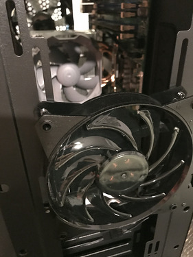

  • this case has 2 fans included, they are 3-PIN so always on. I connected the front one via attached MOLEX to 3-PIN adapter, but the rear one directly to the board. The fans were marketed as silent (reviews confirmed that), but in my opinion they’re not.
  • having set the fan performance in BIOS to Optimal (which means 30% for the FAN1-4 as default) I expected the CPU fan will stop (it’s a semi passive fan, starting at 40%) but that didn’t happen. I wondered if that’s because the 3-PIN fan is connected to the same zone (FAN1-4). I confirmed that partially by disconnecting the rear fan - the CPU would eventually stop (reboot needed), but the next day, after couple of reboots (because I was configuring unraid), the fan went crazy (high-low) cycle again.
  • eventually I set up IPMI connection to be able to read/set the fan settings without entering BIOS, hopefully it works as expected.

how was the stock intel 1155 cooler mounted to the board? did the board originally not have threads in the mounting holes?
