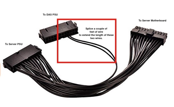

I used a Dual Power Supply 24Pin ATX Motherboard Mainboard Adapter. It works perfectly. The DAS and server truely act as one: the DAS starts and stops with the server, including being controlled by the UPS during power utility outages.
The leg that goes to the DAS PSU needs to be lengthened. I recommend these crimp connectors with built in glue lined heat shrink. And this Titan crimp tool is amazing.
