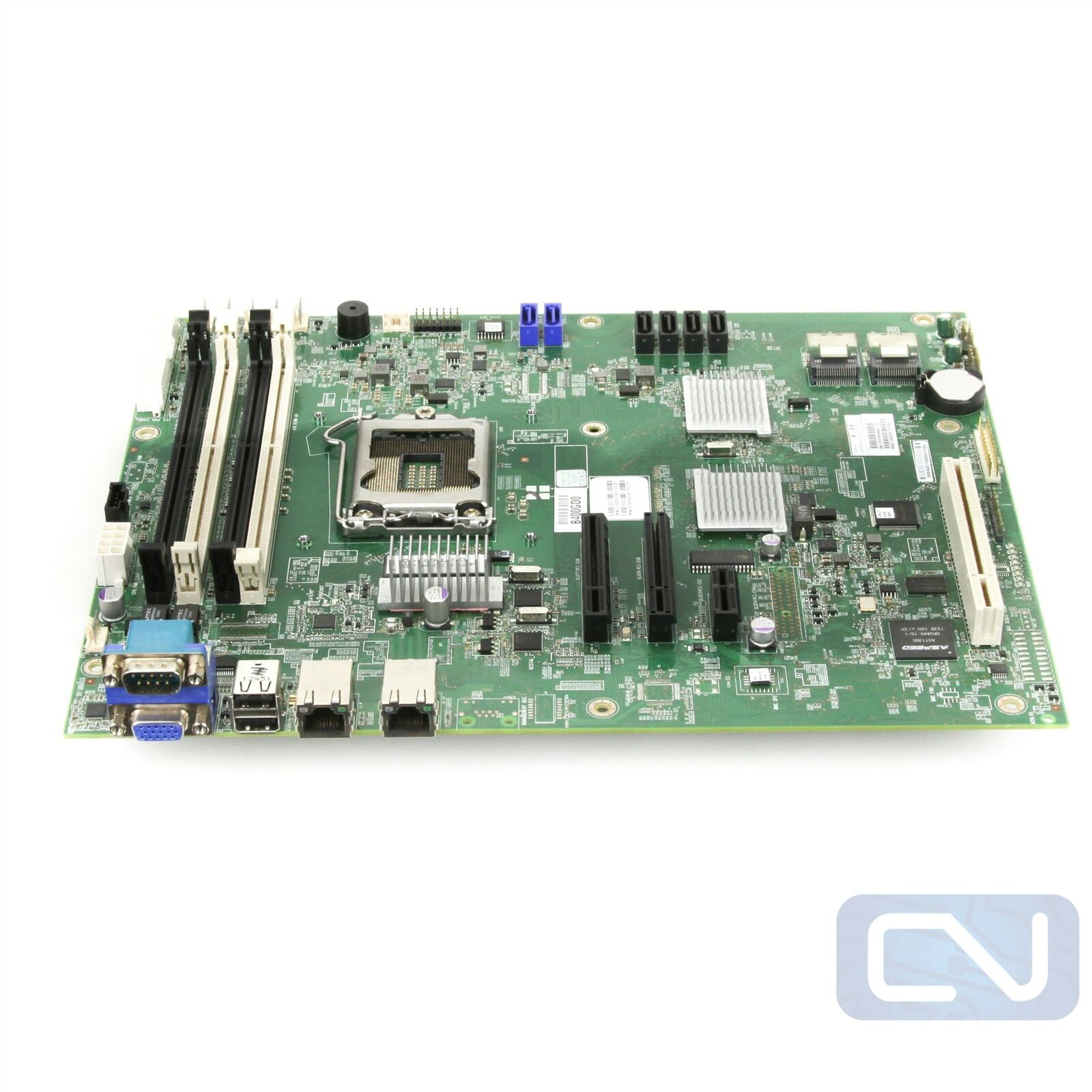

Inventec B400GD0 LGA 1155 motherboard - NK 4.0
Great budget NK 4.0 board, similar features as the B400GA0 featured in the NAS Killer 4.0 guide.
Features LSI SAS 2008 onboard with SFF-8087 ports.
- Good Deal
- Mediocre Deal
- Bad Deal

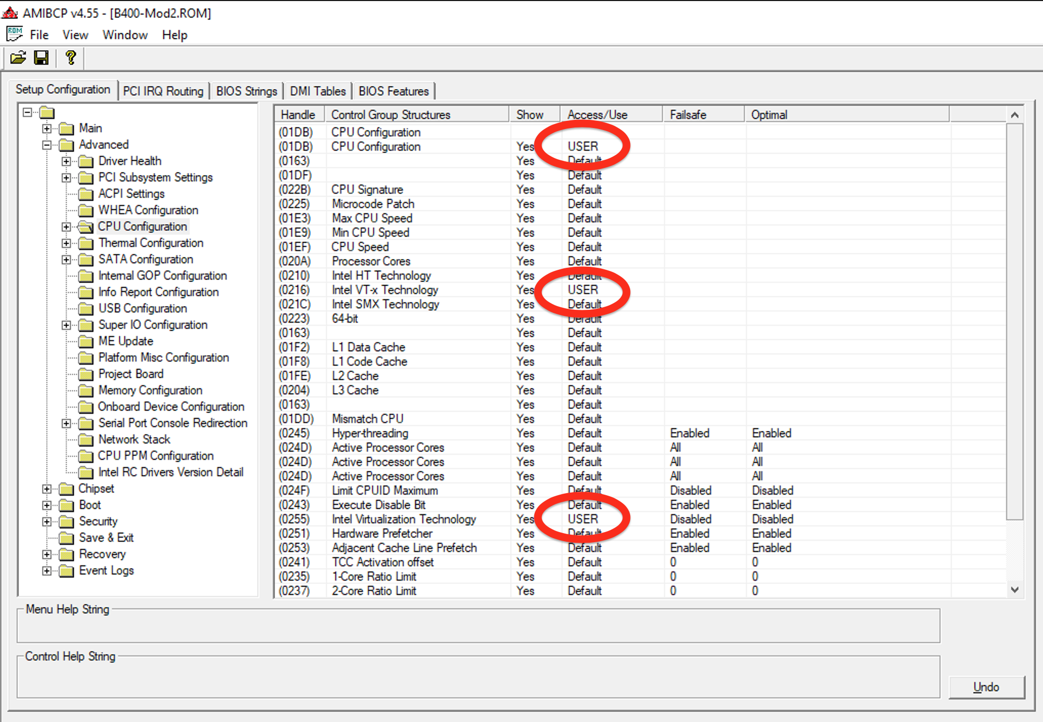

Just FYI: my board arrived with VT-X (i.e virtualization technology) disabled in BIOS, and option to re-enable it not visible. Had to edit BIOS to re-enable it. Straightforward process.
Could you share how you did that?
Sure. You need to find two things:
Boot system to DOS, and using AFUDOS dump BIOS to the usb stick.
AFUDOS BIOS.img /O
I’d recommend dumping it multiple times, to a different filenames, just in case.
Then in Windows, launch AMIBCP and modify three settings from Default to USER.
After you edited file, flash it with AFUDOS
AFUDOS BIOS-mod.img
Reboot system and you should see Intel Virtualization Technology option in the BIOS. I did not try to play with other settings, but I guess setting them all to USER will show them.
Links to the apps I won’t be sharing, but they are easy to find online. If google does not help, try yandex ![]()
Try it on your own risk. No guarantees it will work for you. I’m not liable if something goes wrong.
Are these any different than what’s available on AMI’s site?
AFUDOS from Aptio 4 package will work. (I think v4 is what I used, but don’t have my flash with me to double check).
Other utility is from the first link on this page.

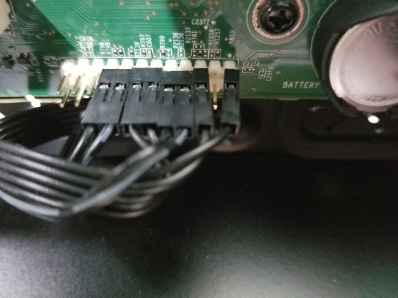

How about what the LED’s on the motherboard mean? I can’t find this information in the manual anywhere. My board has 3 flashing LED’s and won’t boot up, trying to determine what’s wrong.

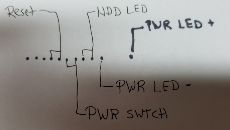

If I understood the chart properly (and there’s a good chance I didn’t) then I have an extra ground wire that I don’t know what to do with. So yeah, the documentation on this board is a bit…interesting.
I used the exact pinout information that Mthrboard posted. I only connected power switch, reset, and hard drive light to keep things simple. Everything I have connected is connected to the top row of pins. I guess you could say the row closest to the processor. See if this image and diagram helps. Take notice of the space I left between Power LED + and Power LED -. That is the missing pin that doesn’t exist between pin 1 and 5 from the pinout table Mthrboard posted. Also, the board has 3 blinking lights when plugged in, but not powered on.
Hm, sorry I didn’t see your post - did you get i working?
