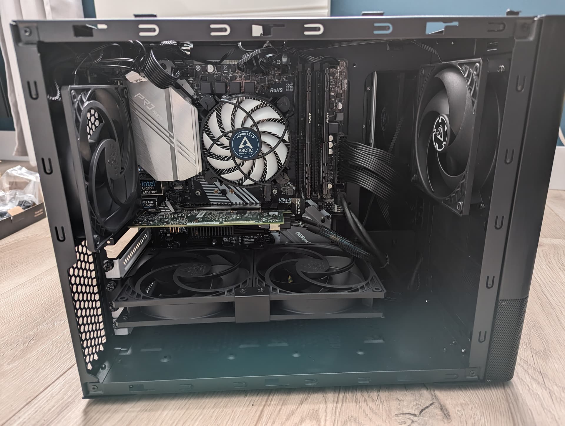

The Fractal Node 804 is a nice case, and I’m loving it but when assembling different parts, you definitely have to be creative with placing components, air flow and cable management, it is a small place to work in.

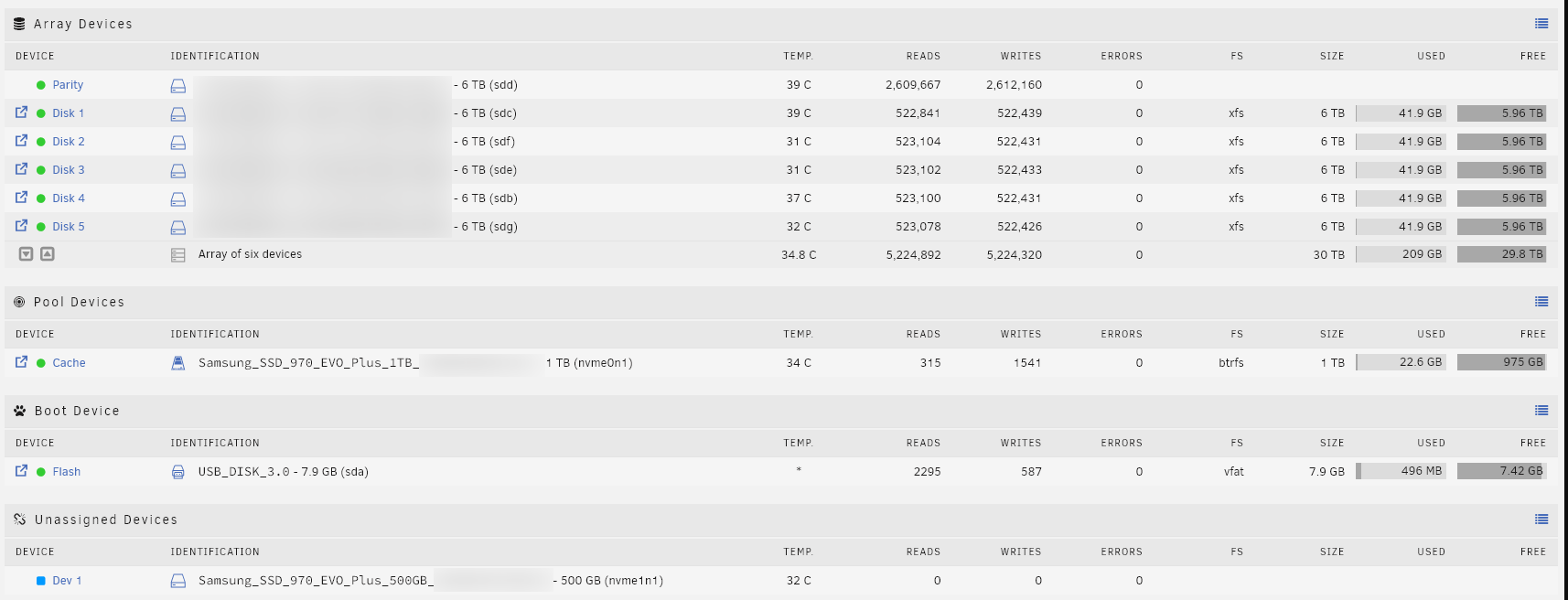

My plan was to build a 30 To NAS with 1 To cache + an unsassigned ssd of 500 Go for applications and docker containers.
I’m pretty happy that even under some load the disks stay at 40 degrees, which in a case like this is pretty good, and in order to achieve that I snitched a vent in between the disk bay, otherwise it would reach the 50 degrees.

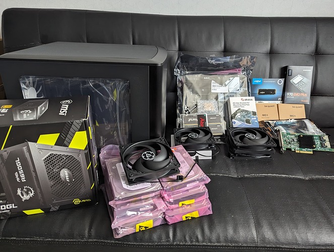

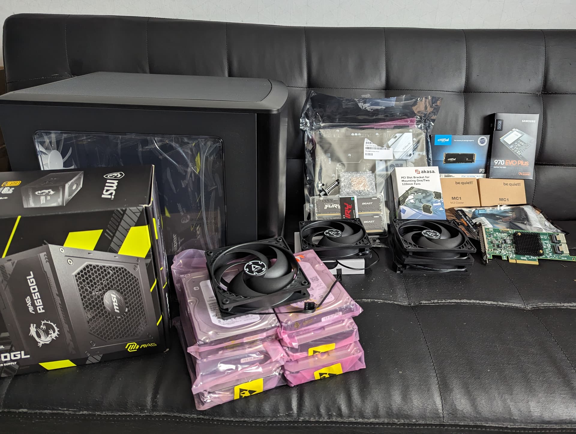

Here are some pictures of the build:
Almost all the parts received
Cooling the LSI Card

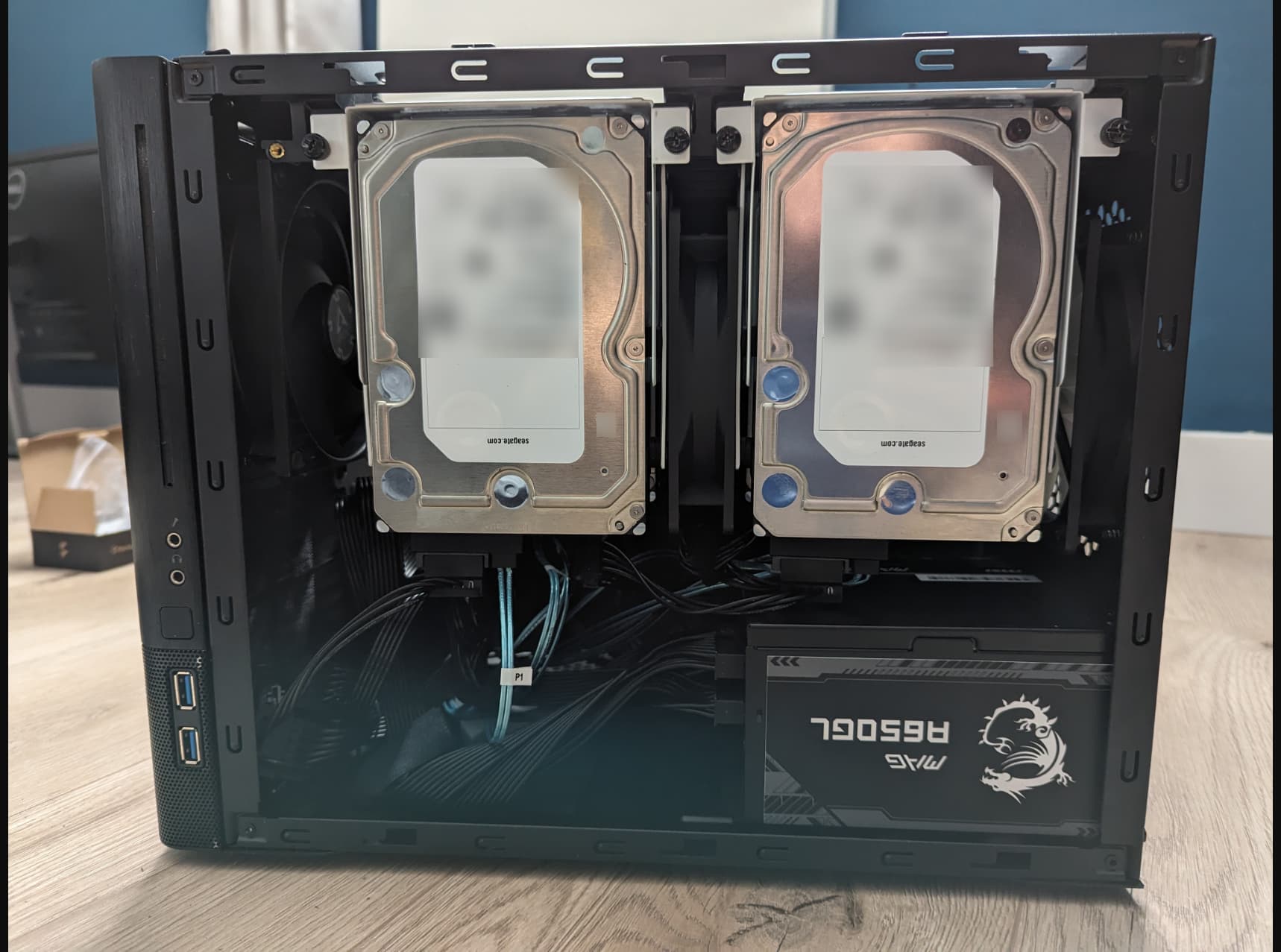

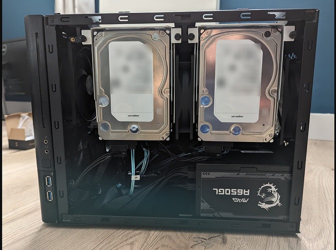

Sas disks in place with modified Sata Power to 3.3v
As a side note, I would like to thank the discord community, that helped me diagnose the issue with the 3.3v.

Looking good so far, nice pictures!
Nice build, looks great!
You are certainly not going to have any airflow issues.
