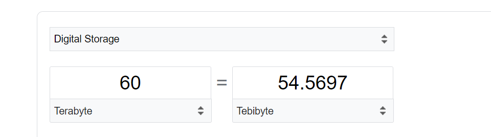

I believe I know where the calculators are getting their estimates from and that is the conversation of TB to Tebibyte.
Something still seems off since I am only 42.8. To me it appears that I am missing about 10 TB of space in my RAID setup. Will this change once I redo the RAID in 5 instead of 6?

You are telling me that out of a manufacture listing a drive as 12TB in size I am actually getting a 10.7TB drive because the OS cannot see all the drive
I’m not saying that. I’m saying that depending on the software what is being reported as “T” might be TiB instead of TB and 12TB = 10.9 TiB.
If that is the case for you, then your 72TB would be 65.3TiB which is pretty close to the 64.2T or 10.7T per disk you are seeing.
The total reported 42.8T is the capacity in your raid after parity is accounted for. You have 6 x 10.7T = 64.2T - 2 x 10.7T (raid6 parity) = 42.8T Usable. Raid5 would net you 53.5T Usable.
