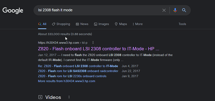

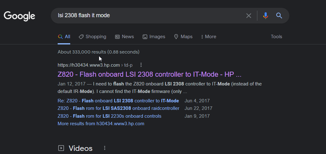

First result on Google.
Edit:
Maybe your search terms were overly specific?
It did not come up for me. Thanks for the help…
