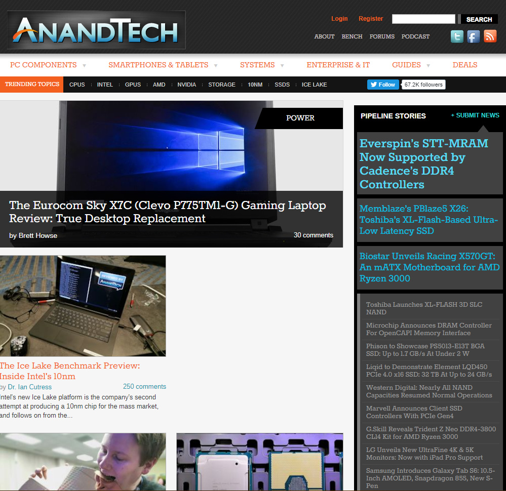

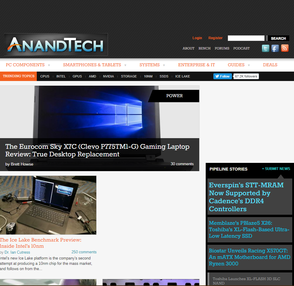

Youâve probably noticed by now, ads that are blocked leave behind the spaces set aside for them. This looks especially bad on some sites, or is just distracting. Hereâs where combining adblock efforts with a browser extension are still particularly useful.
Some Adblock Extensions, like uBlock Origin, have a built in feature called Cosmetic Filtering. This is for rearranging websites with blocked ads to look more natural, as if the ad never existed. It really helps clean up the spaces left behind on most sites.

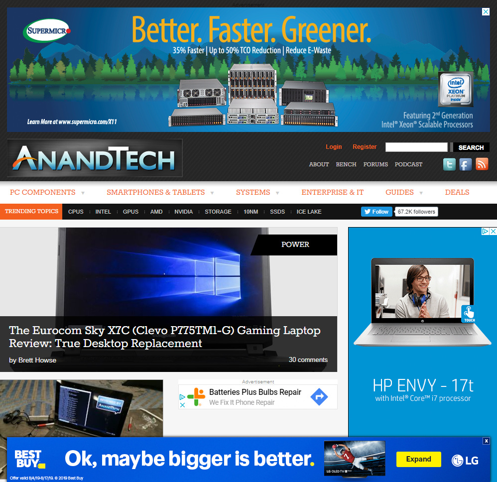

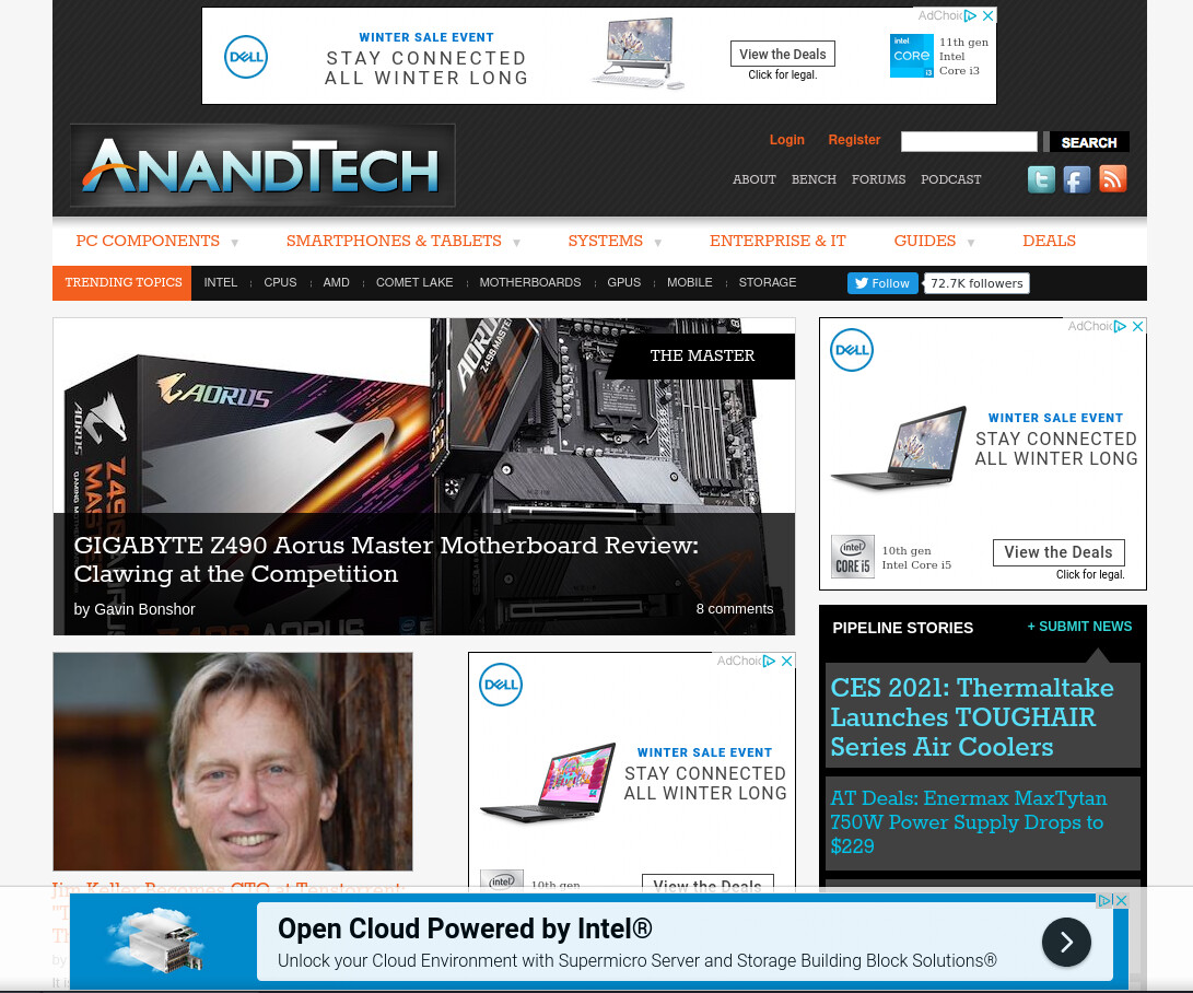

The added benefit here is that pfsense is now tackling the adblock workload, leaving your browser extension free to process cosmetic filtering much faster. Most, if not all ads will never even reach your browser. Here are comparison shots:
tl;dr - Simply install uBlock Origin to make websites pretty again. Have your cake and eat it too.
