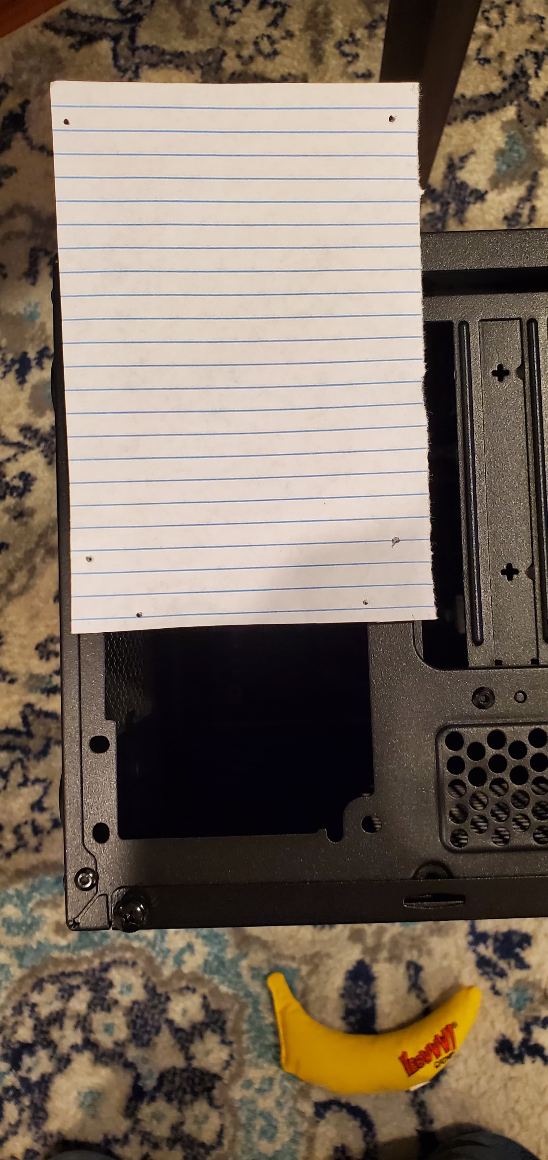

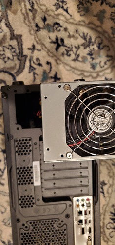

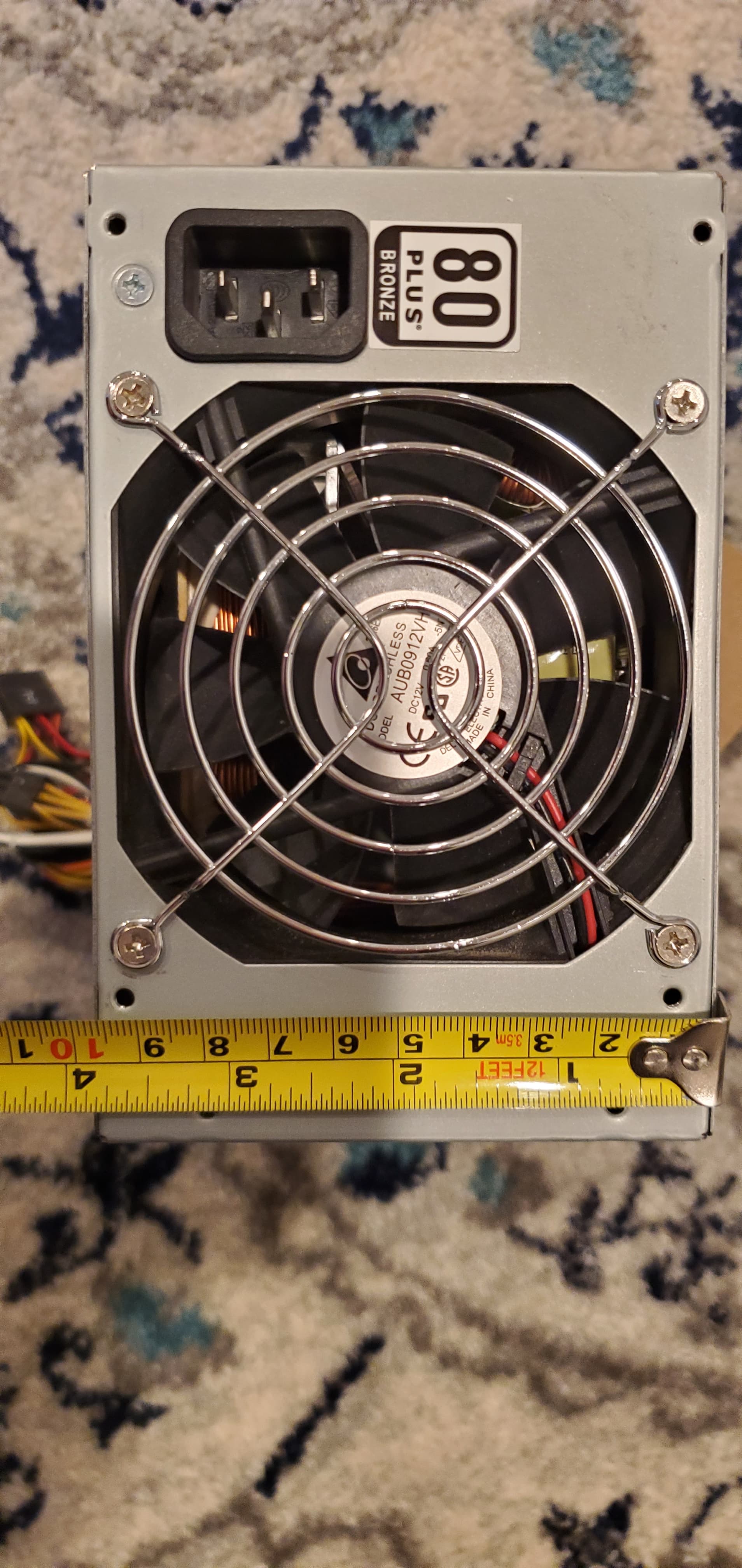

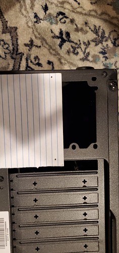

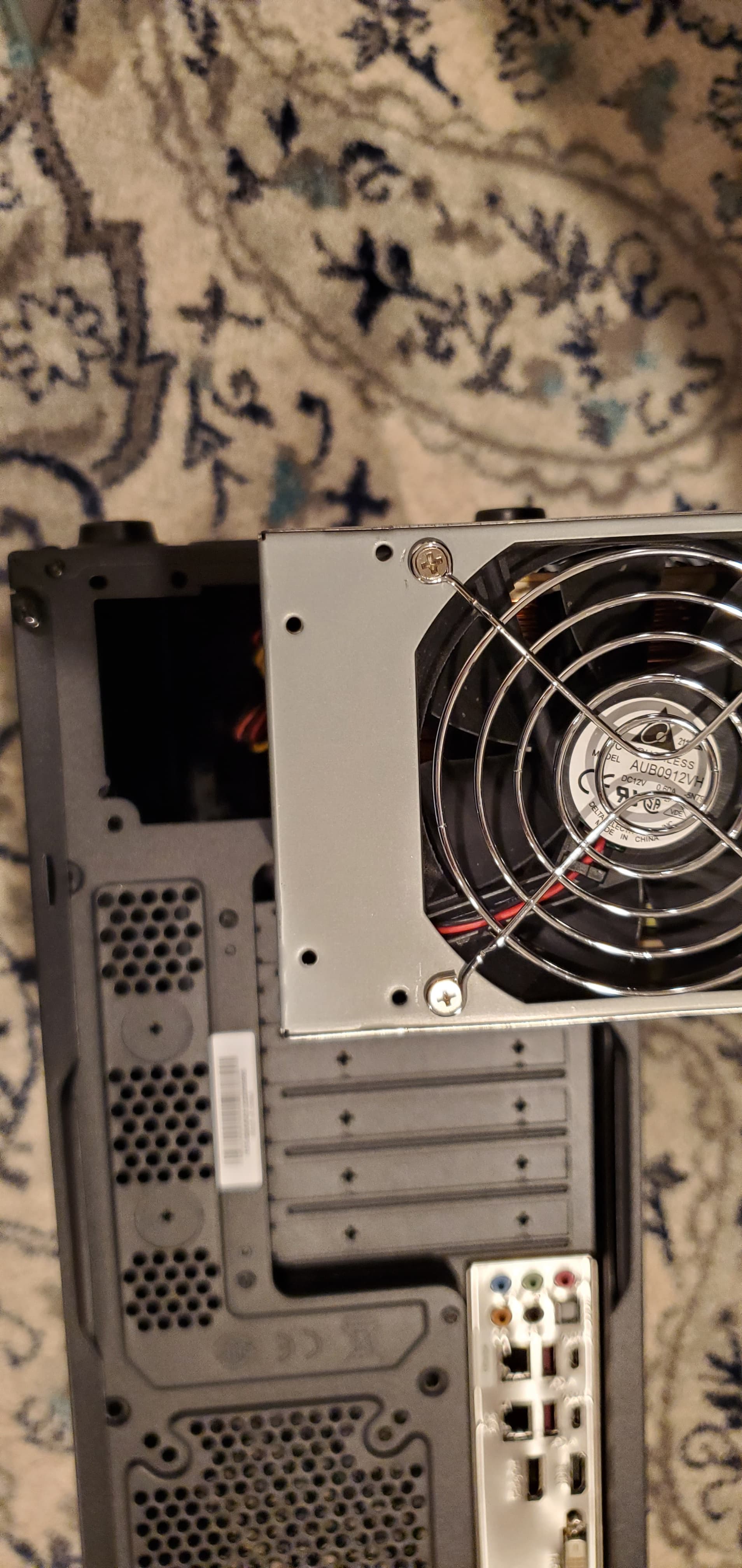

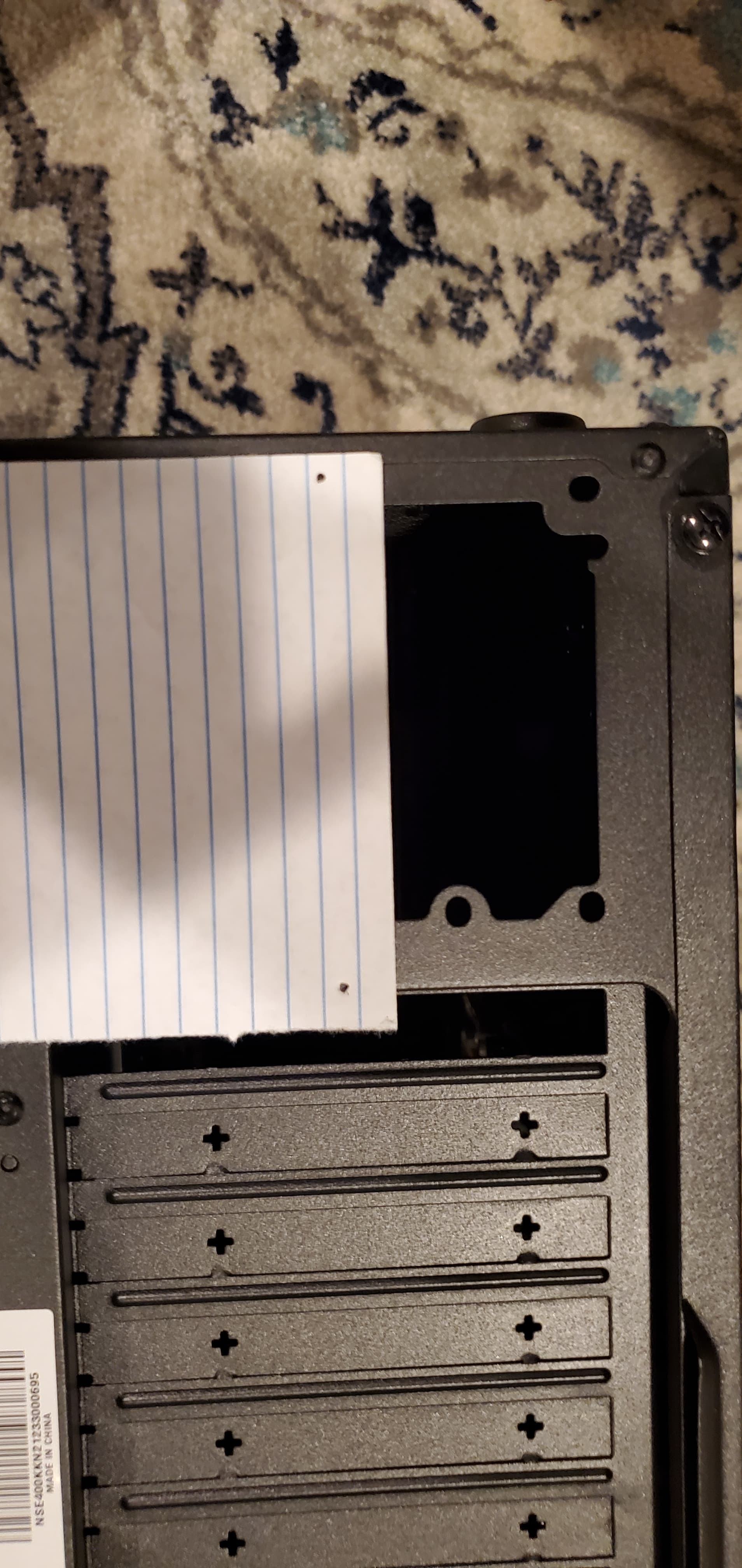

While a typical ATX power supply is 150mm x 86mm x 140mm, this PSU is 150mm x 97mm x 155mm (depth not being a problem in this case). I’ve attached photos of the measurements as well as showing how the hole pattern would line up. You can see that if I align the bottom holes (which they do line up when this PSU sits in the case), the top holes are way too high.
So again, it just don’t fit. It is too tall for the case.
Did you actually build this, @JDM_WAAAT?
If you did, you may have mixed up your PSUs, as it’s not physically possible to get the DPS-475CB in the N400 case. I’d say the right thing to do would be to adjust your guide before someone else like me follows it and ends up with parts that don’t fit together
I’m not very familiar with the Delta DPS-475CB line, but it looks like you may have a proprietary HP version the DPS-475CB-1 A which seems to have been made specifically for HP to run in some specific non-standard HP workstation (Looks like the Z400?). In the image above it has an HP product number.
Delta makes a ton of OEM PSU’s and will customize them for large OEMs. It likely has identical internals but a proprietary form factor (maybe also MB connector who knows).
Can you post a list of links to the parts you bought? This doesn’t look like the part you mentioned.
Could be a mistake on the seller side as well.
It does look slightly taller, and the exact model does show as a possible HP OEM part, which might be non standard. It does, however, look very close to a normal ATX power supply.

@Ian may be on to something here. Here is a link to the part I bought, which does mention it is for the HP Z400. Although mine does not look like the image you provided, @Ian. As for a standard DPS-475CB vs. an HP Z400 specific version, nearly all of the variants on eBay call out the HP Z400 in their description. So if there is a “large” varient that is too big to fit in the N400 case, it seems to be the more popular varient when you click on the link in this article to navigate to the eBay search page
@Destate You are right about the image, on closer inspection it looks like I pulled an image of an unrelated PSU off Google Images. I will take that down so as not to miss-inform future readers of this thread.
In general OEM parts are something of a hazard in the second hand market for enterprise server parts. HP, Dell, IBM, etc will all order special runs of otherwise standard parts like Motherboards, PSUs, Nics, HBAs, etc that have non-standard physical dimensions or special firmware just so that when their customers need replacement parts they are forced to buy them from the OEM at vastly inflated prices for what are really just super cheap parts.
