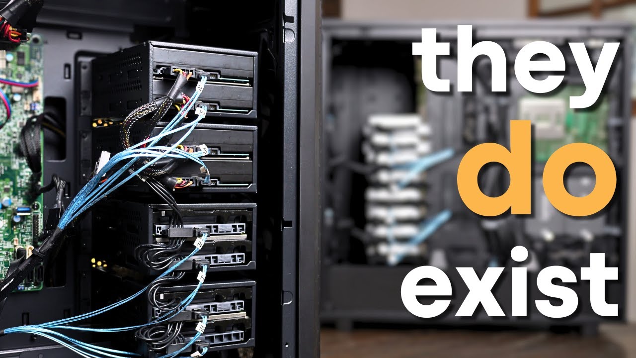

Hardware Haven did a review of this Classico case with mixed results.
The reviews on Amazon are also quite mixed. Many people report that the back of the hard drive cages is almost touching the side panel and doesn’t allow clearance for SAS or straight SATA cables. Even with 90 degree cables it sounds like it is a really tight fit and they have difficulty getting the side panel on. Also a lot of complaints that it is fairly flimsy.
Too bad, I was expecting a little more from Dark Rock, they make quite high quality CPU coolers. Placing the back of the hard drive cages so close to the side panel that you can’t get power and data connectors on seems like quite the oversight on a harddrive-centric case like this.
Kind of funny to see that Video title on Serverbuilds; A site all about building custom NAS builds in mostly desktop cases.
