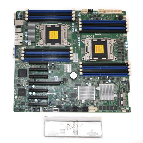

sorta seems like the X9DRD-7LN4F-JBOD is the optimal choice there (if you can deal with the fan issue of the narrow socket), am I missing something?
I’m looking to build a cheap two processor software development machine. The X9DRD-LF looks like it might do the trick:
Pros:
  • really cheap ($72 - I think the price on the spreadsheet is wrong)
  • 8 DIMM slots, so I think I could get 64gb of RAM in in for about $85.
  • two SATA 3.0 ports should suffice for storage, though it would be nice to support PCIe storage
    ** However, there’s one PCIe slot and I’ll need that for graphics
Concerns:
  • narrow sockets: can I cool it quietly for a reasonable price?
    ** this really needs to be a quiet rig
  • funky board size/shape
    ** am I stuck with an EATX case? If so, do I need to add custom standoffs due to the weird shape?
    ** If I tapped my own standoffs in an ATX case would that work?
  • Am I correct in thinking that a video card like a EVGA GeForce GT 710 would fit in the single x16 PCI-E slot?
    ** (pardon my ignorance re: graphic card slot compabitlity)
I’d appreciate it if folks could set me straight on some of my concerns and point out any pitfalls I might be missing.
Thanks!
Regarding water cooling: I’m not an overclocker and don’t know anyting about this. Is it likely to be quieter for narrow ILM set-ups that the standard coolers listed? If so, is this a price competitive alternative to the conventional narrow ILM coolers if you want a fairly quiet build?
BTW, thanks for all the hard work that went into this guide! The guide is impressive and very helpful.
@samcramer that sounds more like a game machine than a software development machine… For most software development you just need a couple cores (1 cpu) or a vm on a mb with onboard graphics. I built a server for cluster / vm deployments with the x8drd-lf it’s an ok mb for that task if you plan to add an LSI, but that single slot with only two satas is a big limitation for something you want to use as a development machine with a graphics card. Thus why this board is so cheap. If you have a separate desktop just ssh to the server and good to go no need for fancy graphics on a server.
@mikebrow, I see why you would think that, but believe me, it’s a software development machine. The build system (bazel) does a great job of firing up lots of compiles in parallel and touching one include file can cause a lot of files to be recompiled. Thus, the more cores the better. The same holds for RAM.
The graphics card is for driving a 4K monitor on which I edit code, because when it comes to editing source code, the more real estate, the better. I don’t game at all, and the tools I use are all text-oriented, not graphics oriented. There are no rendering-intensive tools involved. Think Emacs, not Eclipse, and kernel programming, not graphics coding.
In this particular application, ssh’ing into a build server isn’t convenient because the directories on these servers (which I don’t control) aren’t NFS-exported and so synchronizing the source between the personal editing/dev machine and the build machine can be a pain. Also, the target is an embedded processor which is connected to the dev machine directly, so an editing/dev machine / build server division of labor is sub-optimal.
I have looked into my mobo options some more, and I’m starting to think that X9DR3-LN4F+ might be a good choice. It seems to me that the single PCI-E slot on the X9DRD-LF is probably a deal-breaker.
