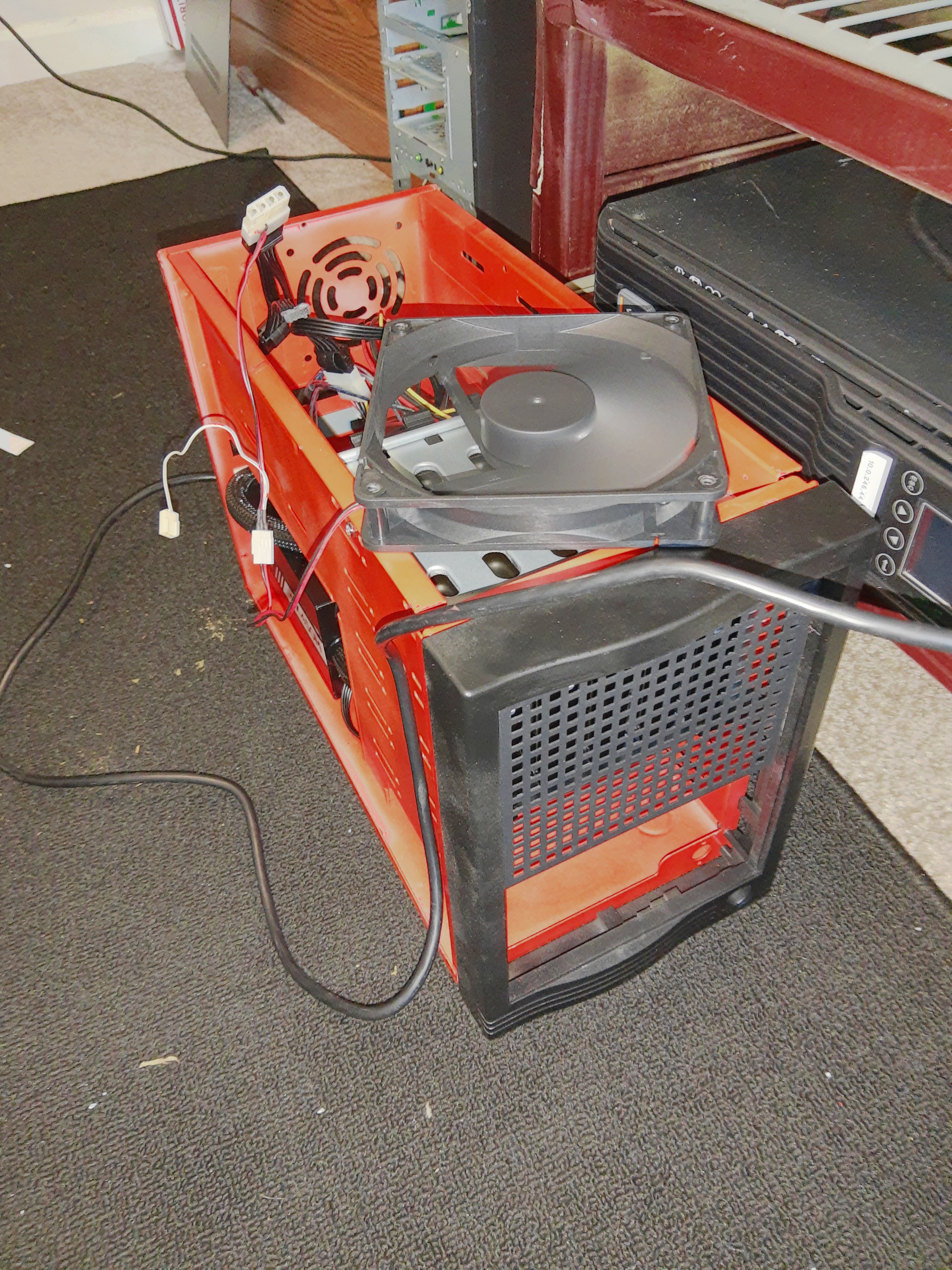

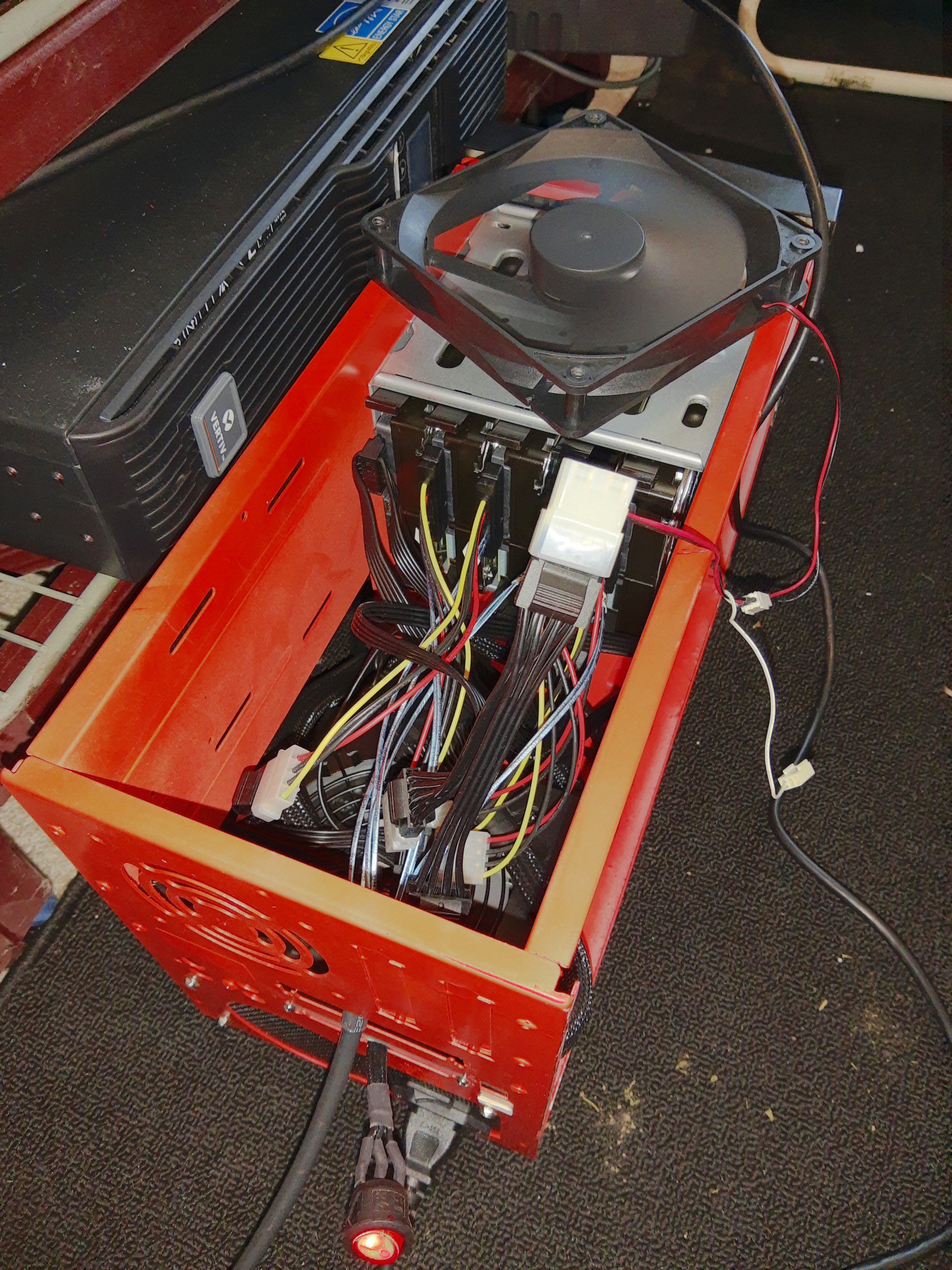

Still waiting on some parts to come in but I’ve got this built and waiting on the lower portion to come in which will house some 2.5 inch drives
I took it to mean it took up (5) 5.25" bays but it only takes up 3 so I ended up ordering this which I believe will work on ok.
https://www.amazon.com/gp/product/B016O036FK/ref=ppx_yo_dt_b_asin_title_o01_s00?ie=UTF8&psc=1
Also have some cheap fans coming…I can already tell running 5 hdd’s in that banggood cage is gonna produce some heat.
That cage fits 120mm fans in the front…
Yeah I got it…the fan I have on top right now is 135mm. It’s from a old power supply so I guess that’s the reason for it being a odd ball size.
