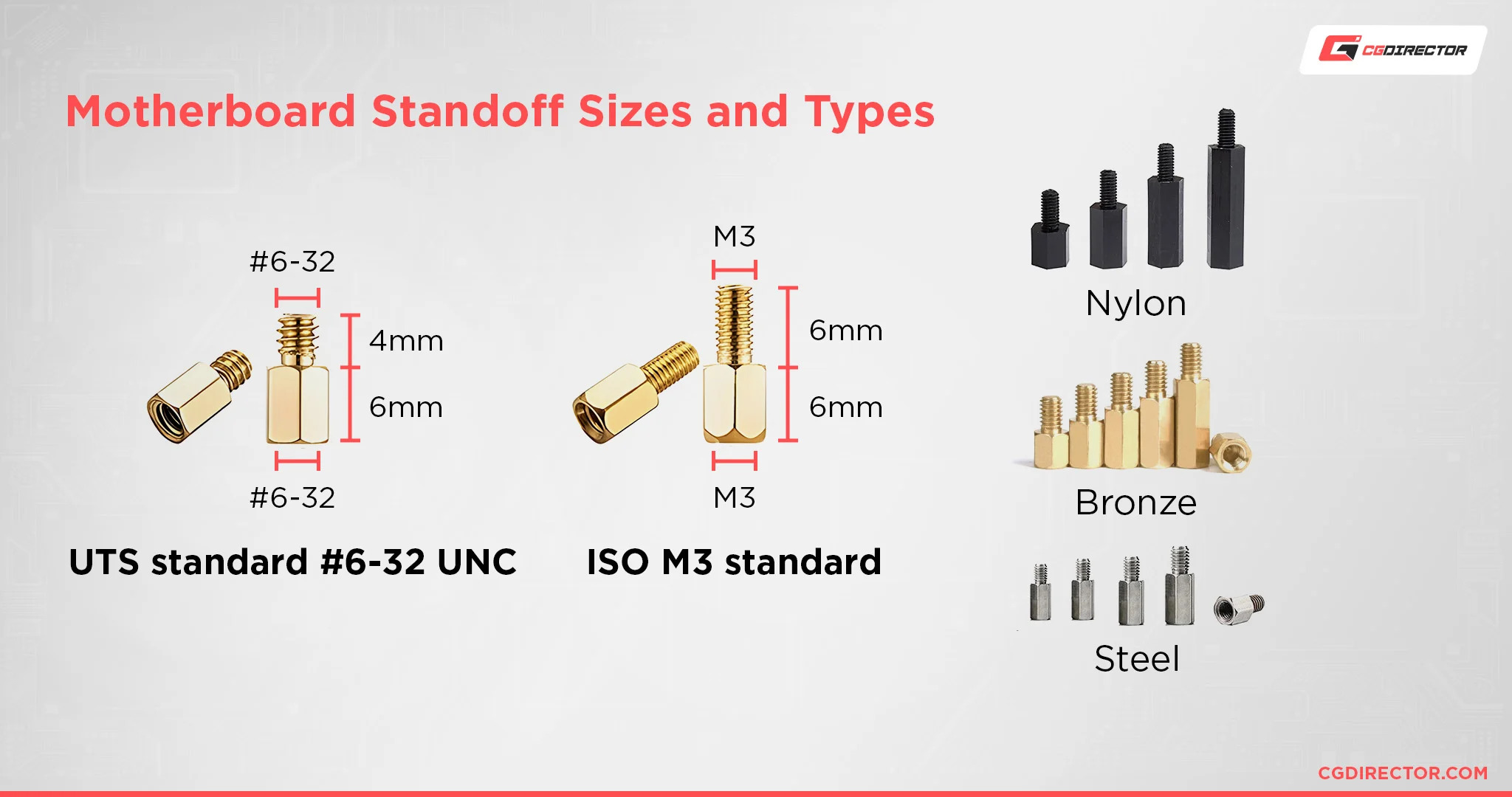

I always thought that standoffs were pretty universal, but a quick google search shows that there are at least two different types:
I’d guess that whatever you bought from Amazon were “the other thread size”.
This is exactly right. 6-32 vs M3 is super confusing; they are very similar but do not mate. 6-32 is 3.51mm thread diameter, so half a mm larger than M3. So a 6-32 screw will not fit into an M3 standoff, and an M3 screw will fit into a 6-32 standoff but will pull right out, feeling like stripped threads. There is not standard for standoffs, but both 6-32 and M3 are used, with 6-32 being slightly more popular. This appears to be the case for your Node 304.
