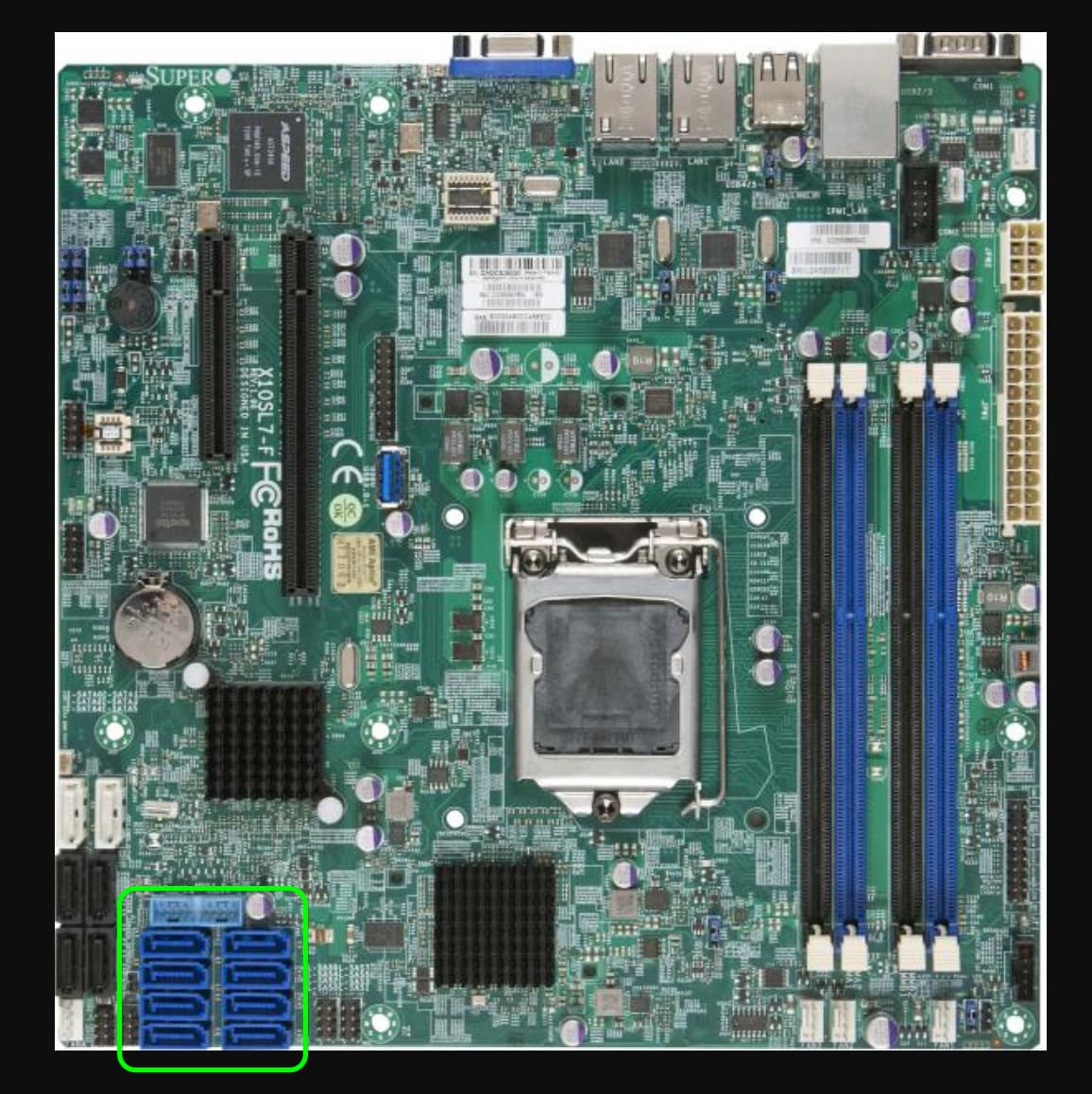

The SAS2 uses SATA ports on this board so I guess this means I’m limited to SATA drives for these ports?

These are your SAS ports. They are physically SATA, but you can use reverse breakout cables if you have a backplane or you can use these cables if you want to directly connect to SAS drives. You can also use these adapters with SATA cables.

Great. Thank you for the info on the ports and cabling. I’ll keep looking into the drive options for cache and apps as that would be the likely use for SAS connectors in the short term. From what I understand the HDD drive speed and my 1GB internet are more likely bottlenecks than the SAS vs SATA cabling.
