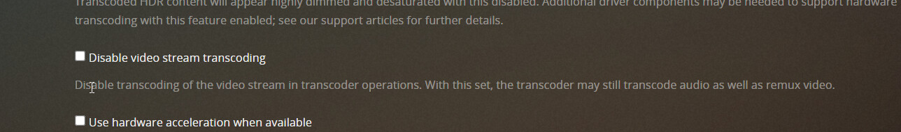

Plex Server >> Settings >> Transcoder.
Is this what you were looking for?
