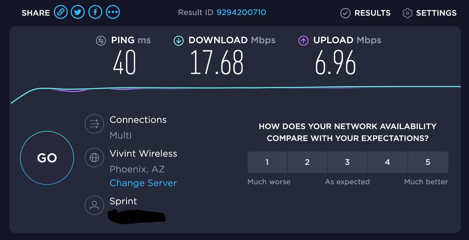

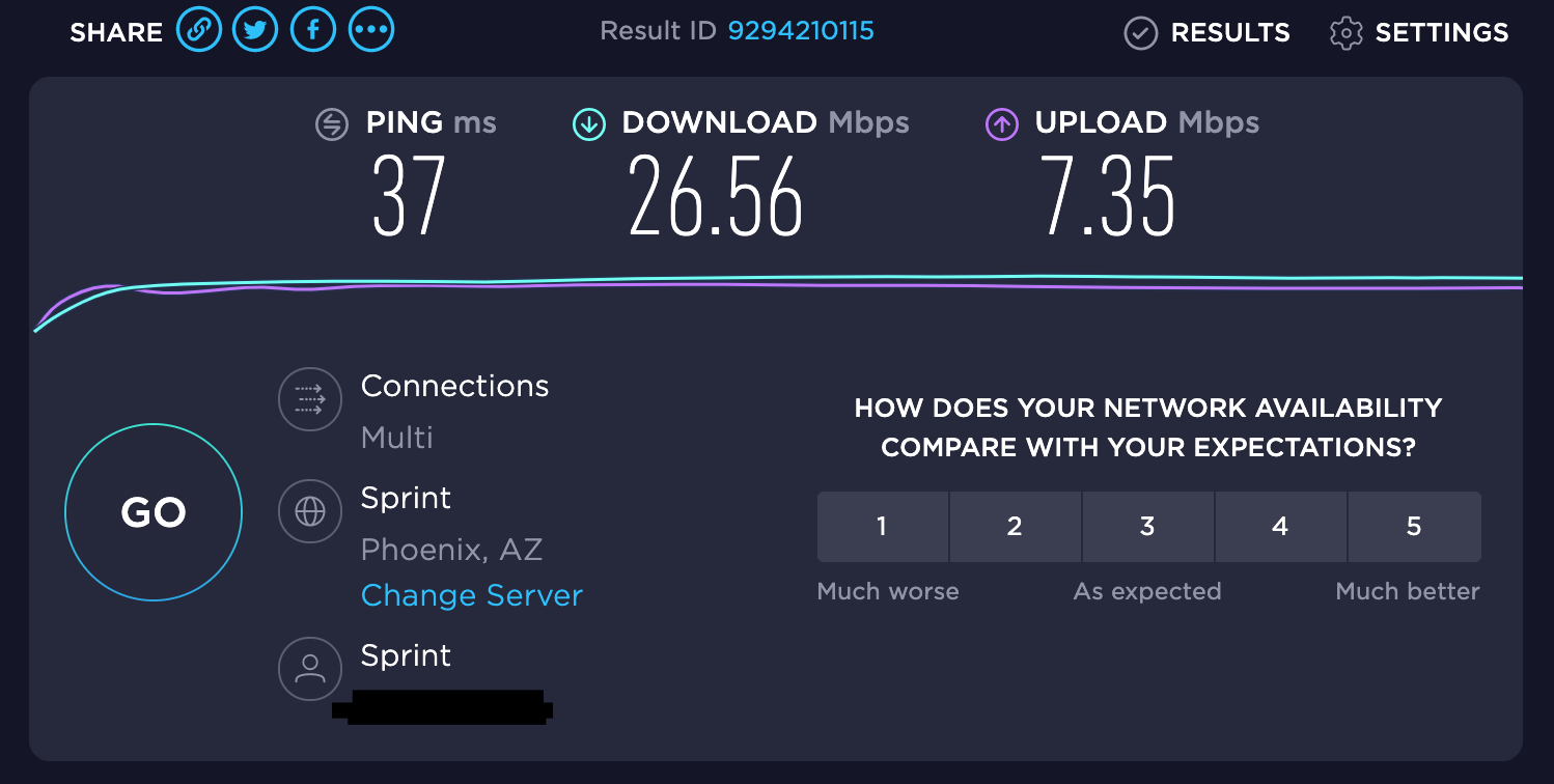

On the road in the middle of nowhere in Nebraska, traveling at about 65 MPH.
On 76 outside of Sterling, CO still at about 65 MPH

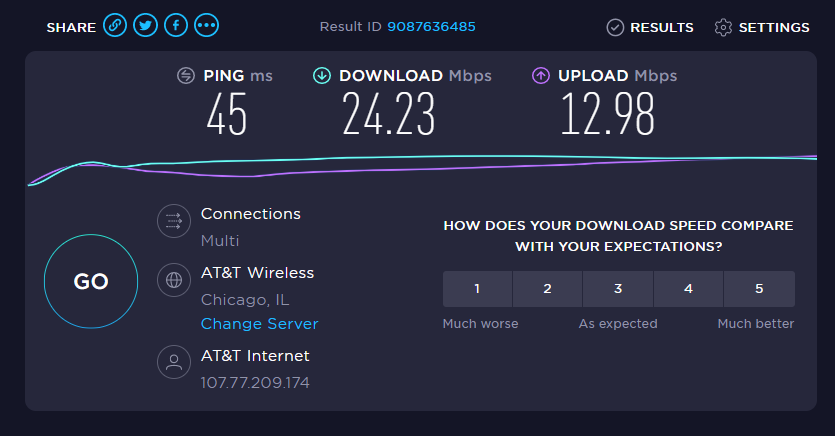

I live out in the middle of rural nowhere in the NE us. I used a Mofi 4g router and am able to get 80mbit down 60mbit up, I pay 35$/mo using AT&T. You can use external antennas and its great but the default upgraded paddle style ones are great for me, even going through a wall. AT&T has a hidden unlimited wifi plan if you use an ‘ipad’ sim card, which means spoofing an IMEI when u sign up. I get better latency than my copper 6mbit/0.3mbit connection for gaming.

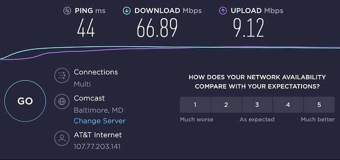

I have had much better connection speeds in the past, however for basically free internet (it was a full write-off via taxes) it’s great for me! I get around 6.5-9MB/s on downloads. But I finally got around to publishing a “worst case” at home speed test; please also consider these speeds during covid-19 which have been slower.
Here’s the test via ethernet (wifi-bridge)
Here’s the test directly connected to the MiFi puck:
I have gotten consistent speeds at around 65Mbps before this pandemic, so yeah, not bad for basically free.
