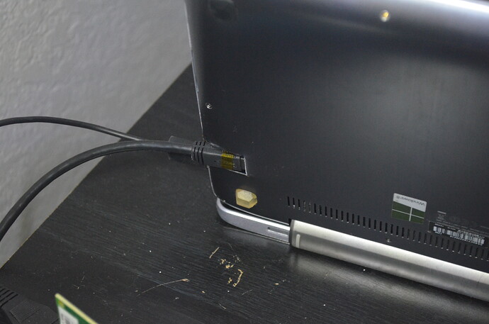

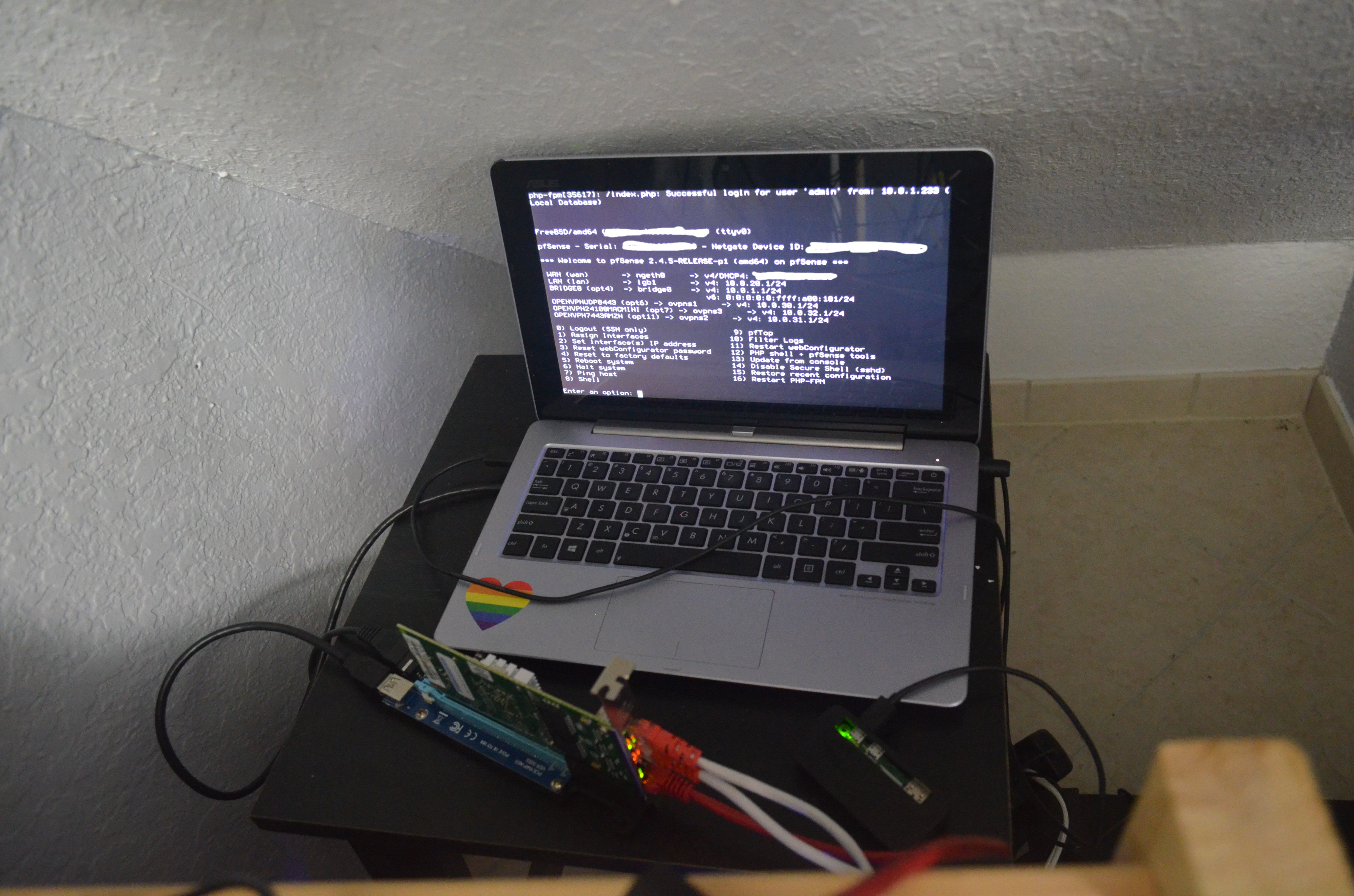

I have done this exact thing with an old ASUS Transformer Book Trio TX201LA 2-in1 laptop with Android Tablet and my specific build was to avoid using the USB dongles. The Tablet portion stopped working; however but the laptop portion works fine. It has an i5 4200U (with AES-NI), 4GB soldered RAM and I added a super cheap 32GB SATA SSD to run pfsense on. We have AT&T 1G FTTH and for everything we have running at home: 5 PCs, 40 wireless devices to include some additional IoT devices, running two simultaneous OpenVPN connections plus all of our HTPC, NAS, etc services on the back end - it is overkill and doesn’t even break a sweat.
For the build, I pulled off the laptop bottom and removed the pcie wifi card and installed a minipcie to pcie x16 riser kits off ebay for < $10 and an external molex power supply for <$15. I had to use some metal snips to cut a notch in the bottom panel of the laptop that was big enough to run the cable from the laptop to the x16 riser board and still be able to button the panel back up. The cable was taped down to the motherboard using some Kapton tape to help prevent it coming unplugged. The NIC was mounted in a 3d printed riser mount (linked below) to add stability and also keep the NIC firmly seated in the riser. The card was recognized immediately and had no special configuration or drivers to be loaded required. I am specifically using a quad port card because I am using MonkWho’s pfatt bypass available on hit github. This enables a true bridge mode setup with AT&T U-Verse and pfSense but requires a separate ethernet connection on the pfsense box bringing the total up to three - LAN, WAN and pfatt bypass. So even though this quad port card (pcie 2.0) is connected via a pci-e 3.0 x1 slot, the x1 slot running at pcie 2.0 provides more than enough bandwidth for this setup. Theoretically, a pcie 2.0 x1 slot should provide 500MB/s in each direction far exceeding the AT&T gigabit connection bandwidth.
