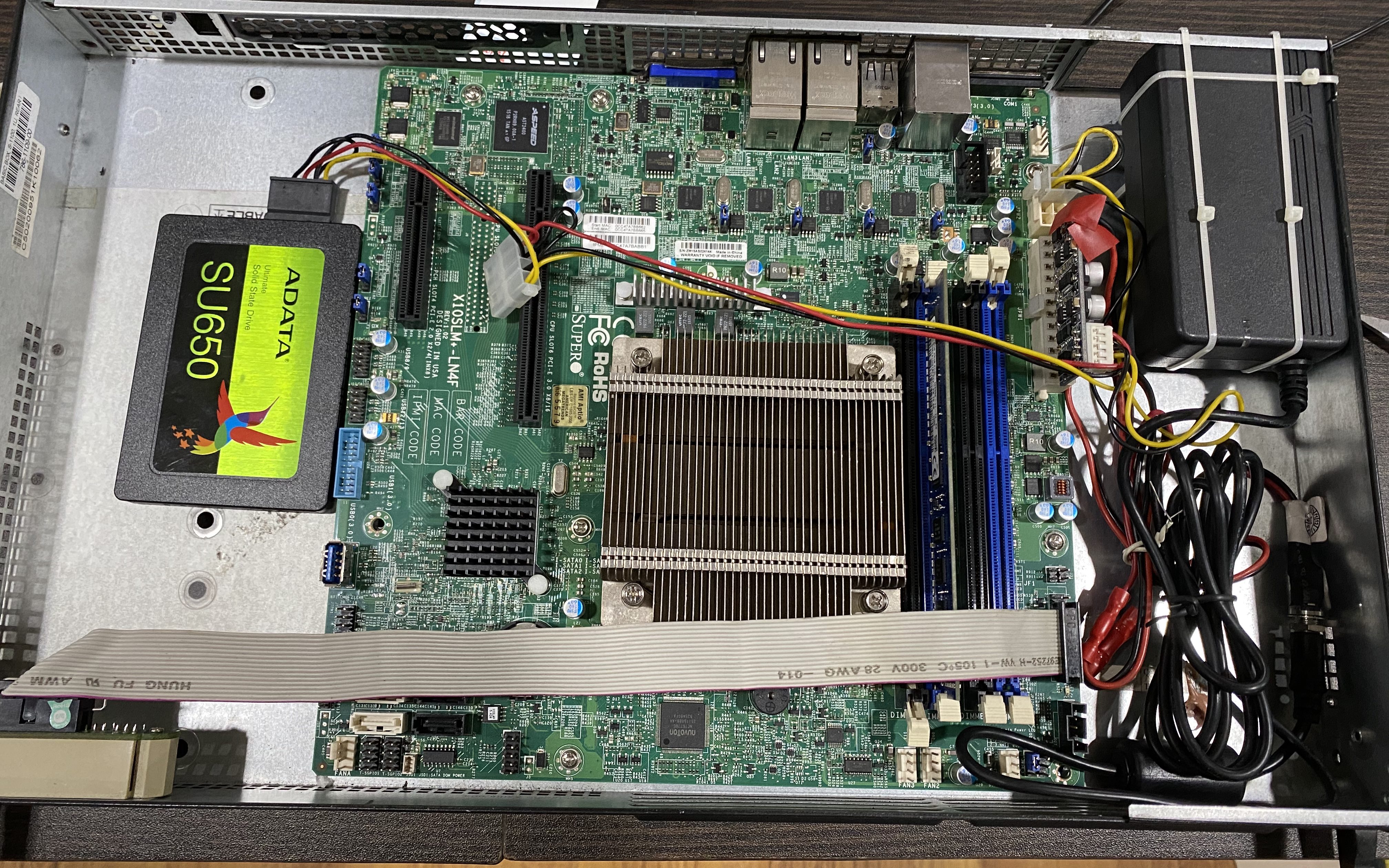

Using this case- SC502-200B | 1U | Chassis | Products | Super Micro Computer, Inc. from another appliance. I took out the mini-itx M/B and placed this micro-atx one.
Used Pico PSU and this 12V adapter, to lessen noise. Fanless :D. Took out my low profile fan, and put in this Supermicro heatsink. Hope it’s enough to cool my 35W processor.
I can tell you 30 minutes after, my motherboard started to beep overheat. Now, I don’t know where to put a noctua fan, in front of the heatsink, or at the back to pull hot air out. Not sure if it will even fit. I have a Noctua 40mm fan.
With that current setup, you need an active CPU cooler. It won’t be quiet though…

I have another brand. Dynatron K199 1U Server CPU Fan For Intel Xeon LGA1156 CPU, not very loud. Yet, I keep coming back to wanting all passive. I don’t mind underclocking, as my firewall have way too much power than what I need. But at 35WTDP, I didn’t expect it to hit higher than 80 with this current setup. My M/B alarms for 1 minute, then goes silent once more.
There’s nothing like dead silent equipment in the room :D. Please show me how to underclock. Can you still do that with Core i3-4160T?
My ultimate goal is to go dead silent. So the 1u psu I have is quite silent for 1u standards already. but I can tell you you can definitely hear it in the room. Now at this current state, it’s working, and yet, no sound at all. I can only see the leds of the Supermicro flashing left and right :D. Looks so cool. Except for the occasional red led lighting up and beeping 1x a day or so for 1 minute :D. There has got to be a solution.

:D. Still looking for ways to underclock processor. There is another option, currently experimenting. As I don’t have space on the front or back of the M/B already, I placed a Noctua 40mm fan on the back left side of the 1U chassis. It’s currently under experiment. Sound is pretty quiet, almost silent. It also just brings down the temp 2-3 degrees of the processor. Not sure if it’s any help. I’d like to have it even lower, maybe 60 degrees Celsius.
