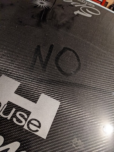

Body-
MPH Fabrication Carbon Fiber Roof Skin
-Wood front underbody aero
