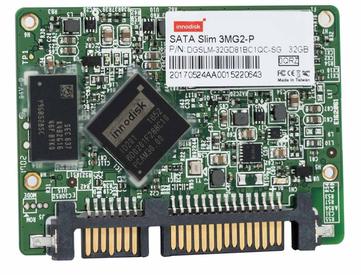

Late night trolling for enterprise ssd’s, I found this slim sata ssd. It probably would work using the connector of the dvd drive in the S01 and 290 to give additional storage to the m.2 and sata.
The optical power uses a different connector, so you’d need to get an adapter to use an SSD, even one of these slim ones.
Ah, good point. Forgot about the other end being a goofy 8-pin connector
What’s the point of that over a normal 2.5" SSD?
Thanks for the response. This is something that I’d be interested in setting up. Do you or others have any recommendations on a DAS that isn’t too over the top and fairly minimal? Ideally I would only need 6-8 bays.
I’m looking, thinking: 2.5" ssd requires regular sata and power connector. The slim dvd cable on the290 is… slim, not regular sata. Few of us need the slim optical drive, why not replace it with a slim ssd and use the connector/space/ability?
Why not just get an adapter for 2.5" SSDs then?
https://amzn.to/2VGFc7G
My confusion. I didn’t do a pin count on that posted SSD. The “Slim Sata” threw me off thinking it was actually “slim sata” and not “slim, sata.” Because you’re right, it’s the regular pin sata, requiring this if you use the cable from HP
https://www.amazon.com/dp/B01ESJLE08
I can confirm that this works. There is a bigger 12.7mm size that will not fit. Any of these 9.5mm ones will (there are tons on Amazon/eBay)
