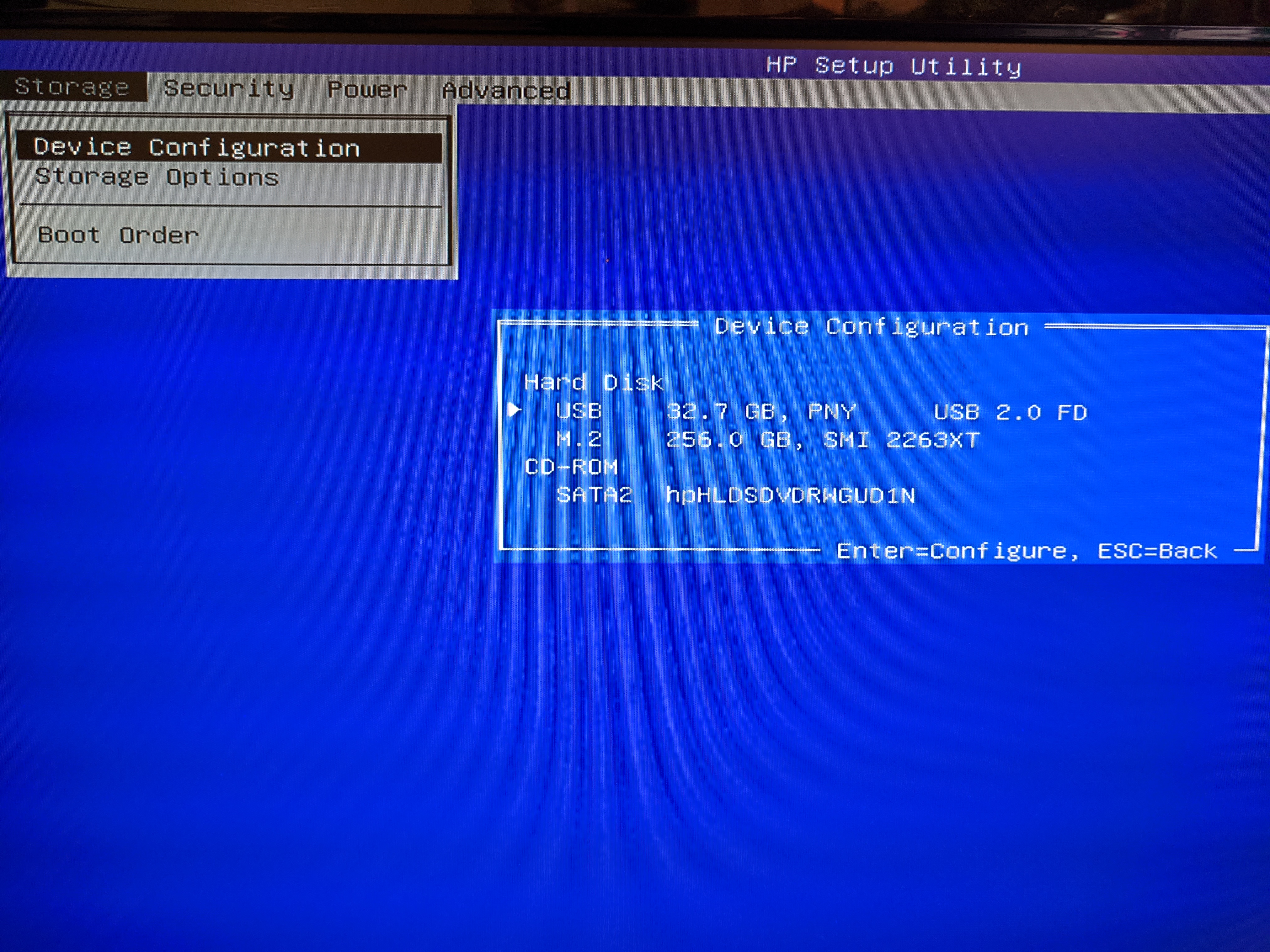

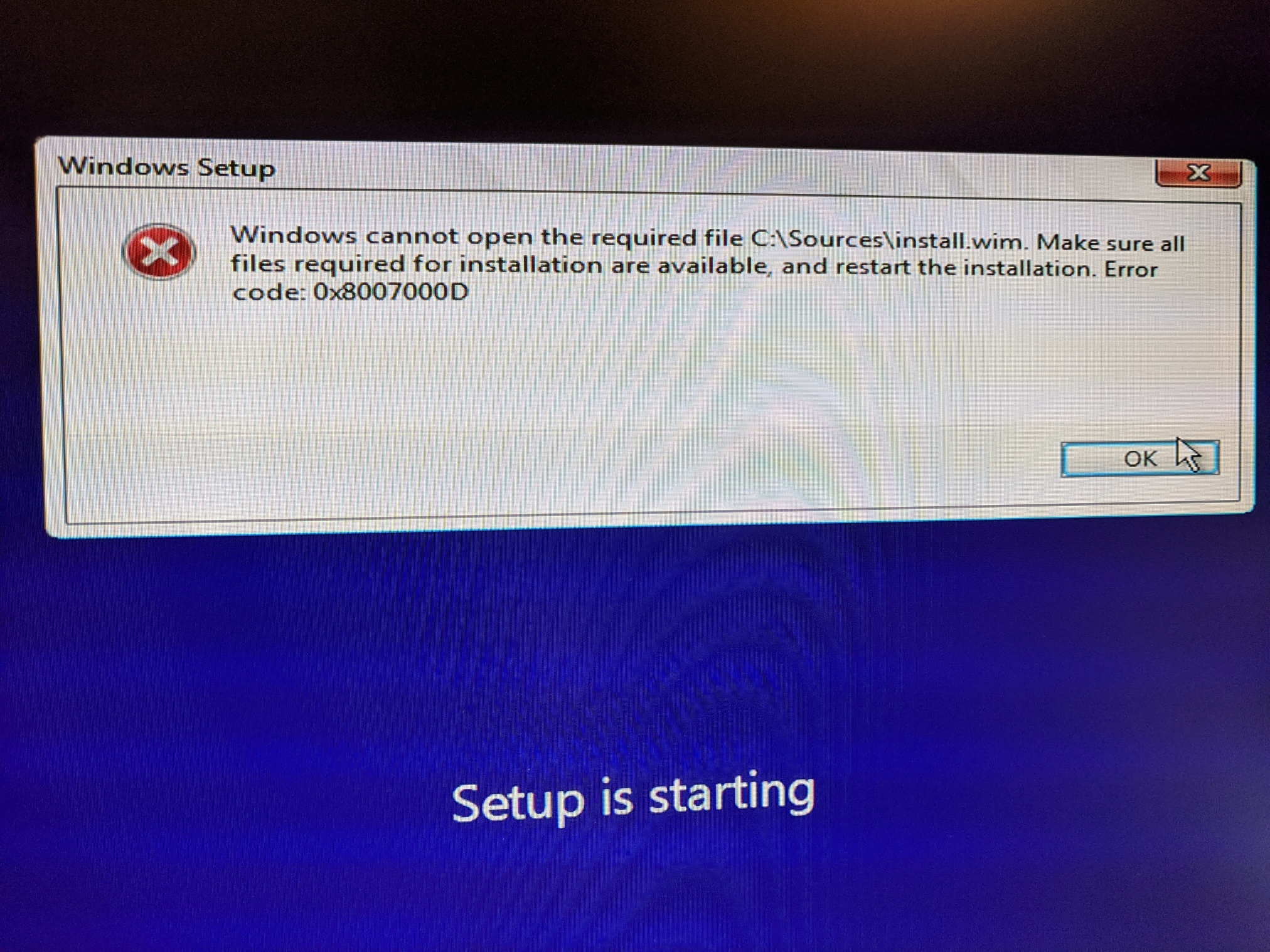

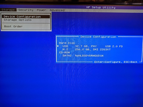

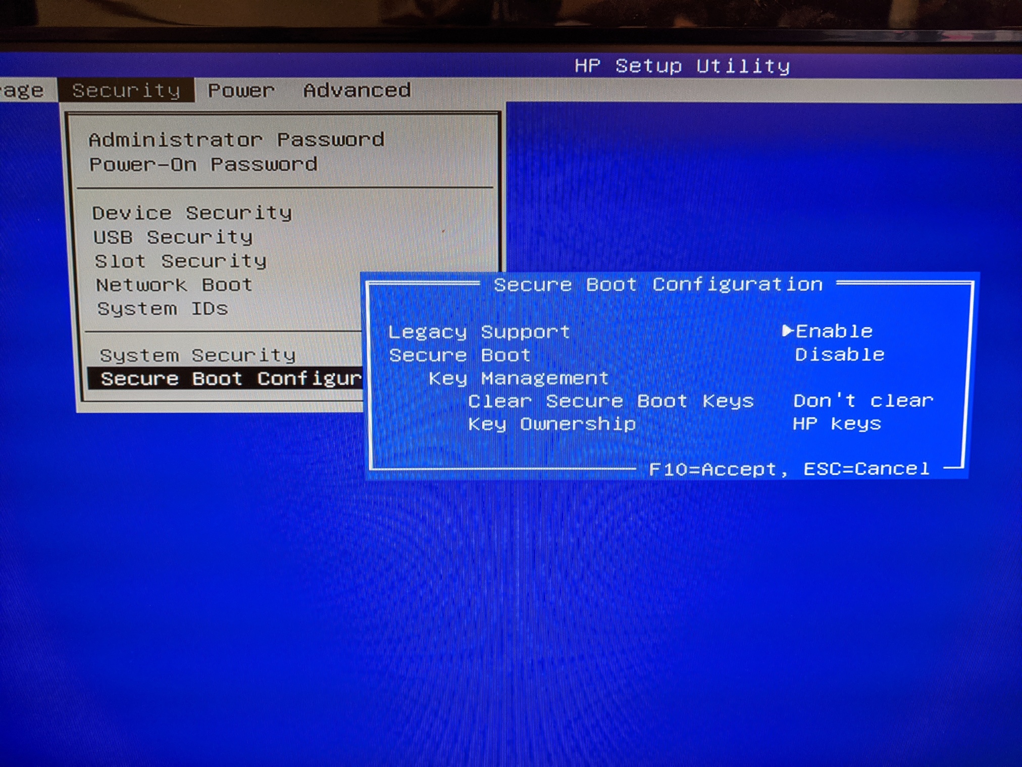

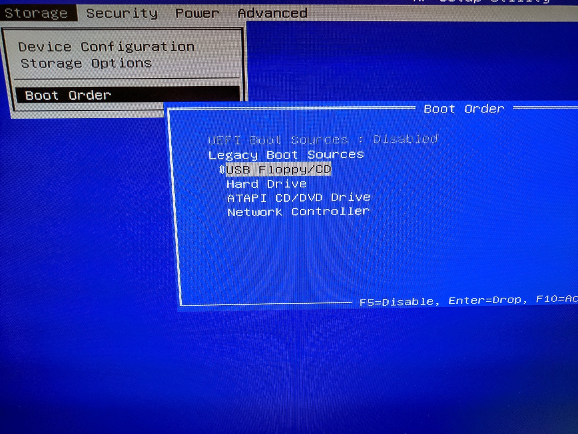

I removed the 500gb HD and installed a 256GB NVME drive. I disabled secure boot and UEFI boot sources as shown in the attached pix. When I try to install Windows from the thumb drive, setup says “Windows can not open the required C:\Sources\install.win.”
Any clues for the clueless? Could this be because I created the thumb drive using “unetbootin”
on Linux rather than running the media creation tool on Windows? Do I need to have the original drive connected in order to install onto the NVME drive?
Rufus should work but you’ll need to use it on a windows machine. I’ve never had much luck with unetbootin. Otherwise it’s probably best to use the media creation tool.
I would also pay attention to where you place the usb flash drive. Avoid usb 3.0 ports…some devices prefer the upper left most port on the rear panel.
There is no reason to turn off UEFI and revert to legacy to install Win10. No need to disable secure boot. Change the UEFI boot order to put USB devices over OS Boot Manager and you are good to go. No need to download an iso and create a bootable device afterwards, just use the Windows Media Creation tool, it downloads and creates the bootable drive all at once: Download Windows 10
Thanks – I’m running the media creation tool now.
OK, good to know. As I recall, the devices listed in the UEFI list had odd names (including something like “boot manager”) and that “boot manager” would always be entered and then complain. I know next to nothing about UEFI, so it’s quite possible I misunderstood the entries displayed.
