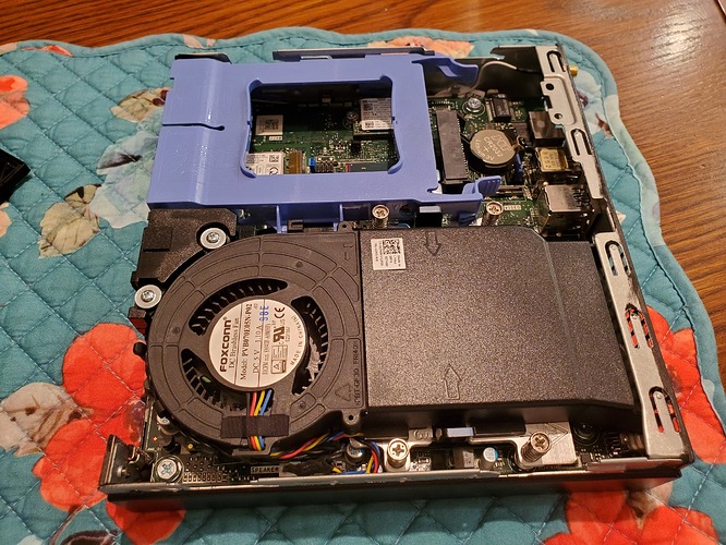

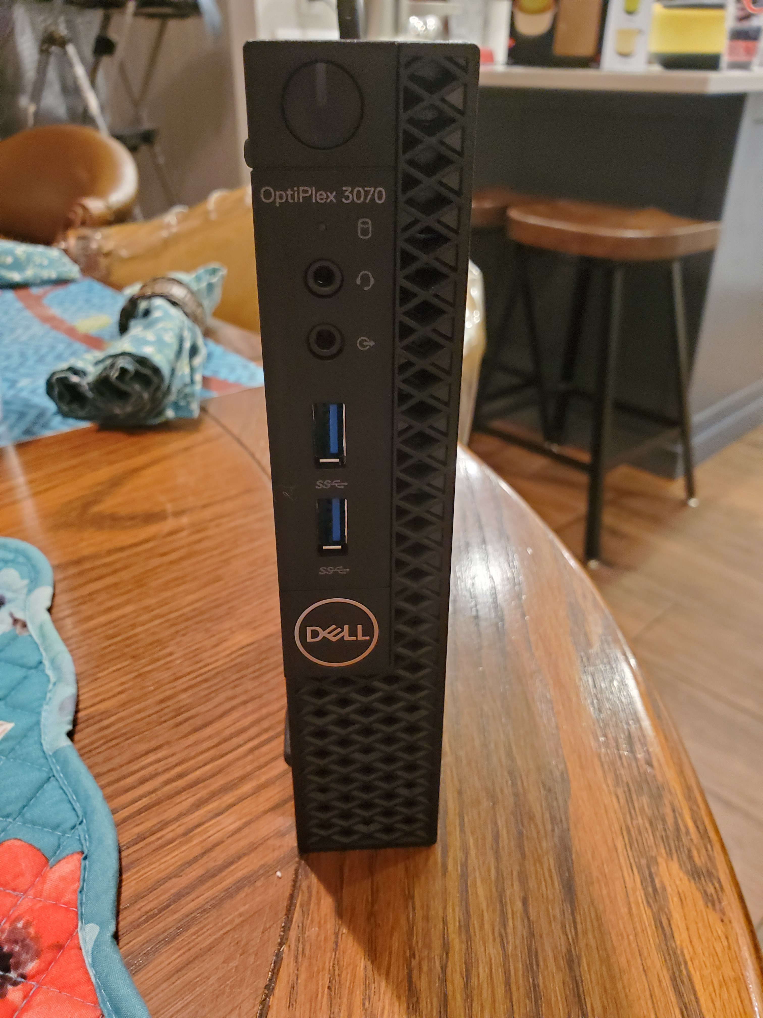

My Otis solution now that the 290s have jumped in price is a Dell optiplex 3070 micro off ebay.
I5-8400t, 35w
8gb ram
512gb nvme
Micro chasis
$250 plus tax
I think this was a much better deal than piecing it all together. Yes, more expensive than where the 290s were at, but its also smaller, only 35w, has more cores and threads, has a better gpu, and I don’t have to stick more ram or a better HD into it.
